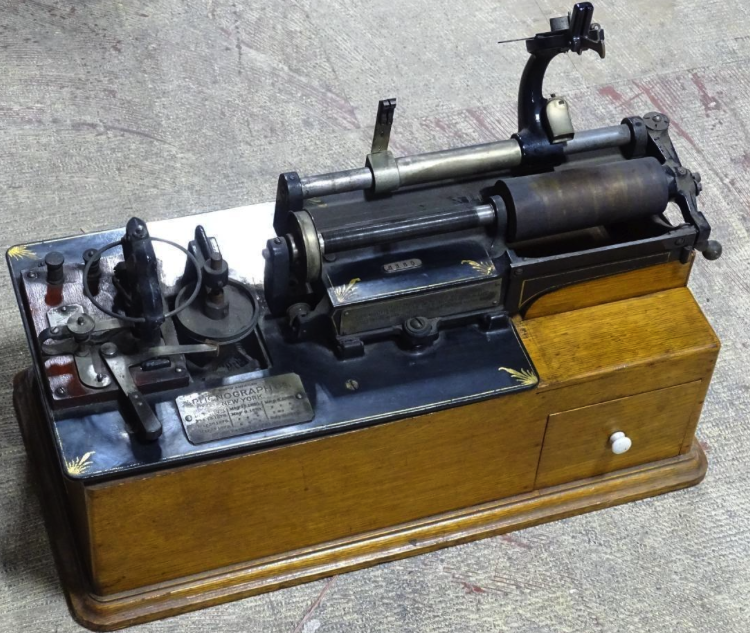

Here is a picture, before it disappears.
