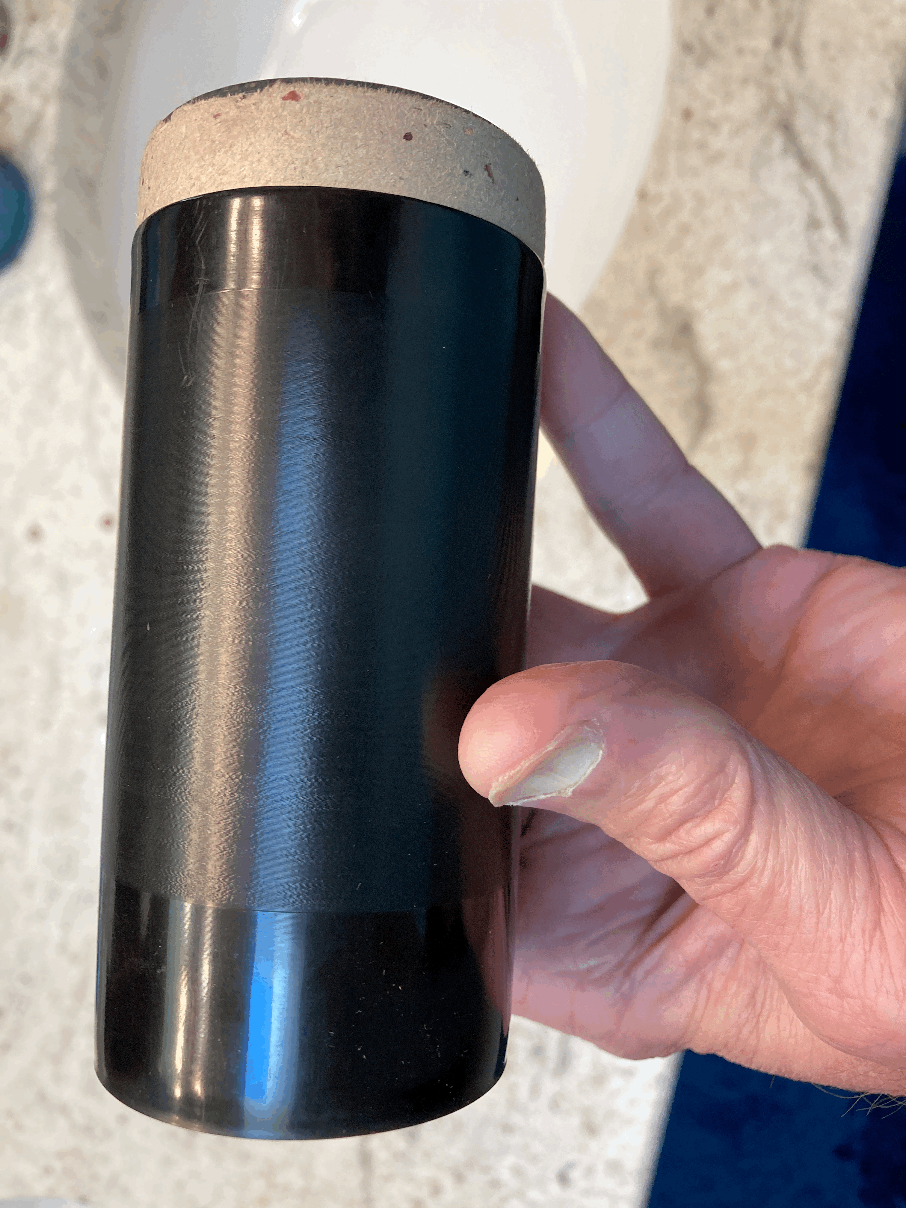

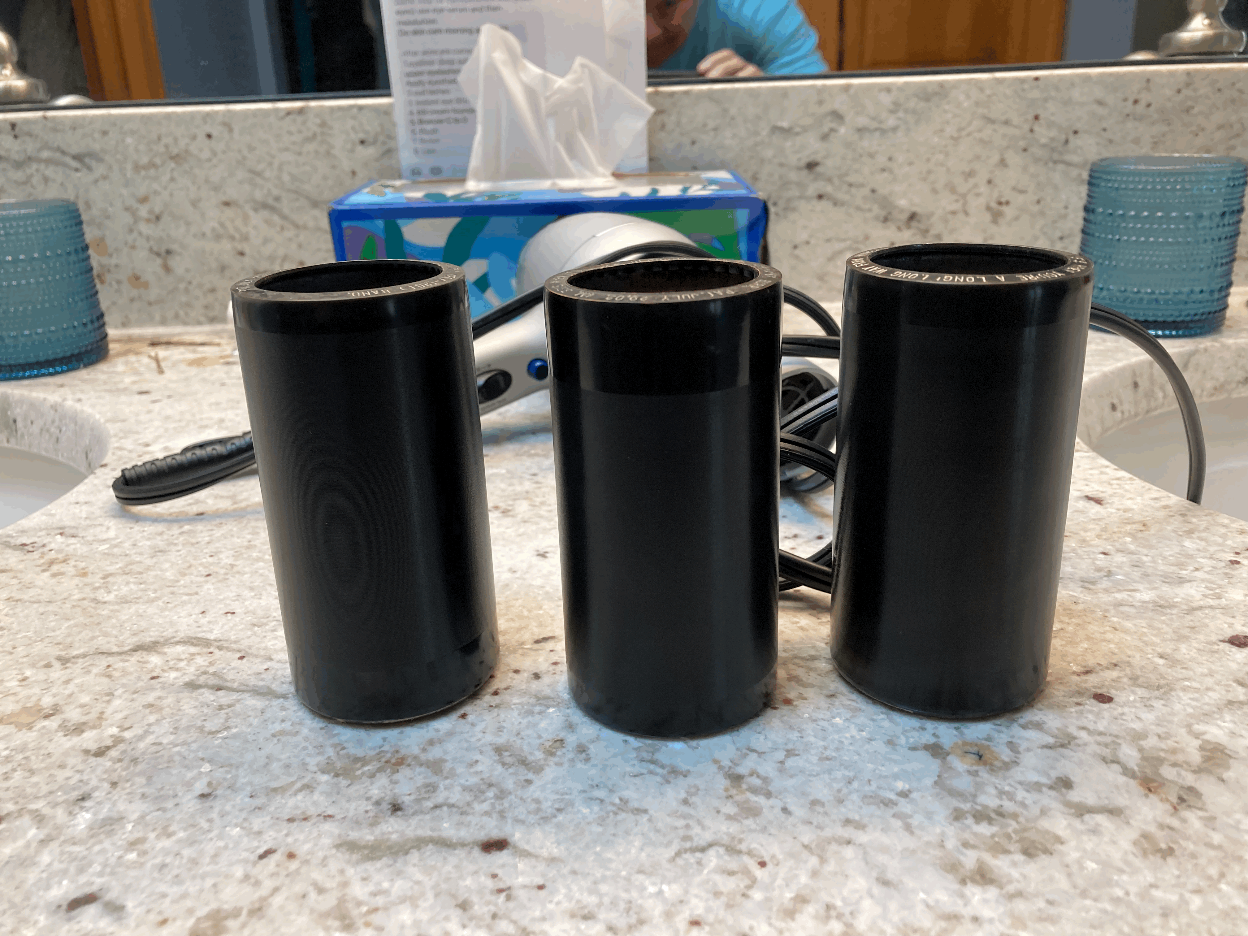

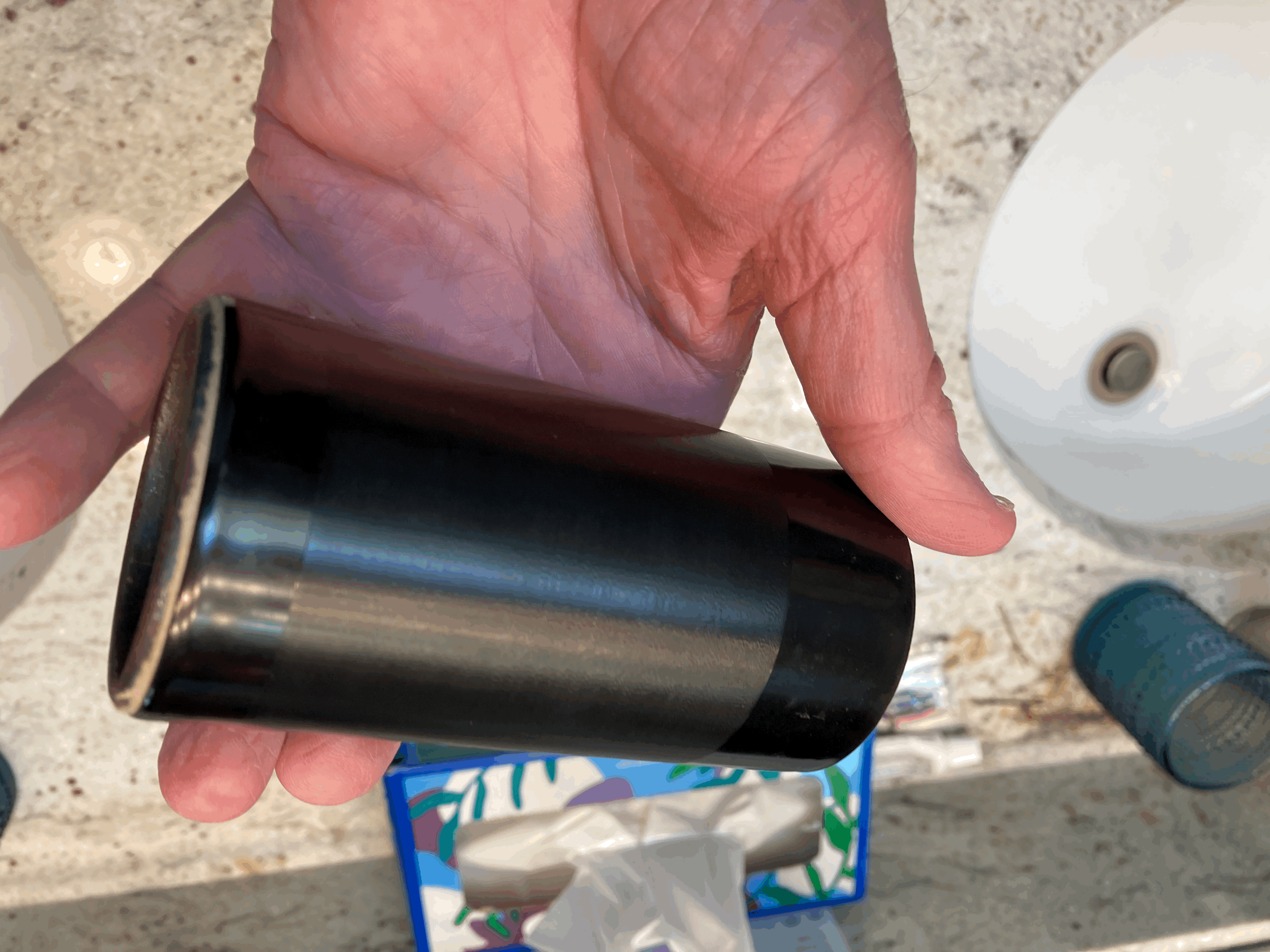

Those that know me will understand when I say it's been many many decades since I've needed a hair dryer. Today I needed and used one! I bought a project machine that came with a nice selection of cylinders including several that had shrunk quite a distance off the cardboard core. I sat them to one side thinking I'd have to toss them out. But before tossing my mind wondered about that thingy that DeeDee uses to dry her hair. So I located the thingy, read the directions, and started it. While gently turning the cylinder in my hand I heated the entire recording surface. After heating for 15 to 20 seconds I put the thingy down and pressed the recording back onto the core. It was really simple and successful.

Close up of the distance needed to slide

Before heating
Before heating
