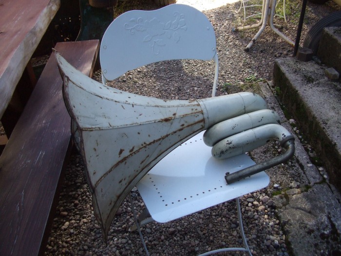

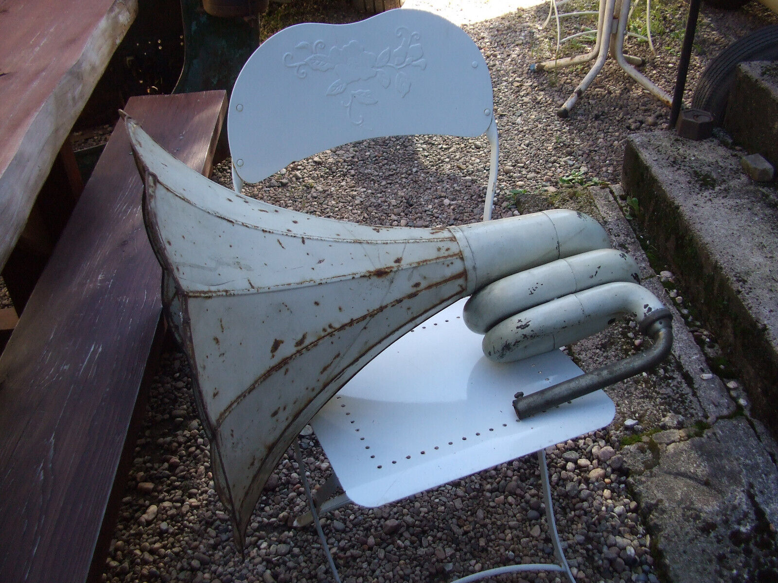

What is it?
https://www.ebay.fr/itm/145326539024
It's old,
must be for a saphir gramophone,
the arm looks like a Pathé arm,
I really don't understand how it was supported and on which machine;
Of course, it's not mine.
Any clue?

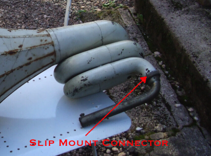

This is basically a horn with a permanently attached elbow (and a coiled extension in between). It would be a slip fit connection into the back bracket much like a Zonophone back mount. The tone arm would attach separately like on a back mount Pathé. The coiled tube would in effect lengthen the horn substantially without the need for a long horn body. I'm attaching a pic of a Zonophone back mount horn with permanently attached elbow to show similarities...

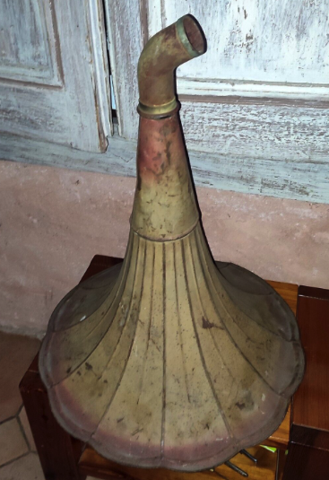

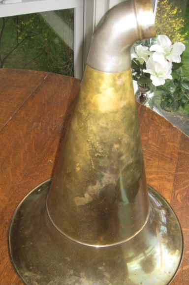

Here is another French slip mount horn & elbow...

This horn belongs to the larger variation of the Pathé Concert machine, the one that looks like a confessional, with the horn concealed inside the cabinet with only the bell visible behind a bas-relief of a Muse. It is a standard Pathé horn of the period attached to the coiled plumbing that connects to the arm. The smaller version (I have one of them) does not have the coiled plumbing, it is a straight connection.
