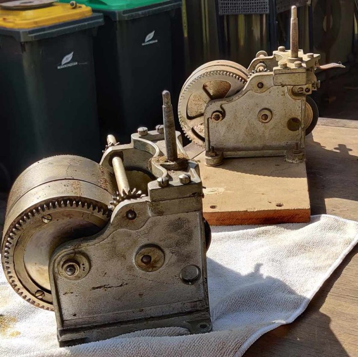

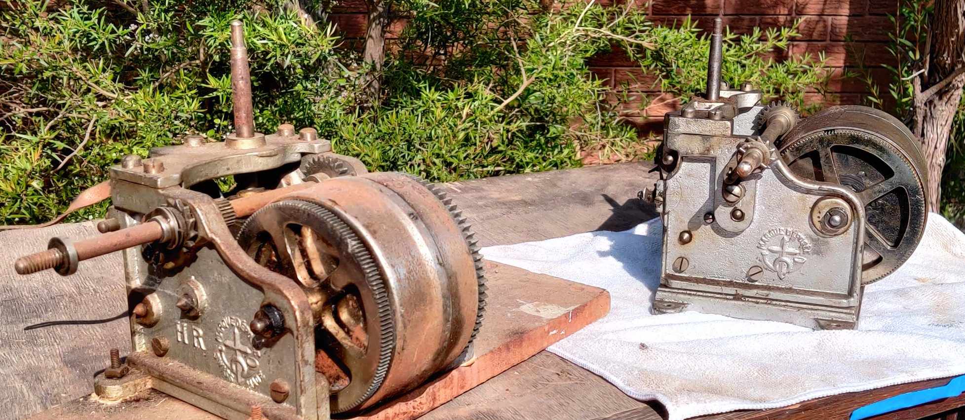

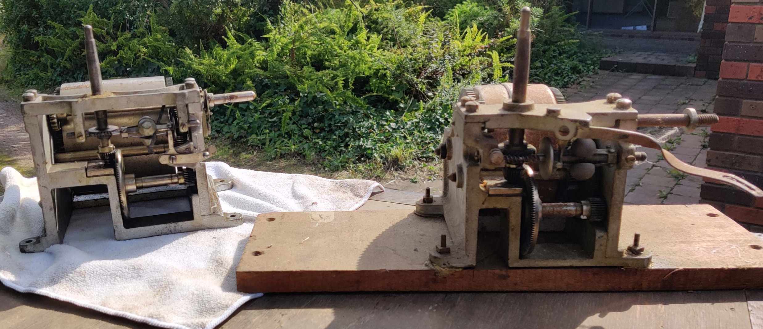

I don't often have these two large Paillard motors on the same table at the same time. So here are some pics. The Paillard HR 2-spring and the (unmarked) Paillard LG 3-spring.
The LG motor is from my latest project, an Australian SALONOLA Console gramophone. More on that coming later and we shall see if the Paillard LG can really play 10 12" sides.

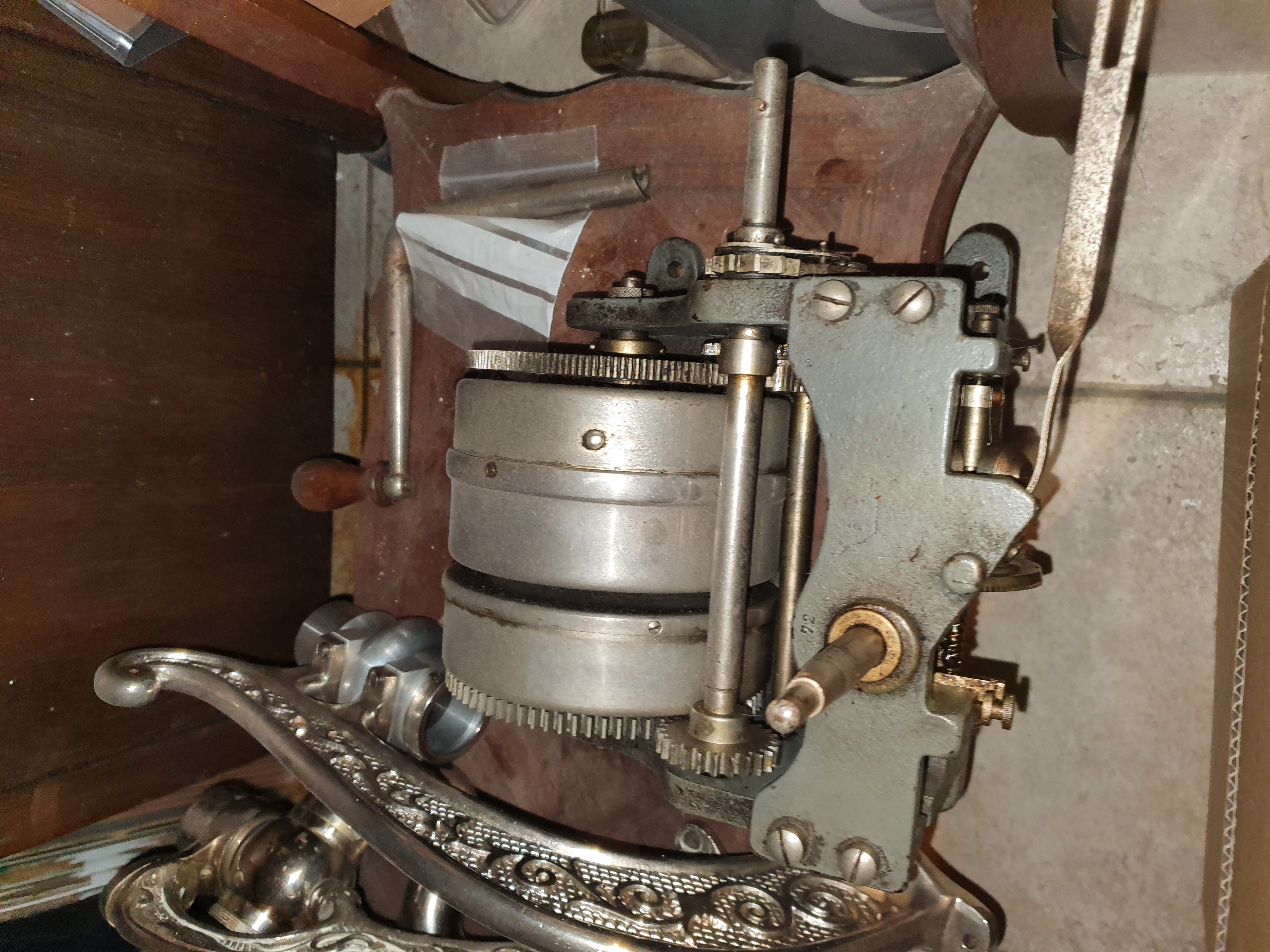

Steve wrote: Mon Apr 15, 2024 2:31 am That looks like the motor used in the Bassanophone, in which case I can attest, it does indeed play 10 12" records!
Steve, this is the Bassanophone motor, patiently awaiting to be re-installed. Not sure if it is the same model as the ones on the photos, it has three springs - and weighs a ton!
