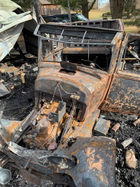

Posts: 6757
Re: Very fast thorough motor clean on single spring unit.
PeteLeoni wrote: Tue Oct 31, 2023 10:51 am For those who (like me and all my friends) lived through the day when people rode bicycles without helmets and grew up strong I (-: apparently the Victor people used gasoline to clean springs. Diesel is most likely fine for the job.
From the 19*.* manual, for me this settles it. I will use the diesel soak.
"(Fig. XII, page 16). If you find that the lubricant has become gummed, wipe off with gasoline"
The guy who owned this car "wiped it off with gasoline" too ...
Afterward, he went out on an errand and returned home to find this.
(He probably also rode bikes without a helmet.)
