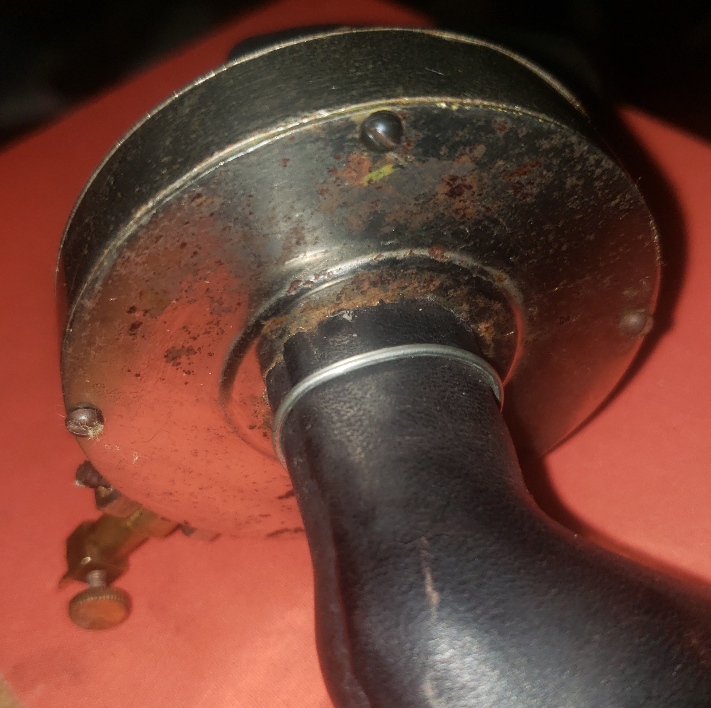

Hi all,
I have a duplex Reproducer that I started to "fix" almost 10 years ago and... There's uncertainty in it's reassembly.
Does anyone have a nice inside shot with one or both of the faces removed? That's where the magic happens.
Of if there's a good post about relevant information that would be great (my search didn't find one).
Thanks!
Dave

I did it myself.
It's a bifacing stylus that I used Victor 4 Reproducer style gaskets for to lock the mica diaphragms in place. Soldered beeswax over both sides of both connections.
I tried it on my vv xvii
https://youtu.be/xfbX0Xt2dpU?si=mj8aZnKX2D5CGgoa
I know that's an iffy testing method...
The yellow is from a paint pen I used to mark the foam before I cut out the gaskets.
