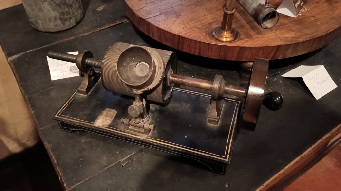

Hello,
I came across an apparently original tinfoil phonograph.. I have almost no information on this, and nothing is written on it, nor any serial number.. any comments from experts? I put a picture I took!
Thanks!
TinfoilPhono
Posts: 2061
Location: SF Bay Area, Calif.
Re: Is this tinfoil original?
Post by TinfoilPhono »

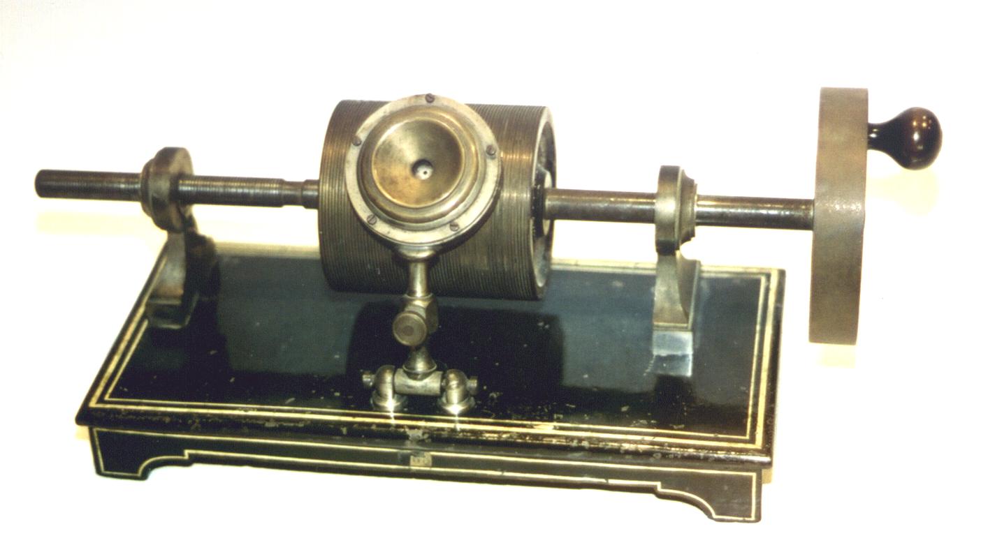

That is an original tinfoil phonograph made in Italy by a manufacturer in Torino named J. Nigra. There is little known beyond those basic facts. It most likely dates to the 1880s or 1890s, and was probably made for scientific research or education purposes. Such tinfoils were made throughout Europe even as late as the start of WWI in 1914, though most production ended by the mid-1890s since far superior instruments were available for acoustic studies.
I know of one in a collection in the US. It appears virtually identical, except for the mouthpiece and the hinge mounting for the front standard. (See attached picture.) It's certainly a great find.

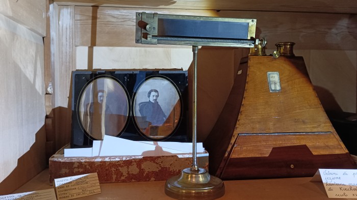

It belongs to a high school collection of antique scientific instruments, located north of Italy!
They also have what they claim to be the biggest known Daguerrotype with a picture of Leon Foucault (see it attached, but I'm not an expert of this).
Thanks for the precious details!
