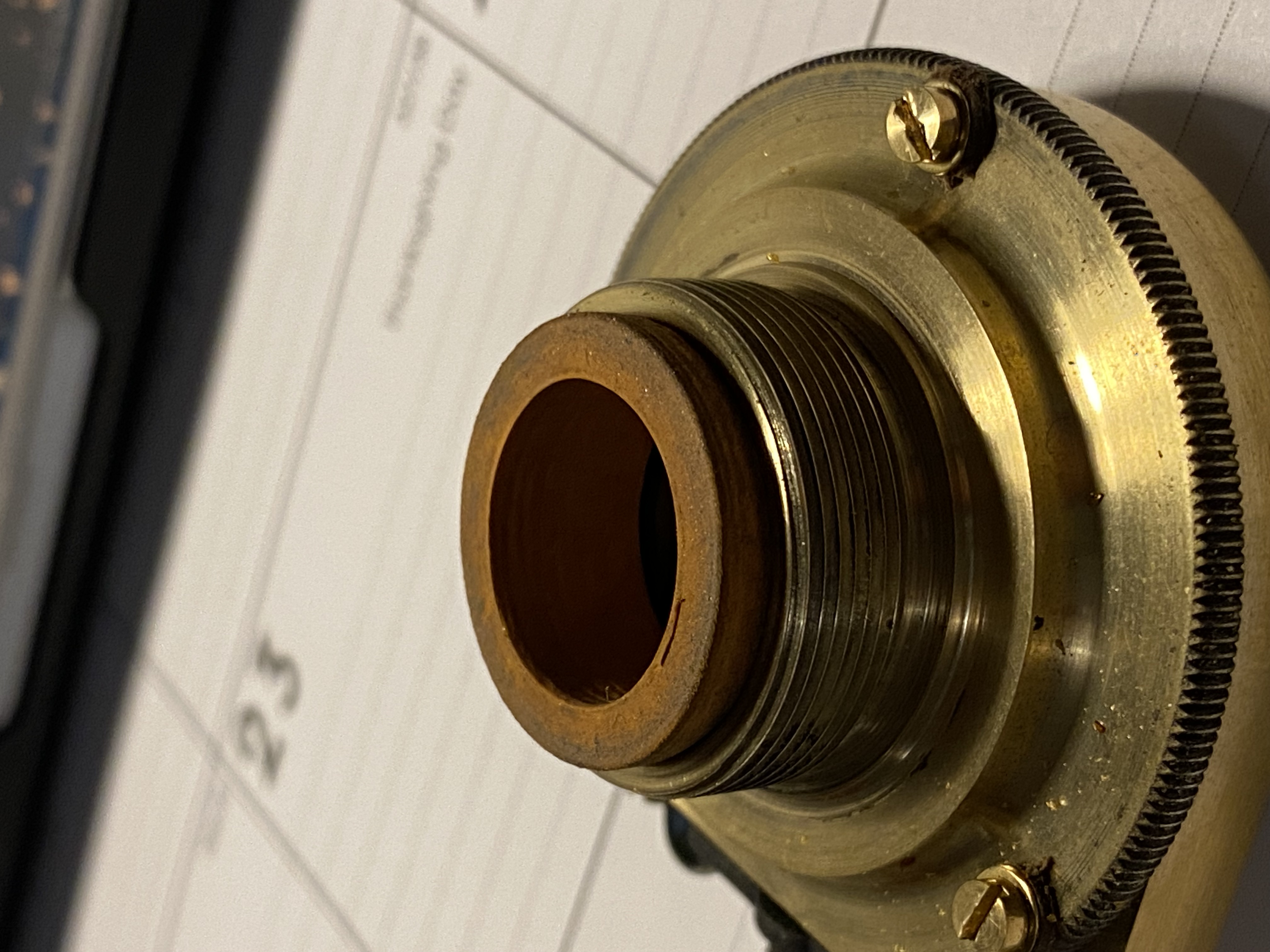

Post by Watanabehi »

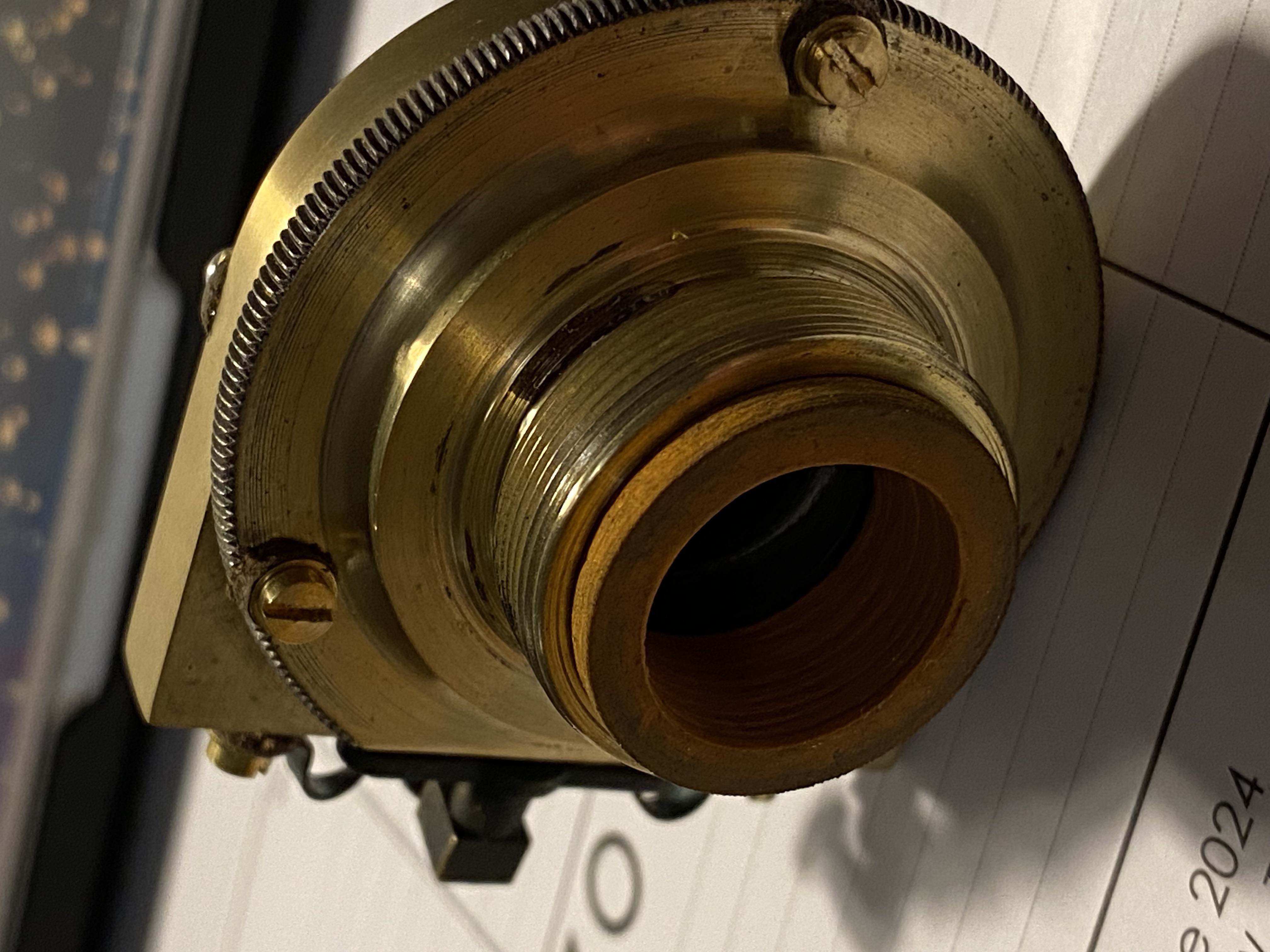

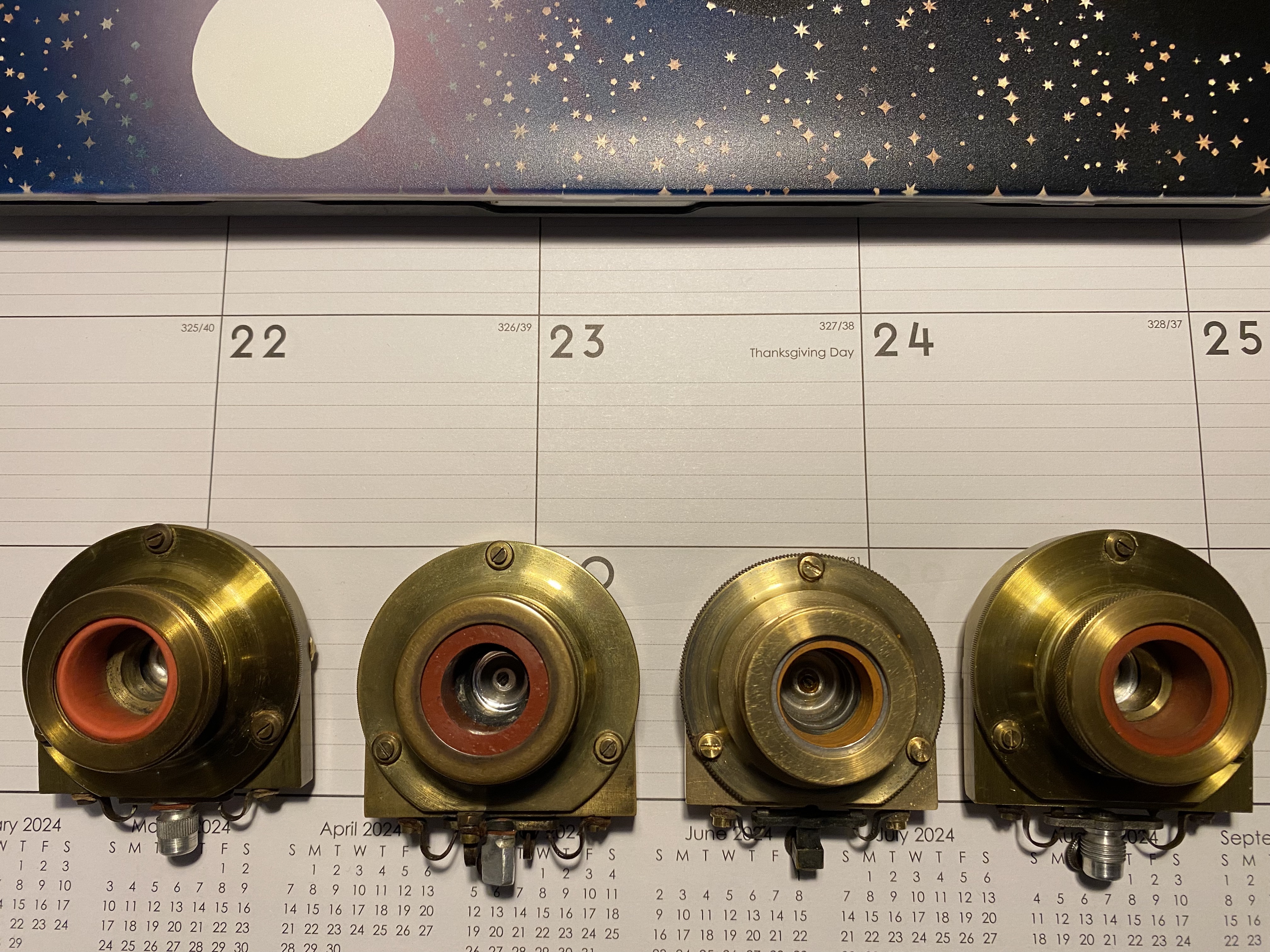

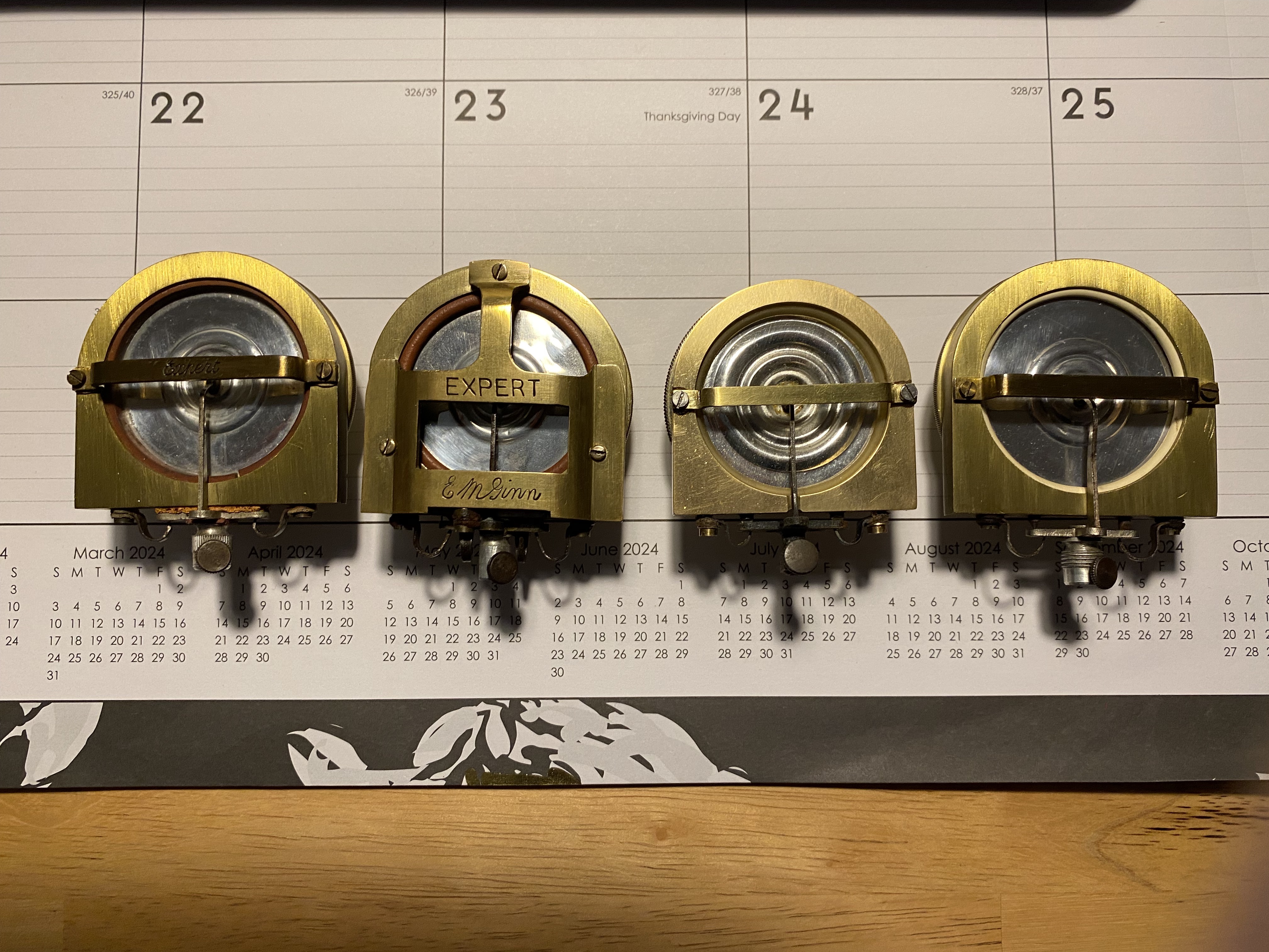

It arrived here in the US yesterday. Here are the photos comparing with the original Expert soundboxes. It doesn't have any obvious welding or brazing signs on the back.

Watanabehi wrote: Tue Nov 14, 2023 10:04 am It arrived here in the US yesterday. Here are the photos comparing with the original Expert soundboxes. It doesn't have any obvious welding or brazing signs on the back.
Great to see that it arrived safely and to see the sound-box 'line-up' !
It seems to 'fit-in' really well - really looking the part !!!!!

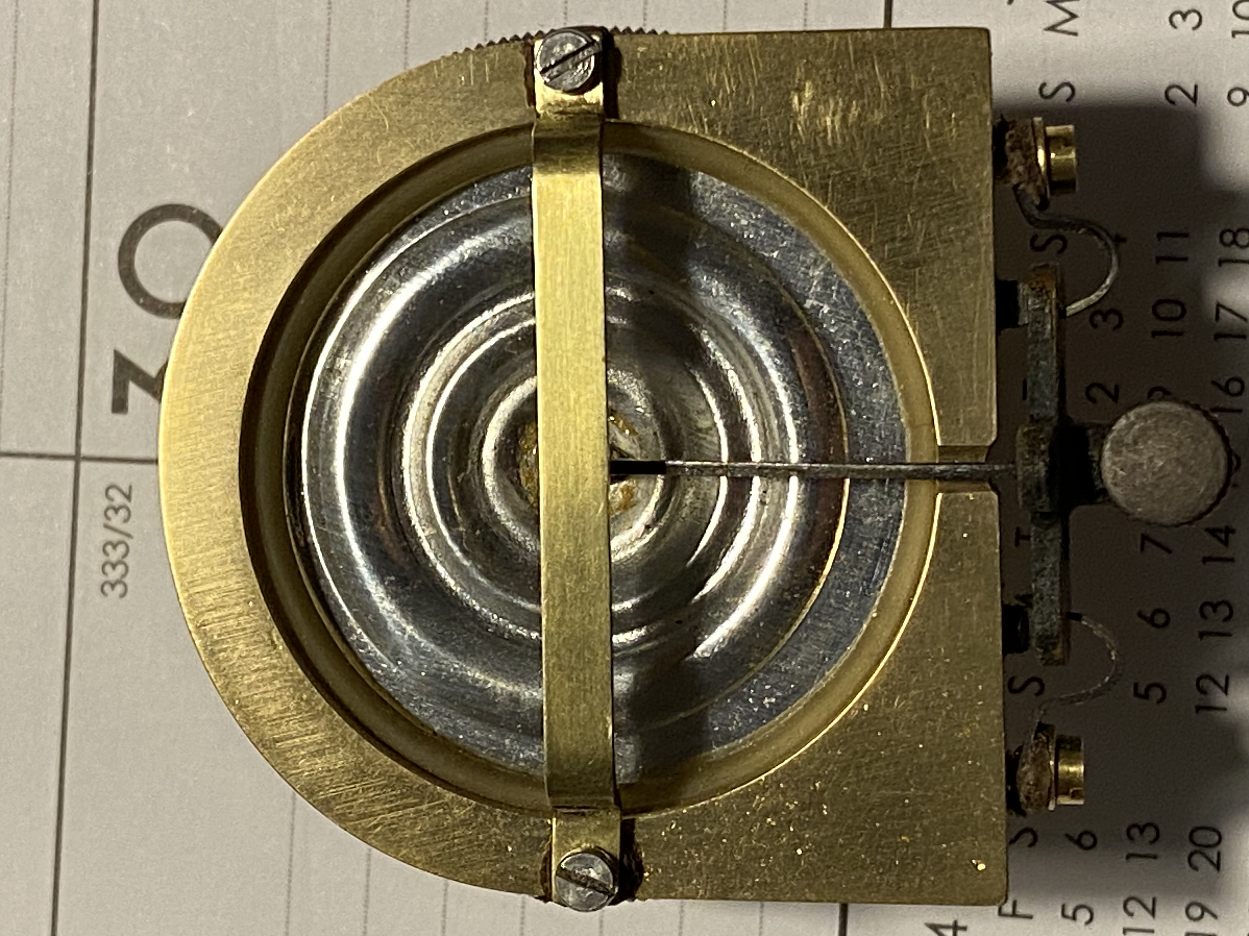

Appears they should have shortened the needle arm a bit to bring the diaphragm on center.

JerryVan wrote: Wed Nov 15, 2023 11:37 am Appears they should have shortened the needle arm a bit to bring the diaphragm on center.
I know it is not in the center, but I make my own emg type diaphragm. I might change to mine. But first I enjoy aging it for a while to see how sound would change. It depends.
