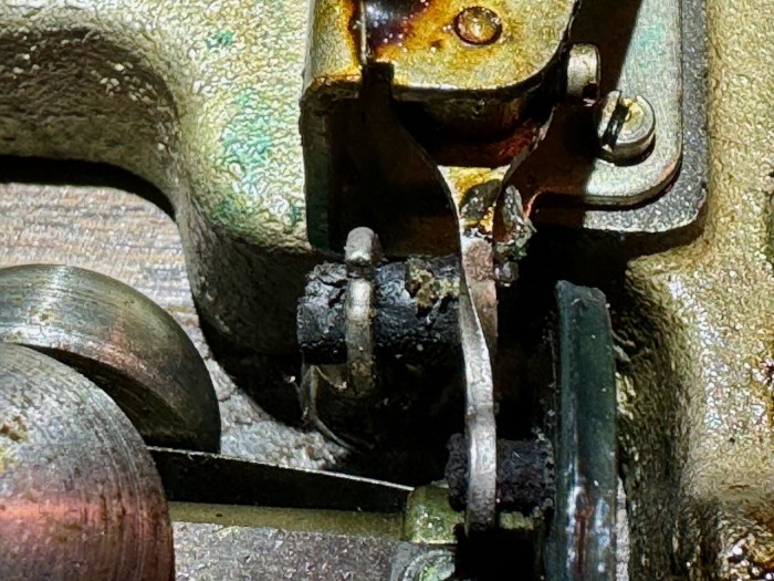

Is the lever that connects to the speed controller supposed to drop back into place though? There's nothing currently that causes it to return, just the thin rod that pushes it down and then leaves it there. It does feel like there's a slight spring action that should maybe return it, but I don't really know what I'm looking at of course, though it looks fairly gunked up at the other end.
It all seems very well greased still and works smoothly.
- Posts: 6682
Re: HMV Model 160 speed issues
Yes, there is a spring that keeps tension on the lever arm so that it is always in contact with the speed adjuster screw. Can you show us a picture of the other end of that lever, where it interacts with the governor?

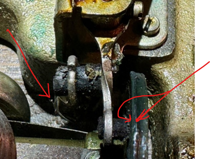

- Posts: 6682
Usually, in the area of the left arrow, there is a coil spring, wrapped around the speed control shaft, that applies tension on the shaft to keep it engaged with the control screw. One of 2 things has likely happened. 1. It's either missing/broken, or... 2. There is so much dried and hardened old oil/grease that the shaft is too gummed up to move. At least by the force of the spring anyway. Also, the double arrow on the right points to more of dried goo that needs to be completely removed before you have any chance of good speed control. I'm pretty sure that the cleaning will need to go even beyond the boundaries of what I've indicated.

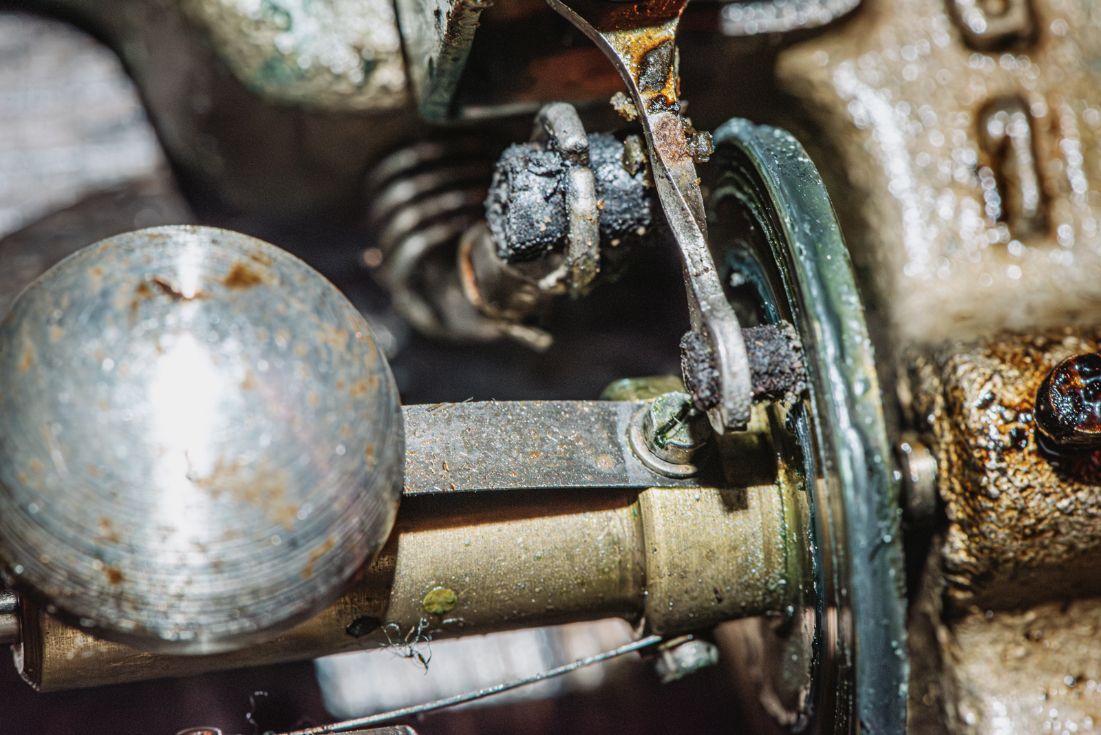

Slenver
- Posts: 7
- Joined: Sun Nov 05, 2023 9:45 am
Thanks you.
Yes, I can see the spring but it doesn't appear to be doing too much, and there's just the slightest amount of springing back when the controller is moved.
I can try and clean what I can (admittedly it actually looks pretty clean to the naked eye) but everything moves nice and smoothly to the touch. I fear the spring itself is past its best, though in honesty I've barely used the gramophone at all over the few years I've had it and it was fine until recently.
