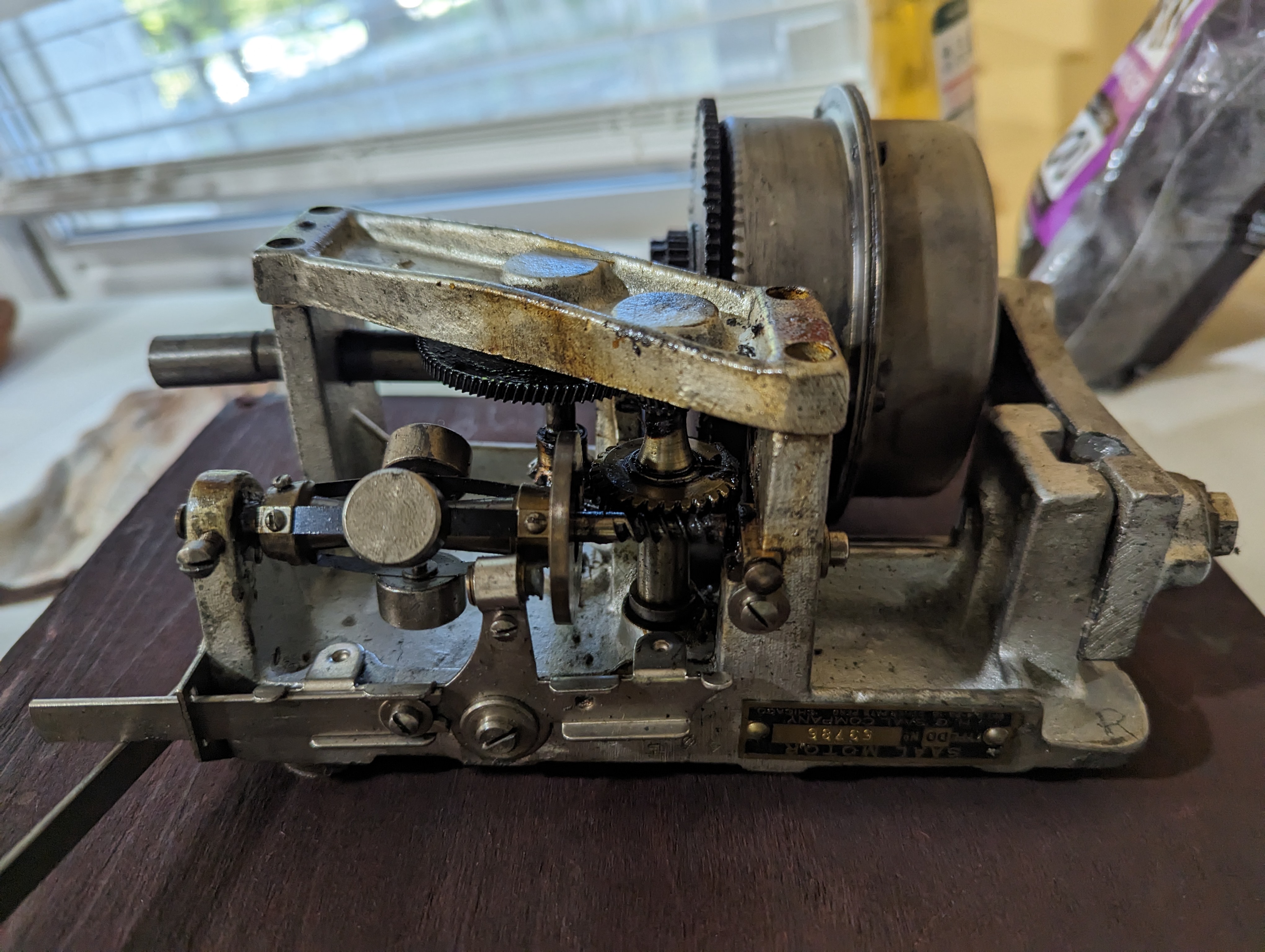

I have a 1920s Silvertone Phonograph with a Saal DD motor. The machine would play records just fine but as I had recently bought it, I wanted to clean the motor. Upon reassembling, the turntable shaft needs to be manually turned to get it spinning and will stall if any pressure is put on the turntable.
If I just have the motor out (turntable taken off) and start the machine spinning, it will lasts a few seconds before stopping.

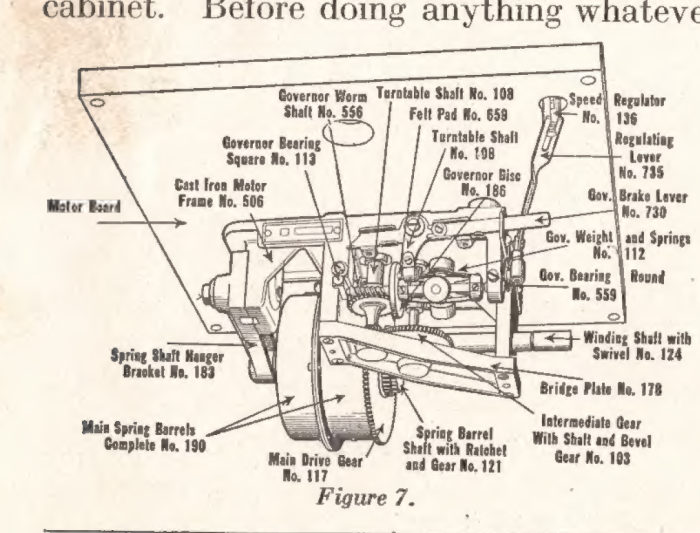

2. I did not remove the govenor. There is some play with it where it sits. From my research, some play is ok, just not sure how much. I did remove the govenor worm (no. 556) and Intermediate gear with shaft (103).
3. The screw that keeps the regulating lever (no 735) attached to the speed regulator (no. 136) had come off. I believe I reattached this correctly but the screw easily comes out.

Try making slight changes to the adjustable governor end bearing, #113. The opposite end bearing is also a thrust bearing. Down inside the bearing, there should be a tiny ball bearing. The end of the governor shaft rides against that ball with just a point of contact, to reduce friction. Sometimes, in cleaning, that ball can fall out. Similarly, the end of the spindle shaft rides on a single ball bearing that sits in the bottom of the bearing in the Bridge Plate, #178. Very common for this to fall out during cleaning. Ensure that it is there.
