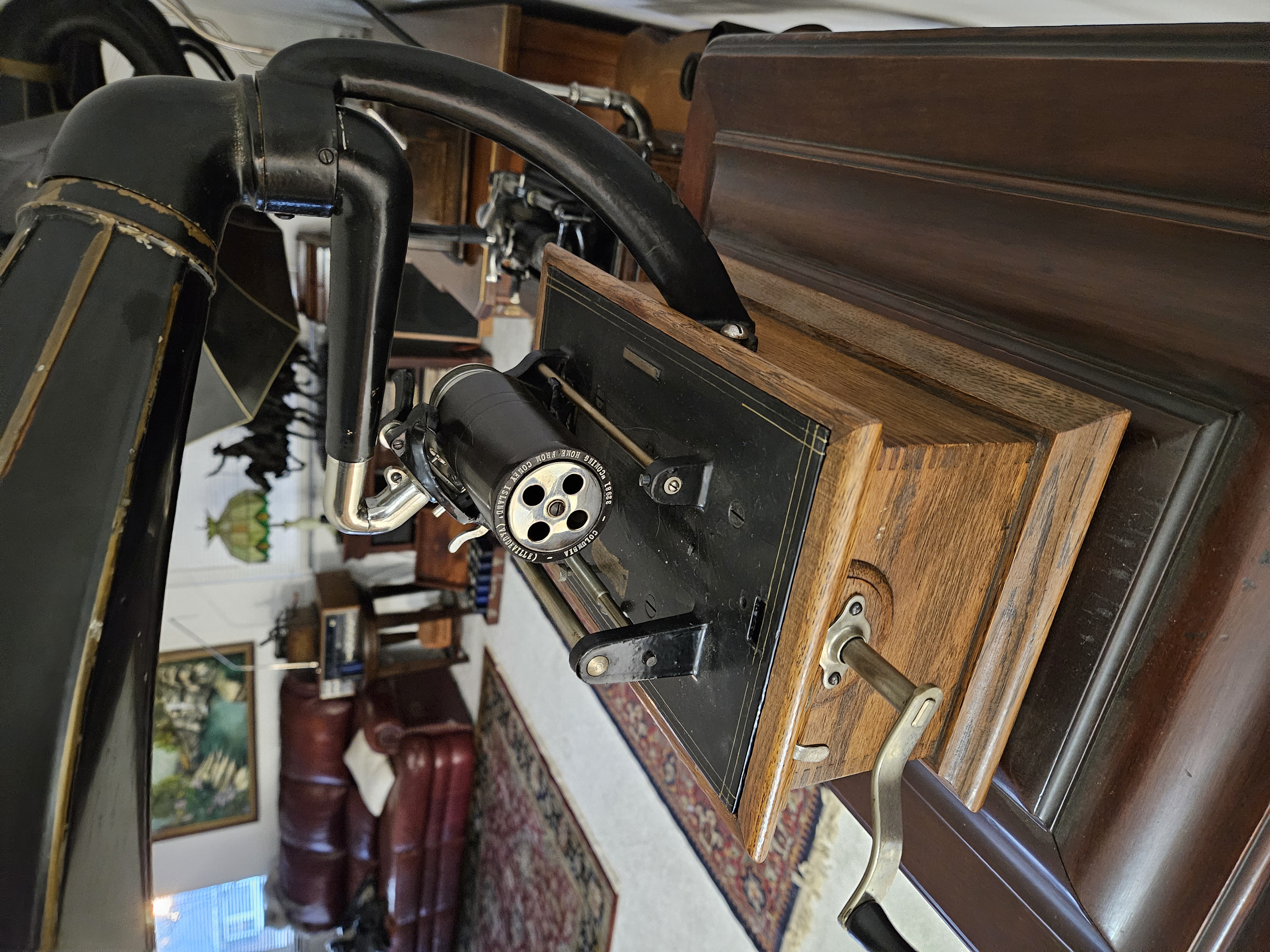

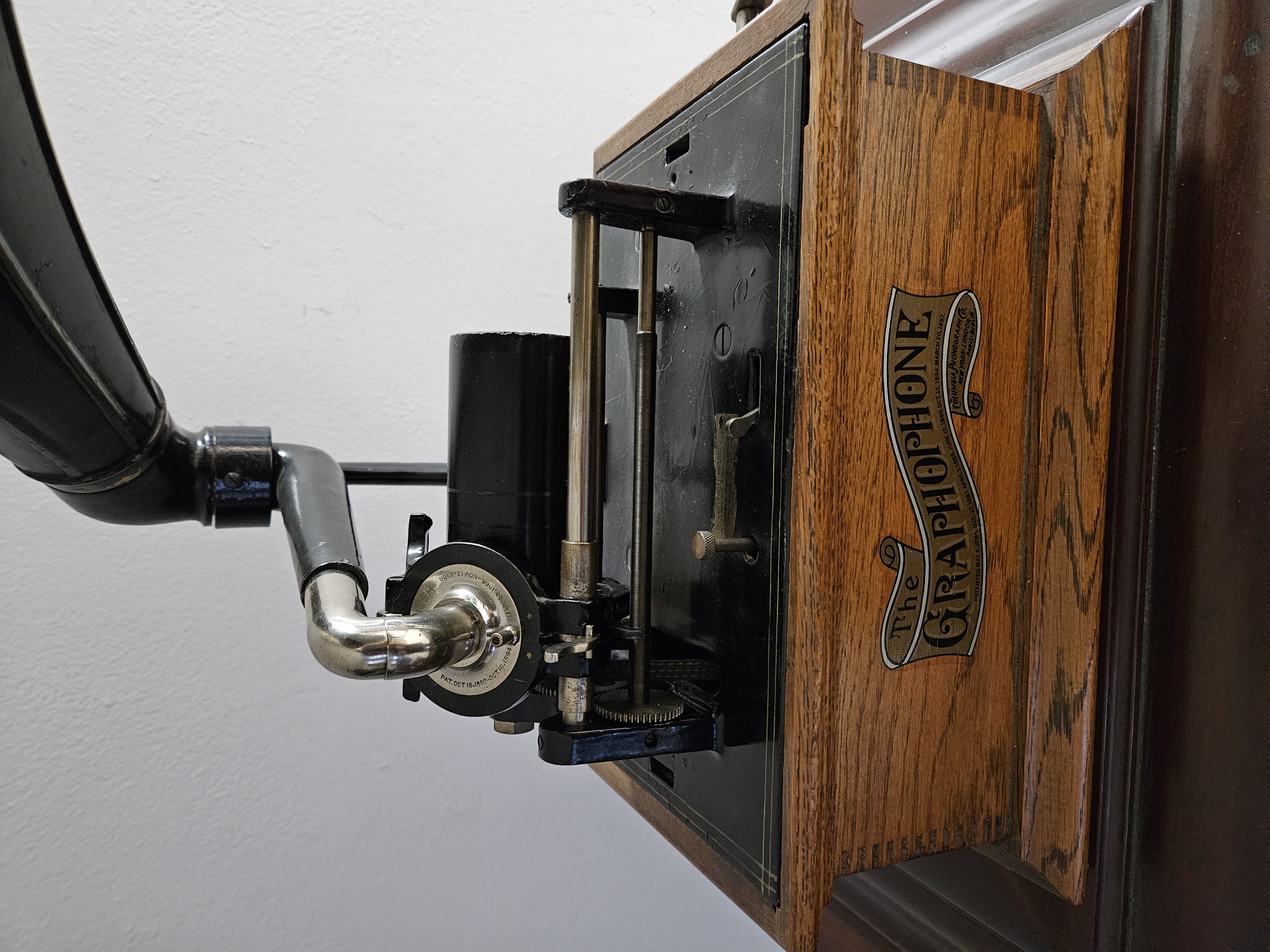

Bought this good-running 2 minute Columbia machine at auction on a whim to add to the several non-Edisons in my collection. I believe it to be a BKT. However, the top of the rear bracket is thicker than most. I did find one other nearly identical machine with the thicker bracket on Worthpoint, identified as a BKT. Any thoughts?

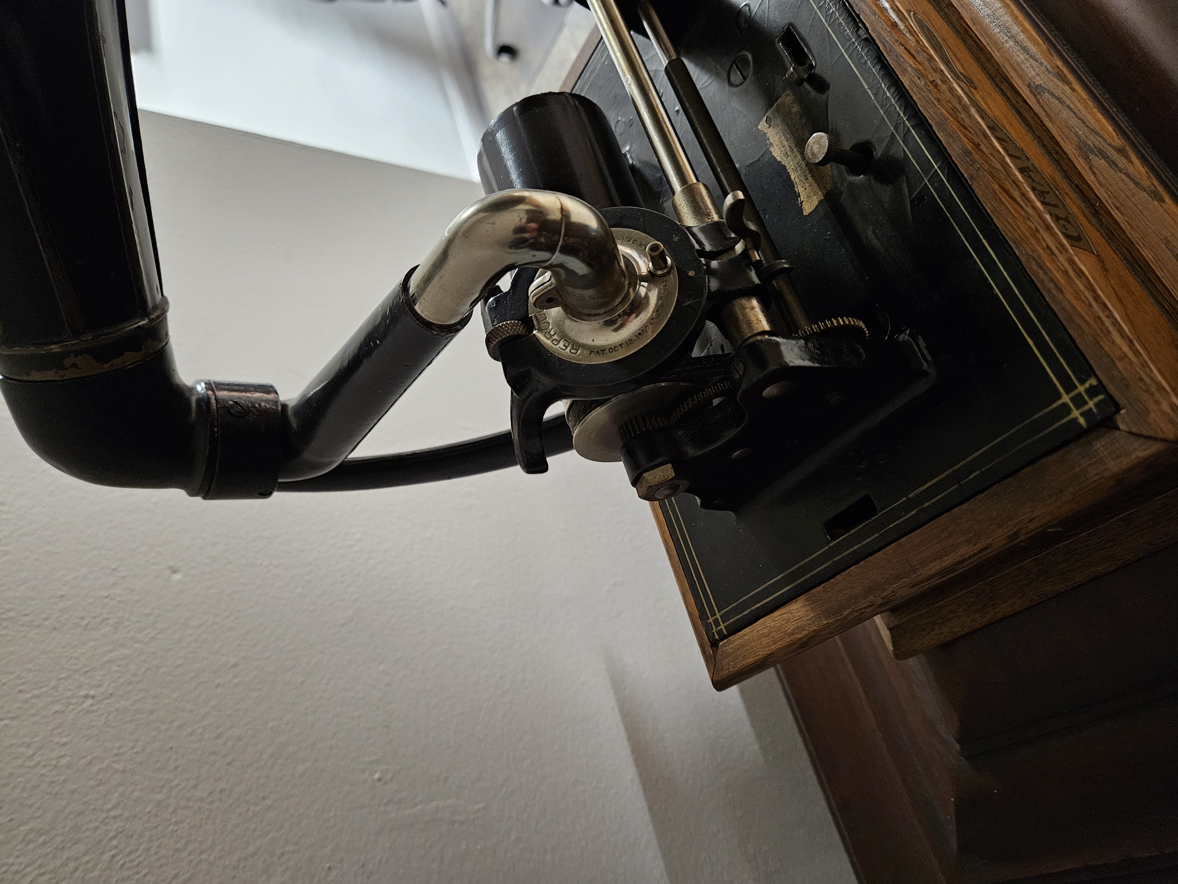

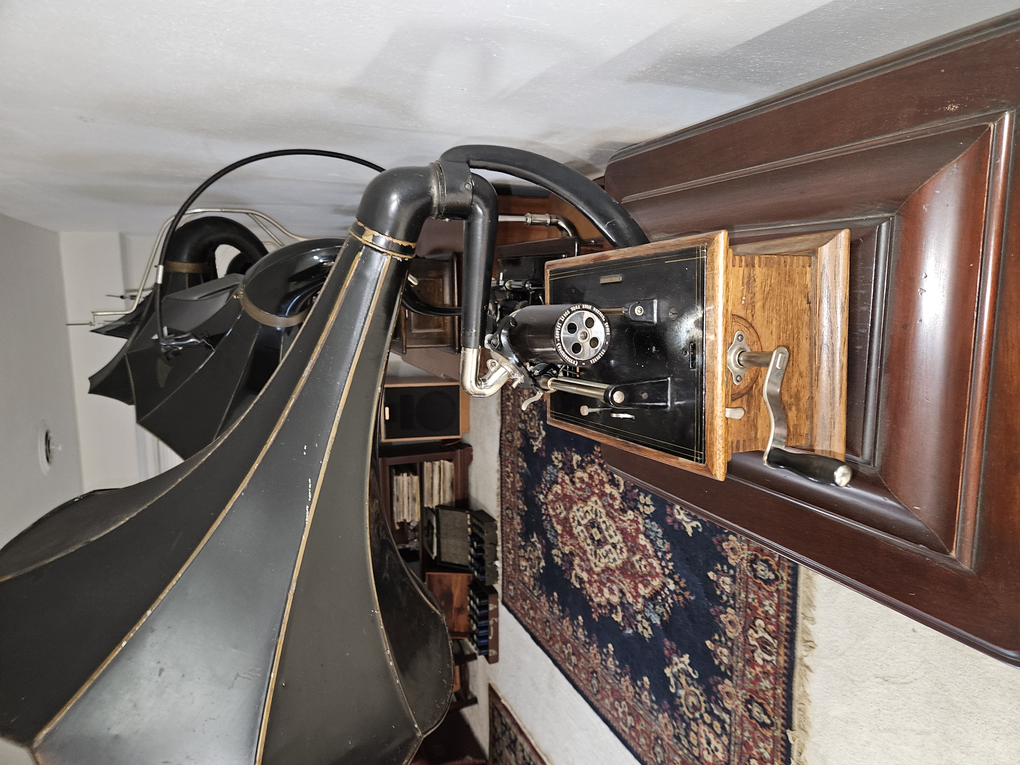

Here are a couple more pics. Not sure why the orientation is flipped.

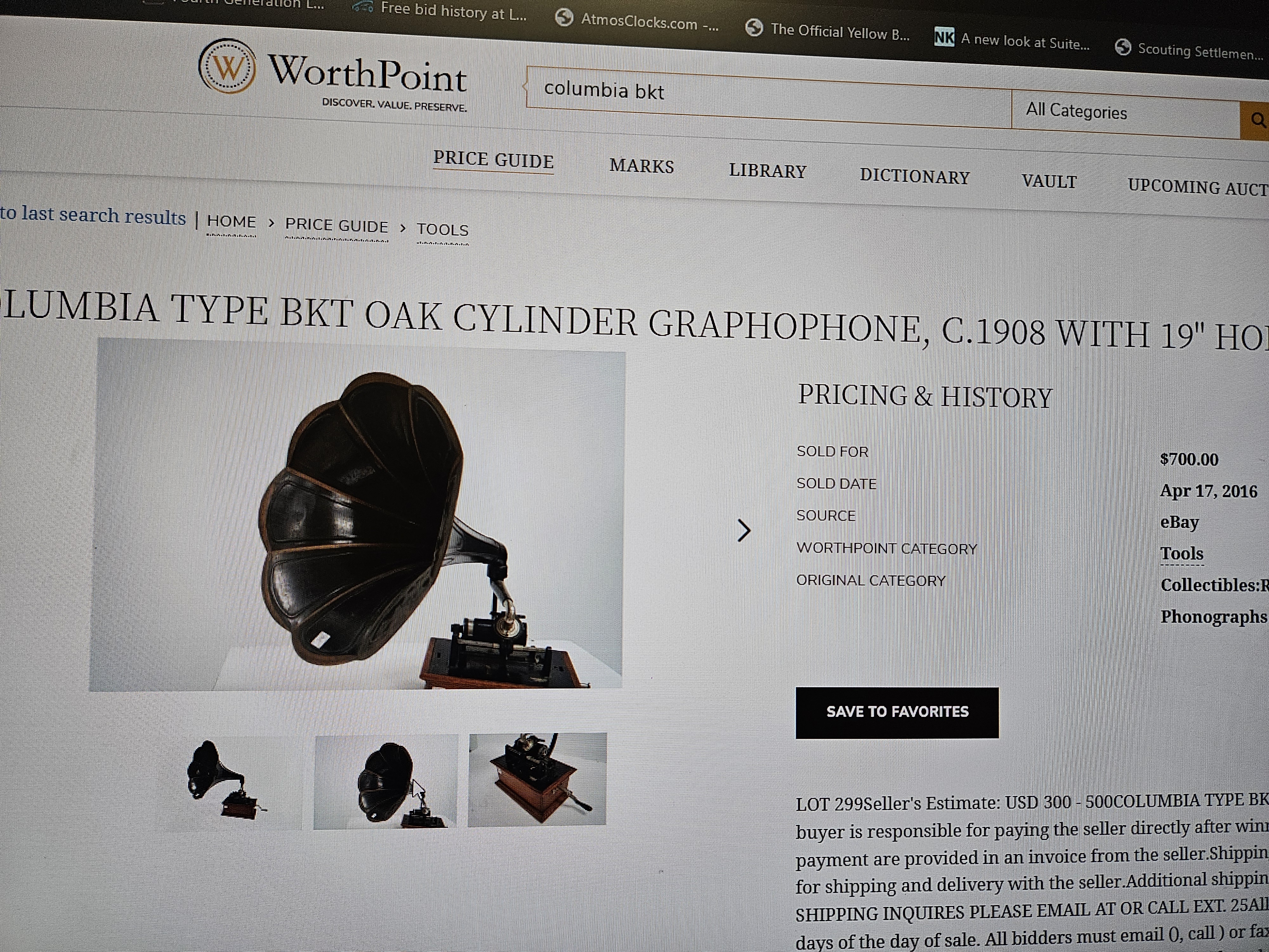

Here is the one on Worthpoint identified as BKT.

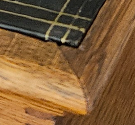

The cabinet and tone arm do look a bit odd, but the machine itself is definitely a BK and not a BV. I'm kind of thinking that a BK works has been fitted into a BV cabinet. See how the top of the cabinet has been modified along the front & rear moldings to accept the larger BK top plate.
Screenshot 2023-12-17 183945.png (295.66 KiB) Viewed 595 times

You have the Oxford Model WM version of a BKT sold by Sears. It shouldn't have a banner decal. It's the last version of the BK chassis as it has the serial number stamped on that raised boss at the rear of the chassis, serial number should be in high 80,000's
BV/BVT machines have nickel plated bed plates.
