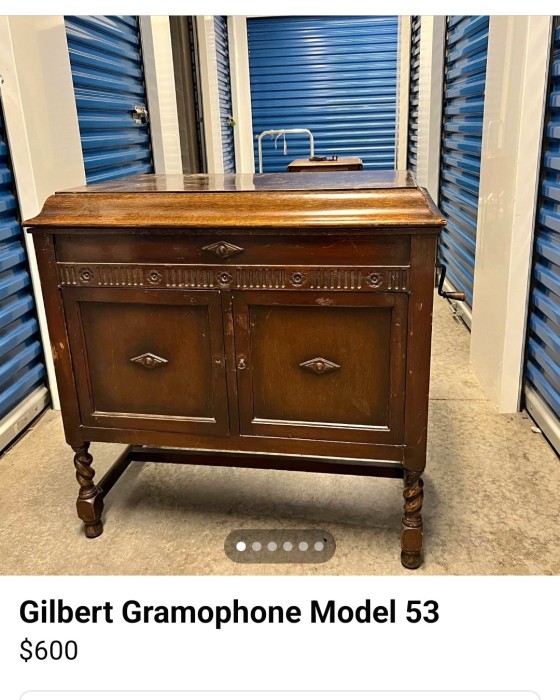

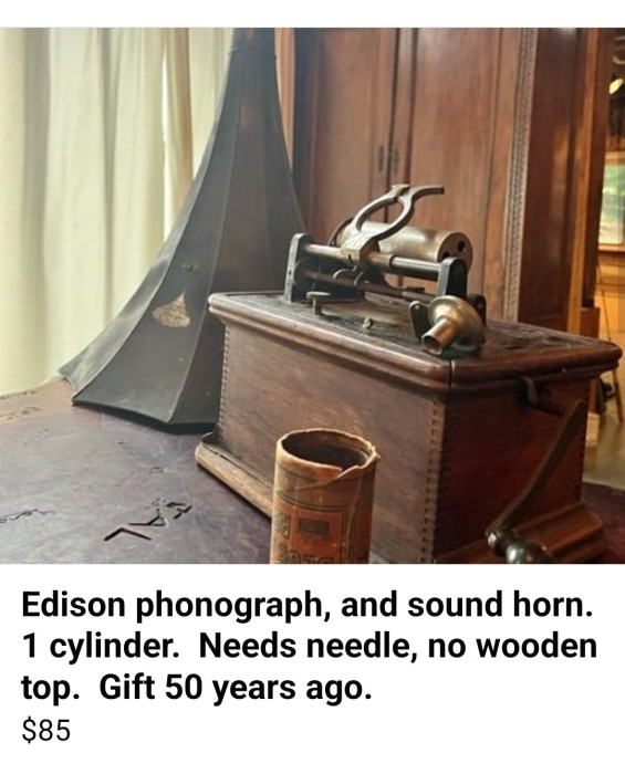

1. What can you tell me about an Edison 1 cylinder phonograph? See photo.
2. What can you tell me about a Gilbert Gramophone model #53? See photo.

I can tell you that the "Edison" phonograph is not an Edison, it's a Columbia BK. The reproducer and horn are Edison however. As to it needing a stylus/needle, I wouldn't put any bets on that being the case one way or the other, since the seller has no knowledge of what they're selling. At any rate, the Edison reproducer will not work in the Columbia machine. It's basically "parts", but at $85, it's worth it... for parts value.
The Gilbert is overpriced, no matter what it looks like with the lid opened.

Hi- Regarding the first picture--- It's a Columbia machine with an Edison horn- The reproducer on top of the machine is an Edison- the position of the weight suggests that it is likely detached from the reproducer body.
I live fairly close to where it is located. I have messaged the seller several times over the past couple of months and not received a response. I hope you have better luck contacting them.

Yup, and the Edison horn and Edison reproducer do not belong with it. The horn could be made to work, but it’s a bit of an inappropriate mismatch.
The reproducer seems to have issues as well, so just set it aside. I’m confused about the remark on stripping and repainting the horn. Unless it’s lost a lot of paint, the original black paint with gold pinstripes should be fine. It’s only original once.
You should be able to find the correct Columbia reproducer for it (search on Columbia “Lyric” reproducer), and a simple “witch’s hat” horn will work well and is readily available.
