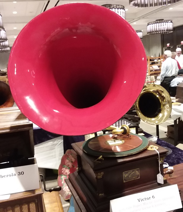

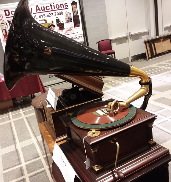

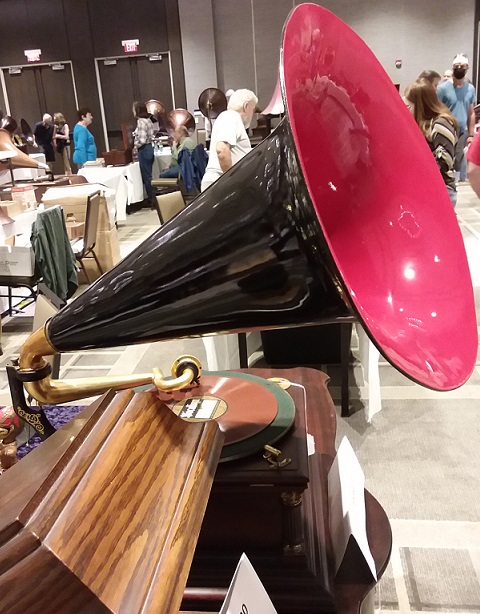

I realize that I am hijacking a "dead" thread here, but since I own both a Victor 6 and a Victor VI, I encourage anyone who is seeking additional information on this topic to watch the YouTube video series I uploaded today about them. Also, as an additional reference, I've included some pictures of an original papier-mâché Victor horn and No. 10 reproducer. Both of these would have been offered as optional upgrades to the Victor 6 (not VI), though they are scarcely found today. Best wishes for New Year 2023!
