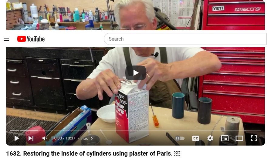

There is a video from Brett Hurt describing how to do this I will attach it if possible to this thread. Dyslexic Genius Hurt on YouTube #1632.
Screenshot 2024-01-04 at 18-01-25 1632. Restoring the inside of cylinders using plaster of Paris. .png
