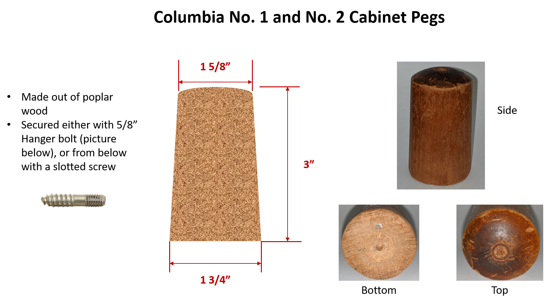

I'll start by sharing details on the Columbia wooden pegs, most often missing, and used in cylinder cabinets. Below is a picture and measurements that will help anyone who has, or knows someone with lathe skills to make these.
What else can you share with all of us???
