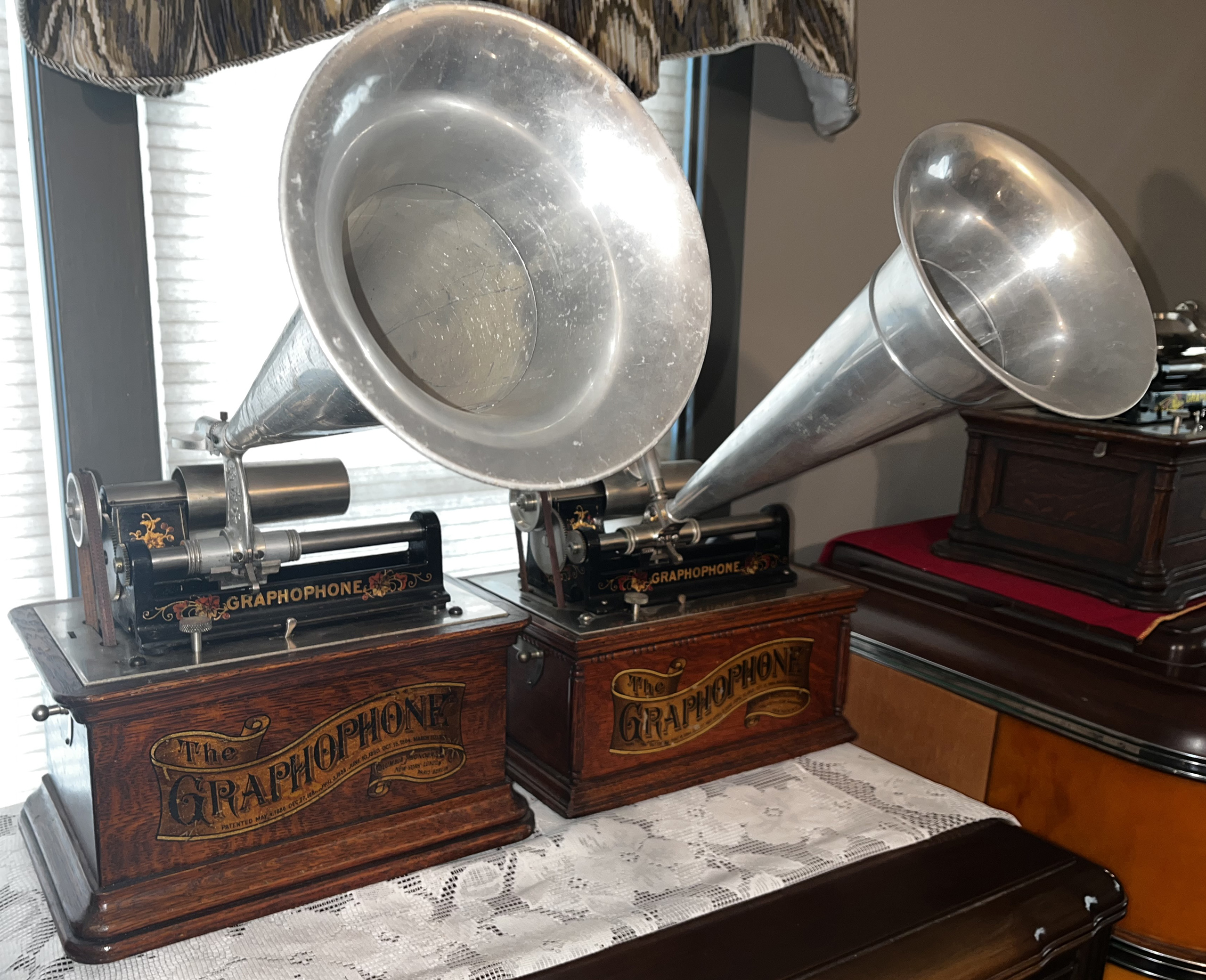

Here are pictures of 2 of the 3 versions of the AT. The 2nd version uses the earlier case and the later high trunnion chassis. Have that one
too but it's buried somewhere. Horns are 14" long with 7" bells.
Chuck
