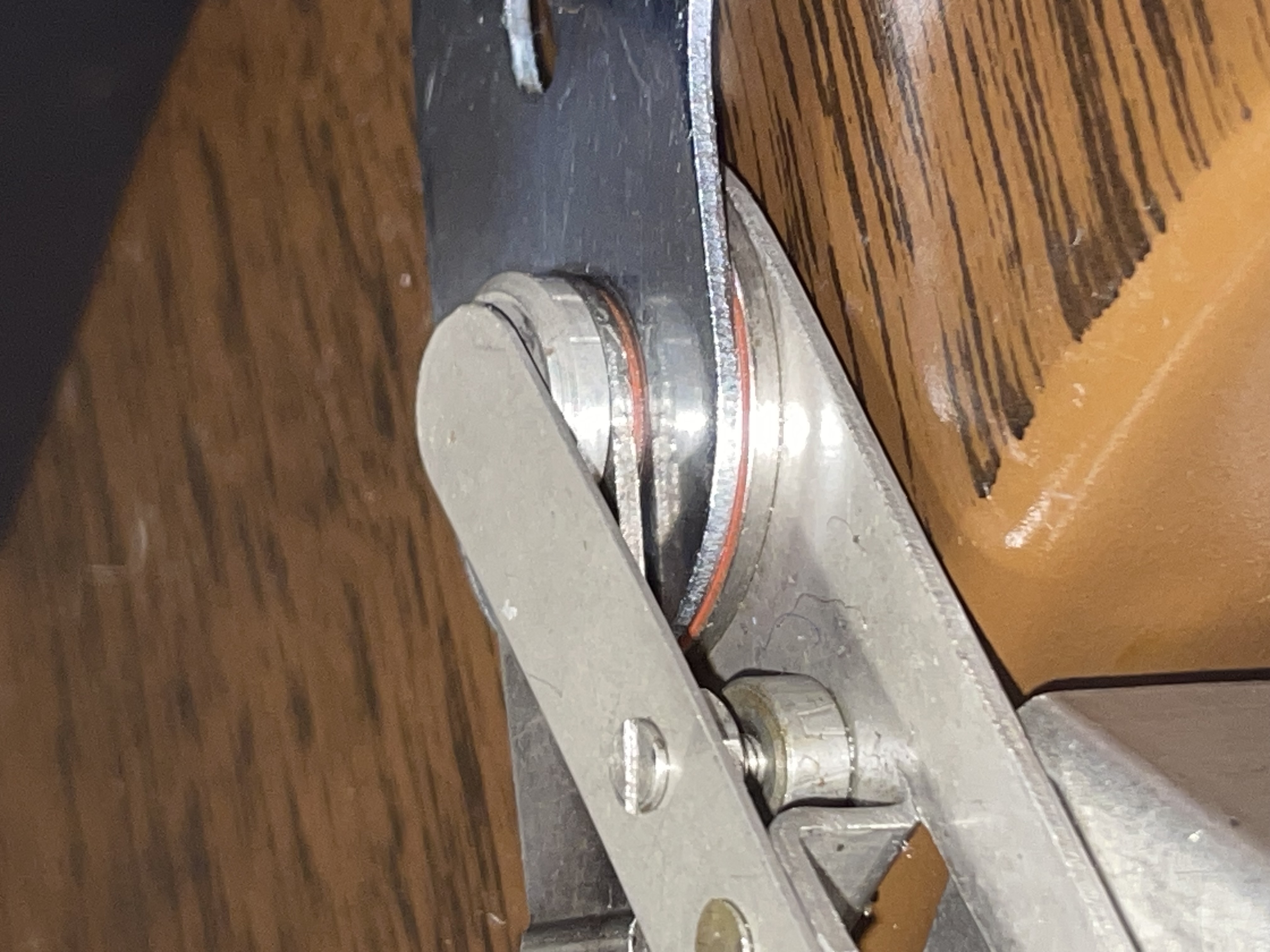

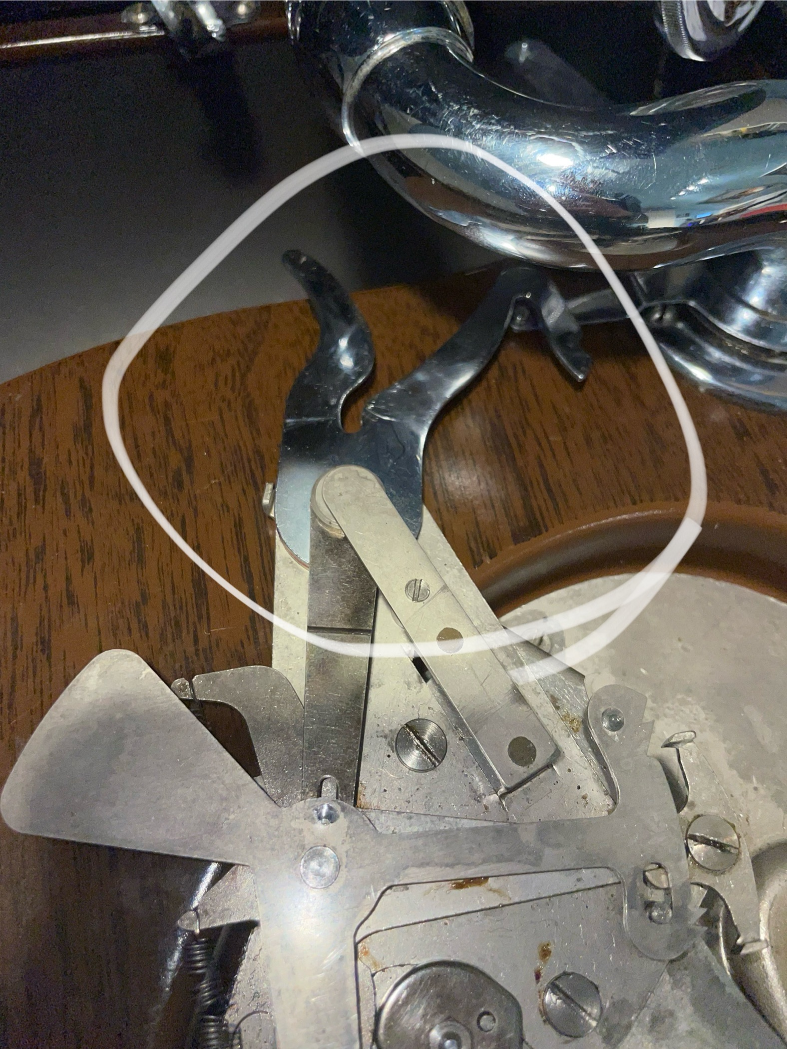

So I have a very good condition 102 from 1931 which has only the autobrake as it should. The autobrake works pretty much as its supposed to except that no matter what I do the autobrake's friction/resistance is too high. About half way through every record, the record will start repeating as the force from the record grooves moving the tone arm is not enough to overcome the autobrake arm's friction. I have taken the autobrake apart more than once, cleared it of any debris, oiled it, found out you shouldn't oil it and cleaned it of any oil, and I've tried loosening the brake's friction screw but then the screw starts loudly scraping against the bottom of the platter.
Any help or advice as to how to fix this issue would be greatly appreciated! I have also included a couple pictures of the part of the auto-brake that's giving me trouble.

Re: HMV-102 Auto-Brake Friction Too High
I don't know if there were variants of the Mark I autobrake (shouldn't be, as it was short lived), however your unit looks wrongly assembled, with some inverted parts.
If you look to the very first frames of this videoclip of mine you will immediately see that the huge red washer (indicating "no oil here") shall be well exposed on top, and not hidden below other components.
Thank you, Marco, a masterly exposition of the No 5 autobrake -- yes, Mark 5, not Mark 1!
Apart from the assembly looking like it’s incorrect, that tiny screw just below the friction washer is what tightens/ loosens the friction (red arrow). It might take some setting up to get it totally correct but it should work.
Had the same where the tone arm wouldn’t move across the record and just stuck!
Ideally take it apart at that part too and give it a good clean so there’s no gunk/ rust stopping it move freely.
Does this help you see in what order it fits together?
Yes this does thank you! It also points out another issue: My machine only has a single large red washer instead of the two (one on top and one on bottom) that yours has which may also be contributing to the issue.
- Posts: 6882
All of your washers appear to be located in the same order as the other example, except as you point out, that one of your washers is a smaller diameter. I'd guess that it not so critical. What may be critical is that your washers look notably thicker than those in the other example.
