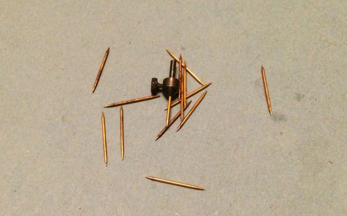

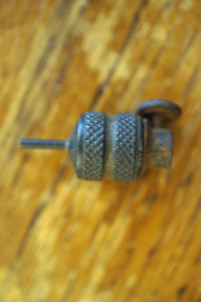

I came across this and can't figure out what it's purpose is.
It has a round top part which presumably slots into a round sound-box needle holder.
However, the bottom part is also round - so what is the point ?
I suppose it might slot into a soundbox with a triangular needle holder to convert it to a round one but triangular ones seem to work just fine with round needles ?
It is very large too - probably larger than the largest EMG sound-box needle holding part.
So, any explanation / ideas are very welcome.
Thank you as always.
What does this do ?

I don't know what it is, but it seems quite obviously to be an adaptor of some sort.
What size is the chuck on it? What is the largest diameter it will accept? And is it larger than the shaft?
If the chuck opens larger than the shaft, it may be an adaptor for very loud tone needles or larger thorn or cactus needles. Some cactus needles I need to sand down to have them fit the chuck on my Aeolian Vocalion machine.
Just a guess.
Just a guess.

It could be a device to add that mass to the needle, so it changes the sound of too harsh soundboxes. I've seen it somewhere before... don't remember where.

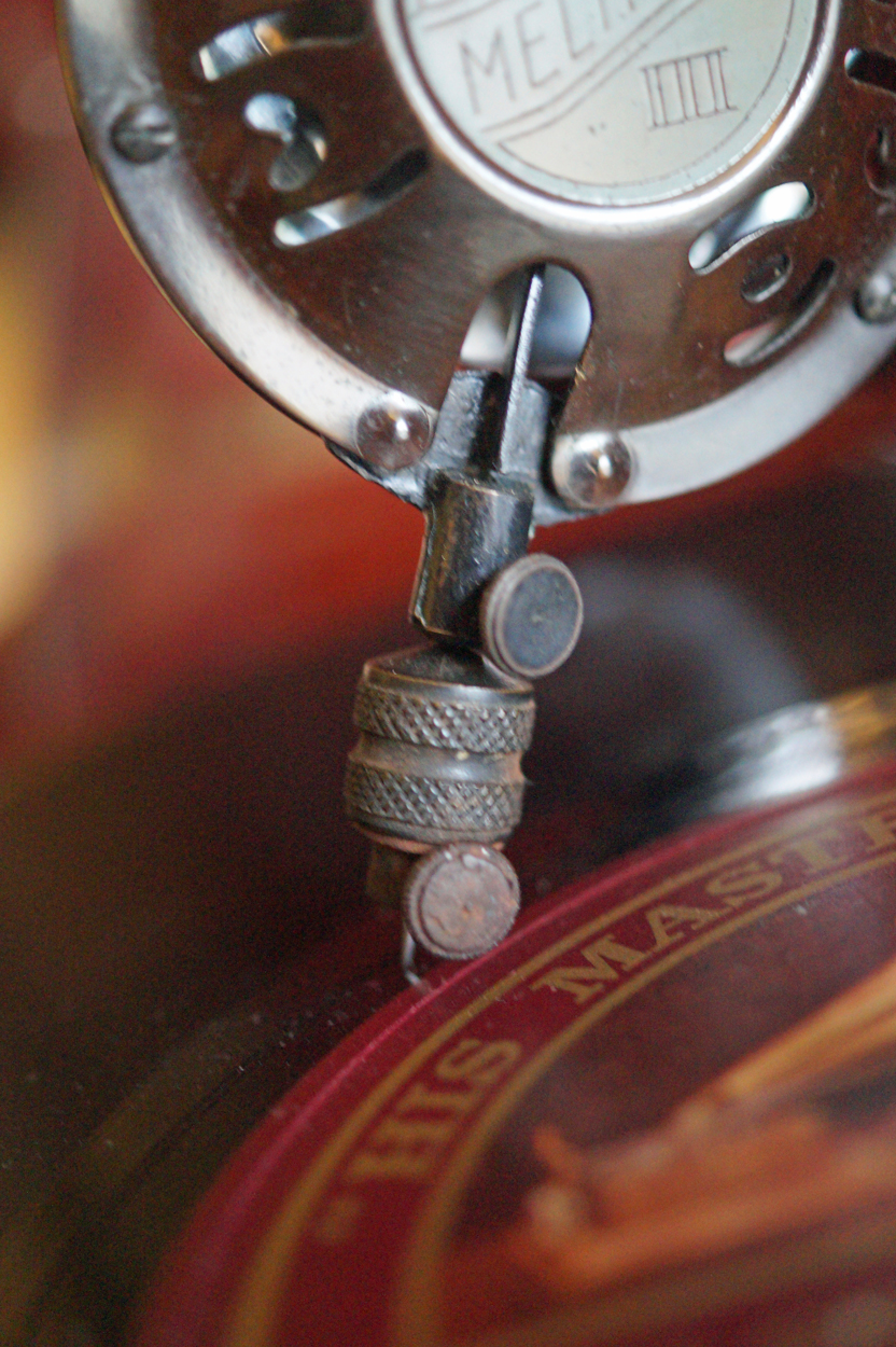

Exactly my thought, and I happened to have some lying around (but no tin to hand):

Re: What does this do ?
It is made to reduce the volume of very loud records. I have one I bought from Alex Kirtley, and it does attenuate a bit really loud discs that I otherwise wouldn't be able to play.
Thanks BassetHoundTrio, yes of course, I remember those now! The Edison Bell attachment has some visual similarity but is entirely different.

Very interesting. Thanks Lah Ca.Lah Ca wrote: Mon Jan 29, 2024 5:56 pm I don't know what it is, but it seems quite obviously to be an adaptor of some sort.
Just a guess.
I can't measure the diameters but the chick seems smaller than the shaft.

Maybe. Thanks Inigo.Inigo wrote: Mon Jan 29, 2024 6:24 pm It could be a device to add that mass to the needle, so it changes the sound of too harsh soundboxes. I've seen it somewhere before... don't remember where.
It is odd to use though as the sound-box has to be re-adjusted to meet the centre of the motor-board and then the needle works at an incorrect angle.
Also, to say it looks ungainly is an understatement !
Thank you also for noting the similarity to the 'sympathetic' device.
I think as Orchorsol has mentioned that although it seems similar it is quite different.
It seems to be made from brass maybe.

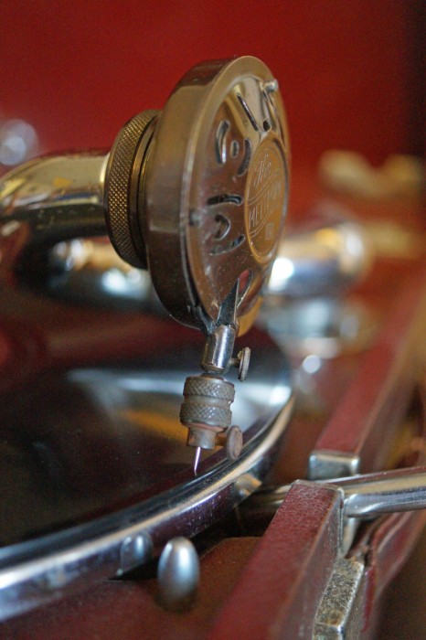

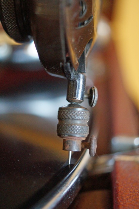

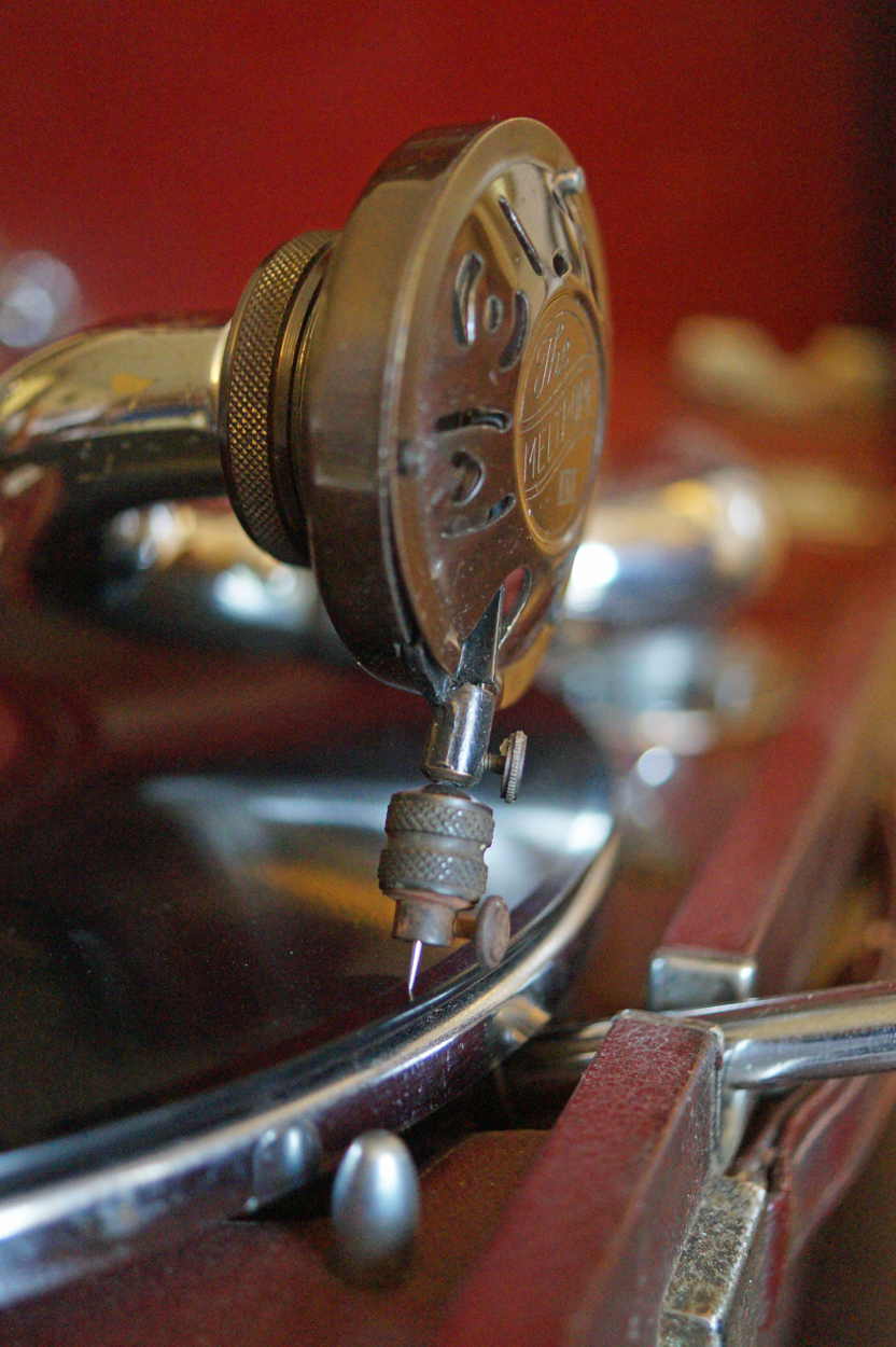

Here are some photographs I took this morning showing how large it is:
