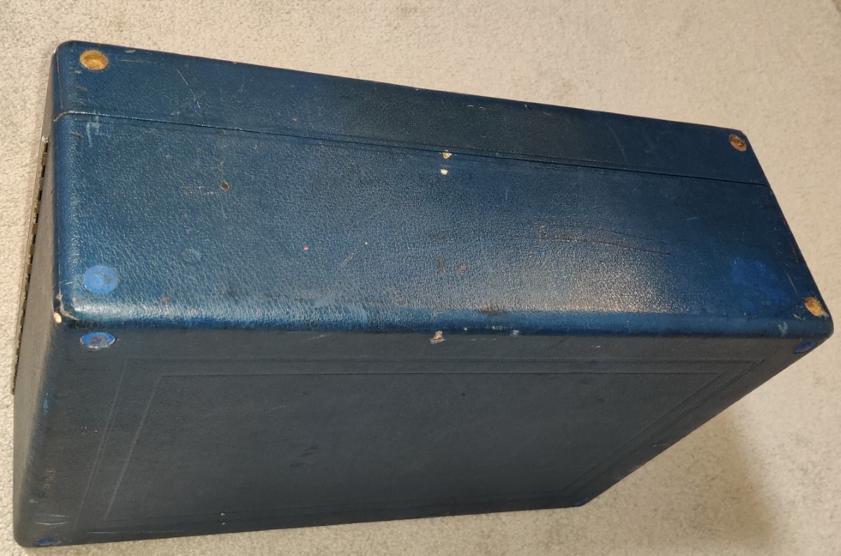

A few questions about the buffer feet pads.
I assume these pads are unique to models without metal corner shields.
What are they made of, and does anyone have a pic of one removed? The ones on the side are hard and the ones on the bottom are soft (rubber?).
I have three on the side that have fallen out. I don't want to damage the last one by trying to remove it.

Thanks for the various suggestions. Does anyone have a pic of what an original plug would have looked like?

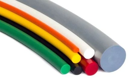

Another option for feet might be silicone rubber cord cut into foot-sized segments.
The cord comes in a variety of sizes and colours and can be custom made for colour and size. The problem is the size of order required.
The US manufacturer below sells their stock red/orange-ish cord in their retail shop in 100' lengths. That's a lot HMV 102 feet in an inappropriate colour.
https://www.accuraterubber.com/silicone ... ound-cord/
"Made out from finest quality material and craftsmanship, we stock & sale standard size silicone rubber cord and o ring cord in all regular sizes 1/16″, 3/32″, ⅛″, 3/16″, ¼″, 5/16″, ⅜″, 7/16″, ½″, ⅝″, ¾″, 1″ in 100 feet roll which you can buy using our online store. You can avail huge discounts for bulk volume order."
2024-02-04 09.11.29 www.accuraterubber.com cebedf19925c.jpg (14.69 KiB) Viewed 2633 times
There are also Indian and Chinese manufacturers.

Go to a hobby shop get some soft rubber that you can shape and bake. Its fun cheap and easy to do...
Burtemg
Posts: 42
Joined: Mon Mar 11, 2013 3:35 am
Re: HMV 102a buffer pads
Post by Burtemg »
Here is photo
This is it
This is it

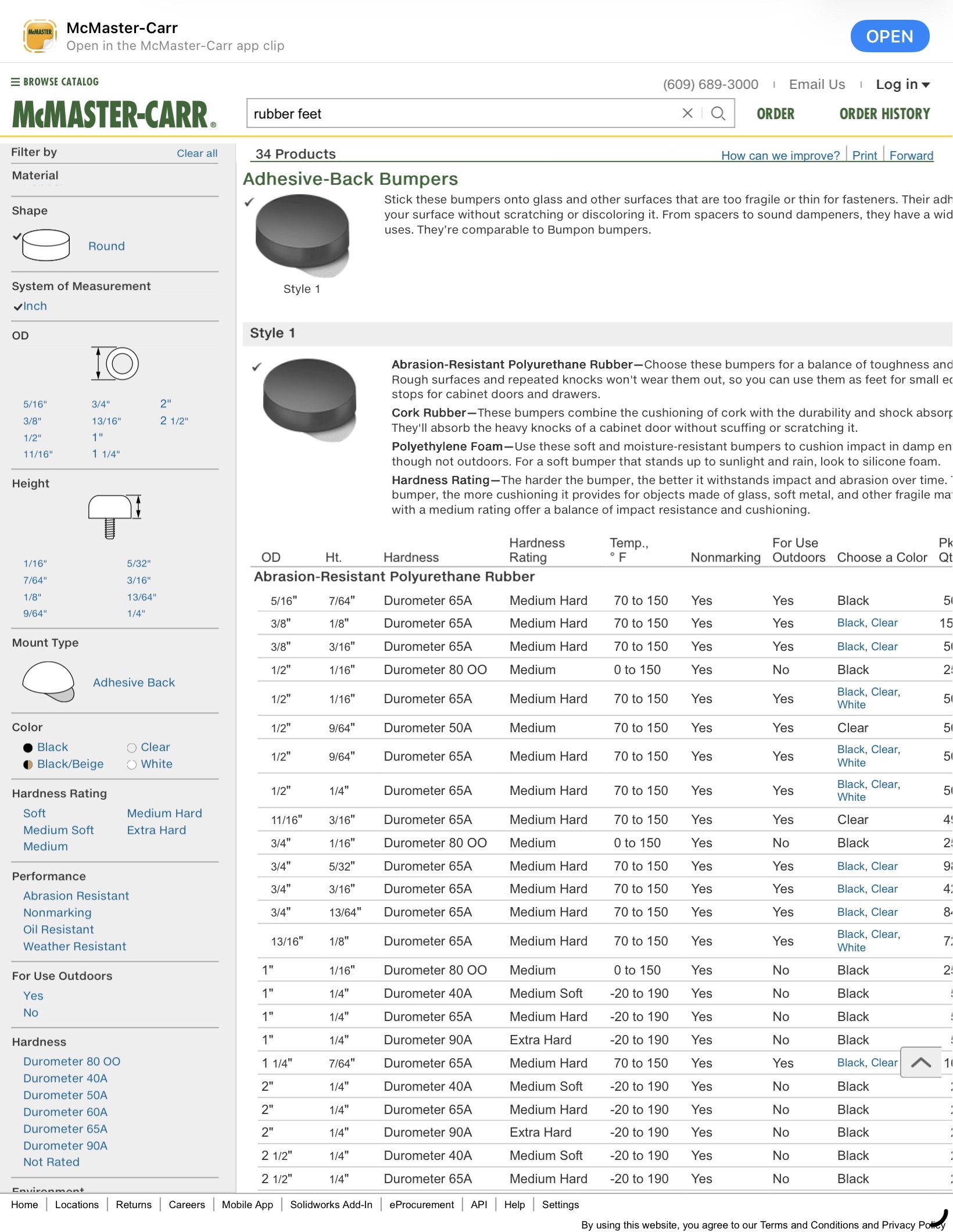

Industrial supply companies like McMaster-Carr sell a wide variety of round adhesive backed rubber bumpers. You may find a stock size in their inventory that would suit this application. What are the needed dimensions? These are inexpensive, pricing is on the website.
Mark
Here is the link and a partial screenshot.
https://www.mcmaster.com/products/feet/ ... ubber+feet
