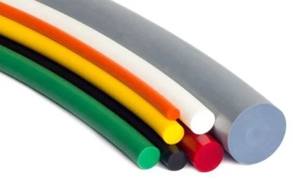

Another option for feet might be silicone rubber cord cut into foot-sized segments.
The cord comes in a variety of sizes and colours and can be custom made for colour and size. The problem is the size of order required.
The US manufacturer below sells their stock red/orange-ish cord in their retail shop in 100' lengths. That's a lot HMV 102 feet in an inappropriate colour.
https://www.accuraterubber.com/silicone ... ound-cord/
"Made out from finest quality material and craftsmanship, we stock & sale standard size silicone rubber cord and o ring cord in all regular sizes 1/16″, 3/32″, ⅛″, 3/16″, ¼″, 5/16″, ⅜″, 7/16″, ½″, ⅝″, ¾″, 1″ in 100 feet roll which you can buy using our online store. You can avail huge discounts for bulk volume order."
2024-02-04 09.11.29 www.accuraterubber.com cebedf19925c.jpg (14.69 KiB) Viewed 2632 times
There are also Indian and Chinese manufacturers.
