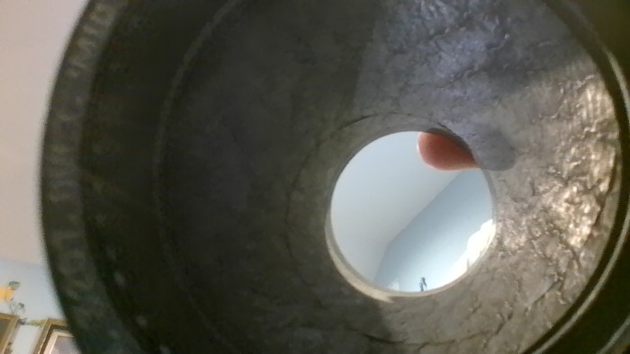

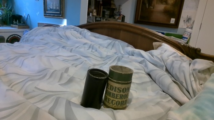

Re: I have a question about a indestructible cylinder
this is the inside also a photo of the outside,
The pictures aren't particularly clear but it looks to be a US Everlasting cylinder manufactured by the US Phonograph Company of Cleveland Ohio. These are interesting cylinders which have a cardboard-type filler, which is what your bottom picture seems to show.
As these cylinder can suffer from serious shrinkage over the years, I'm surprised it is "too big" for your Amberola 30. Do you mean it won't fit on to the mandrel or that it slides on the very left hand end but doesn't grip at all? If the latter, it might mean that some one has had a go at reaming it somehow but has gone too far.
As Tim states, the problem is usually that they're too tight due to shrinkage, or due to the cardboard getting damp and swelling. The reason I asked for pictures was to determine if the metal ring was still present in the small end of the cylinder. Does that ring happen to be split? It shouldn't be. Maybe someone has jammed to cylinder onto the mandrel too far and split the metal ring open?
it would be good to see what you mean with a photo of it on the machine ( front and end view ). In effect it looks as if the card inside has expanded due to damp and this means that the cylinder wont go on to the mandrel far enough to engage the title end metal ring and so will drop at the title end i.e. be an apparent loose fit.
Most collectors describe a loose cylinder as one that goes too far on to the mandrel without gripping in wax or plaster filled cylinders this would be termed over reamed, this is not an effect the is possible with these cylinders unless one or bot of the metal rings have been removed
