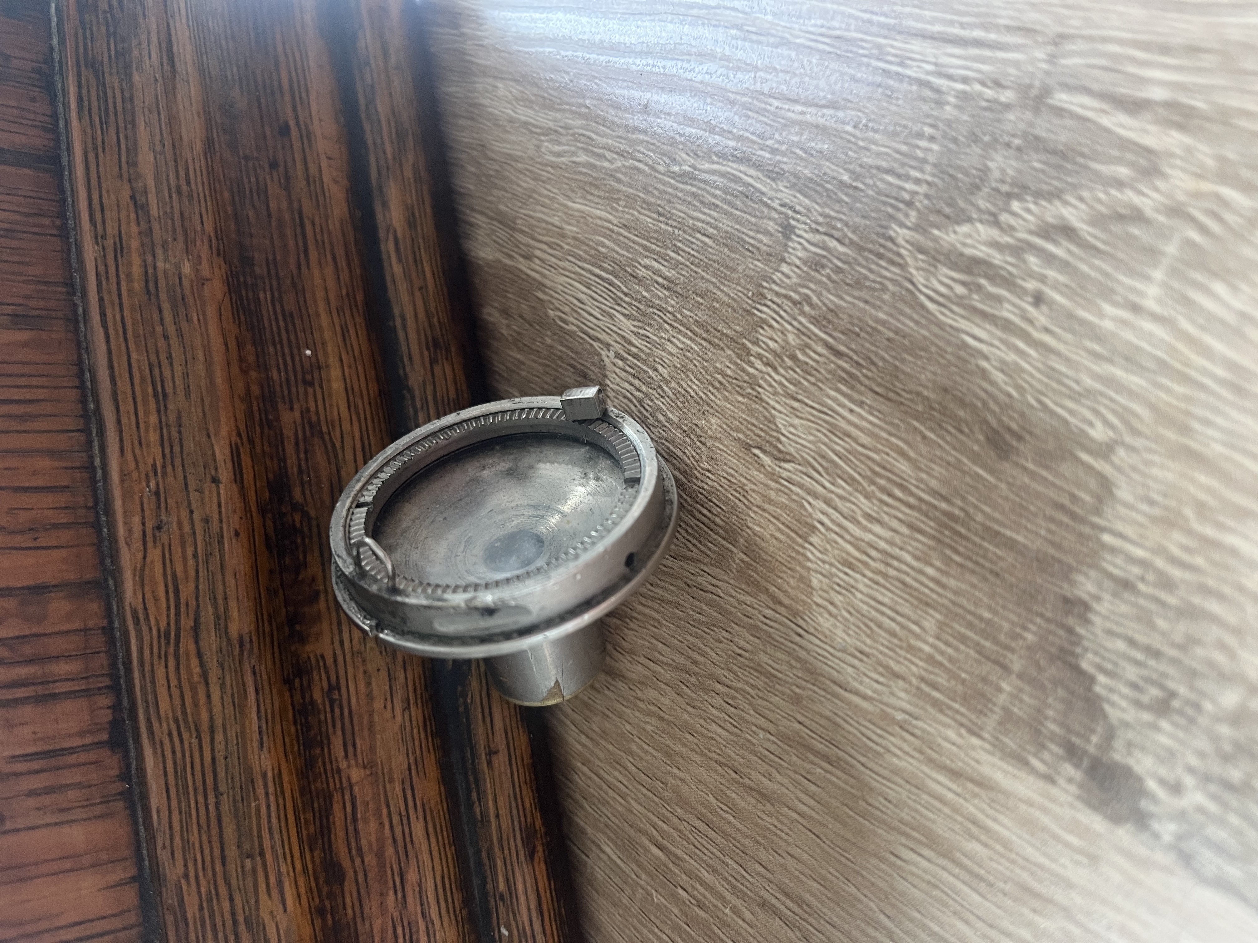

Thank you for your prompt replies, you were spot on the brass wheel was a little stiff which I have now resolved. I’m missing a piece of the reproducer could you guys point me in the right direction?

Missing something

Yup, something is missing for sure. I'd say your best bet might be to buy a reproducer off of eBay, or place a "wanted" ad here, viewforum.php?f=9 on the forum "Yankee Trader" classified section. What you want is a "Model C" reproducer. What you have can be sold for a few bucks to help you out.
This one looks like a decent example. Rebuilt and a pretty fair price. https://www.ebay.com/itm/196271263846?i ... R_bL7ujDYw
