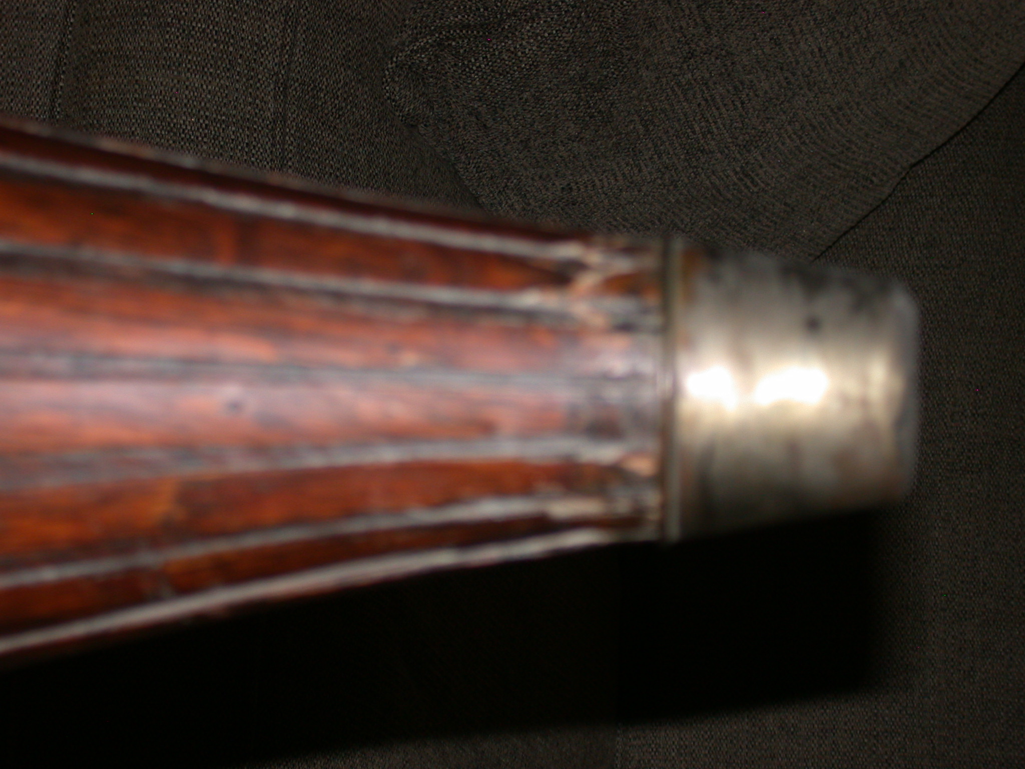

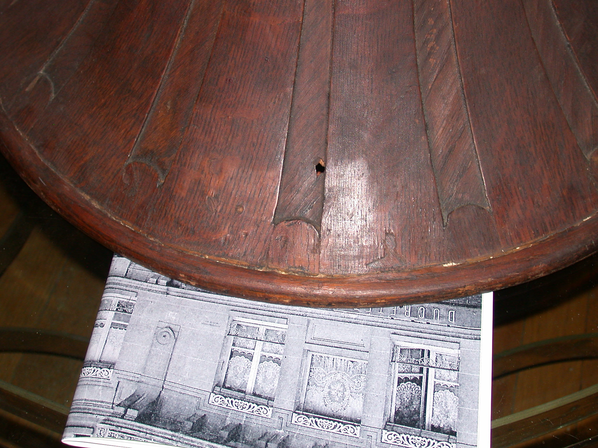

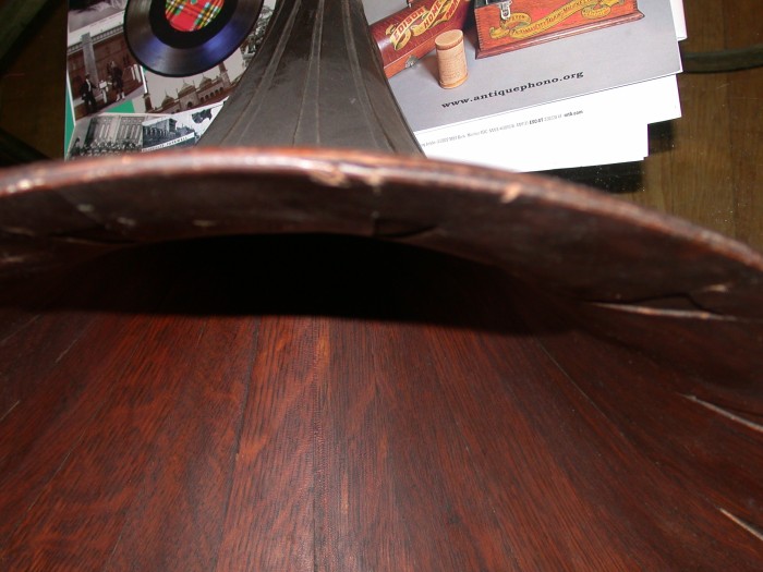

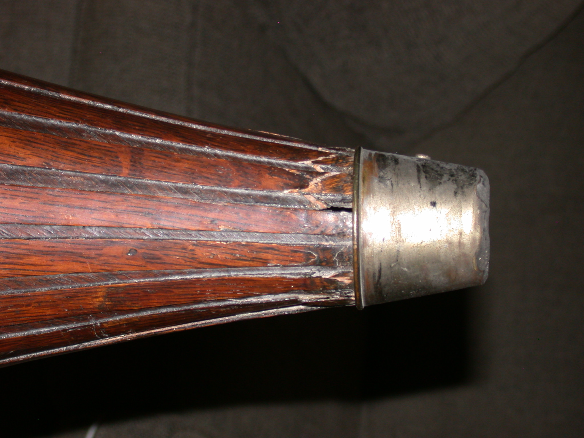

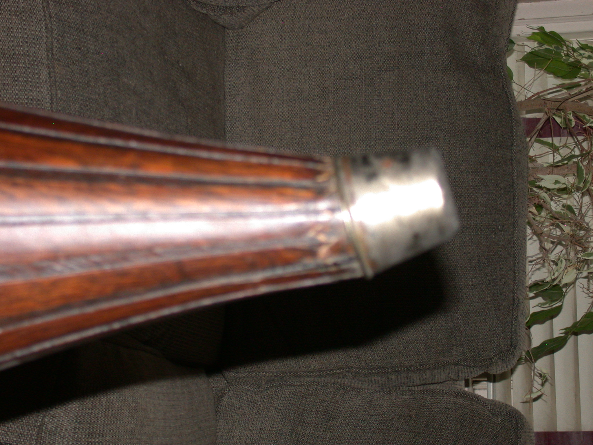

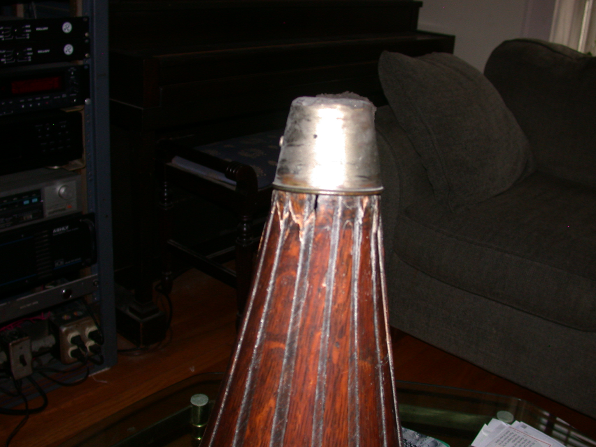

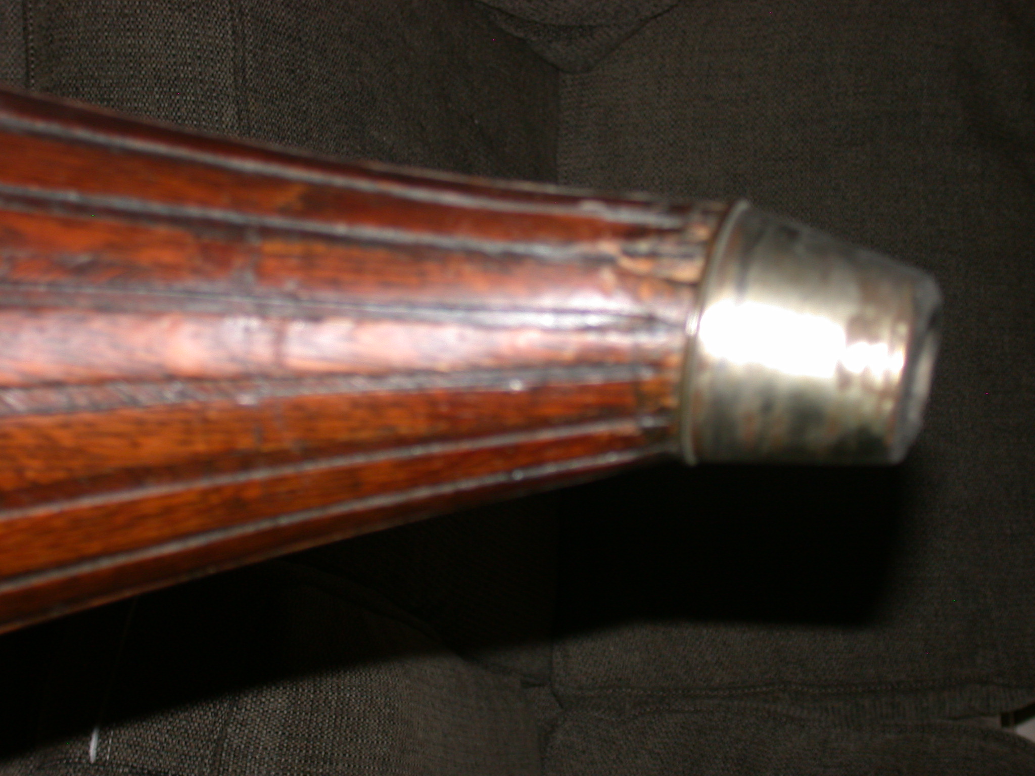

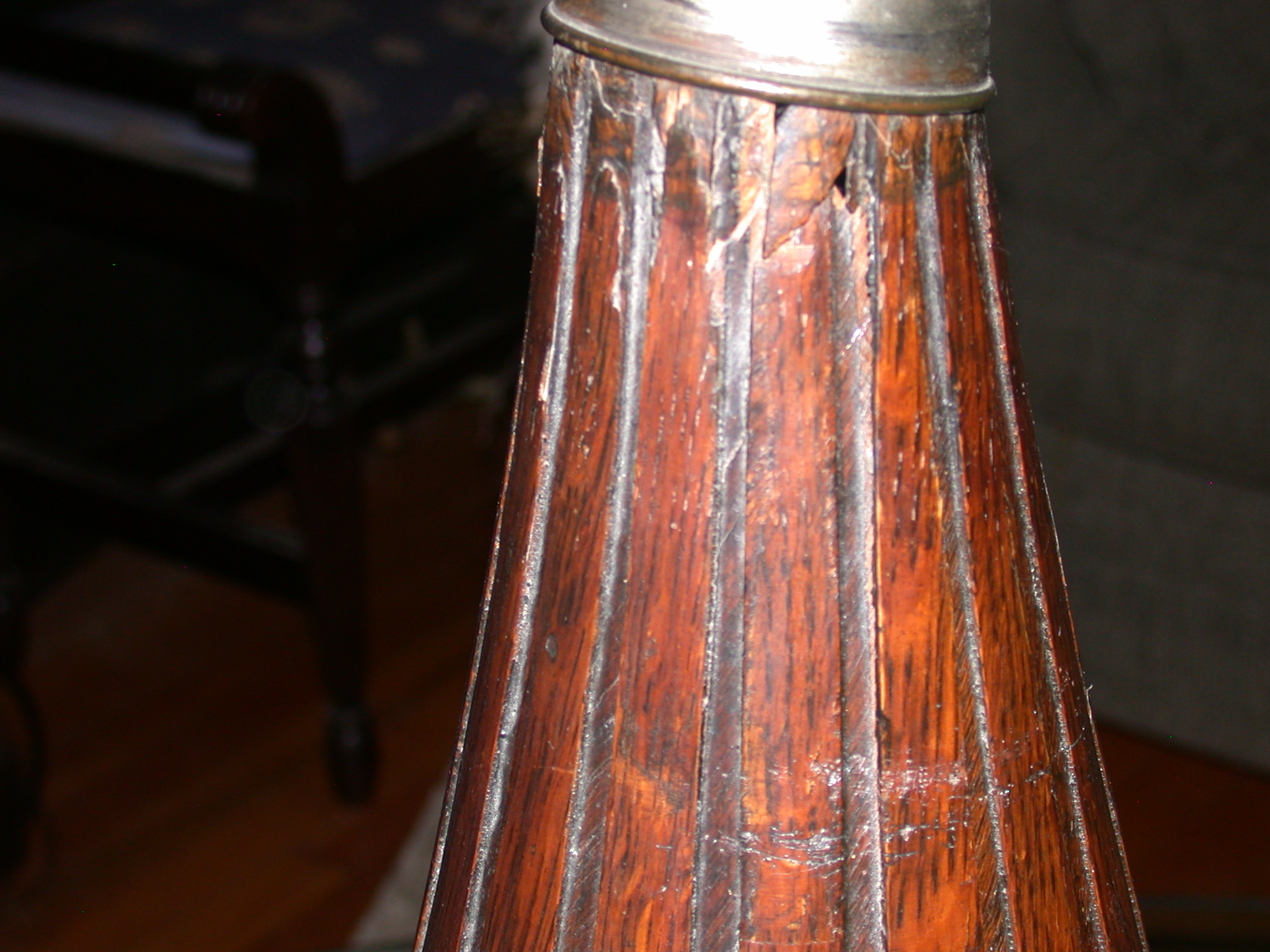

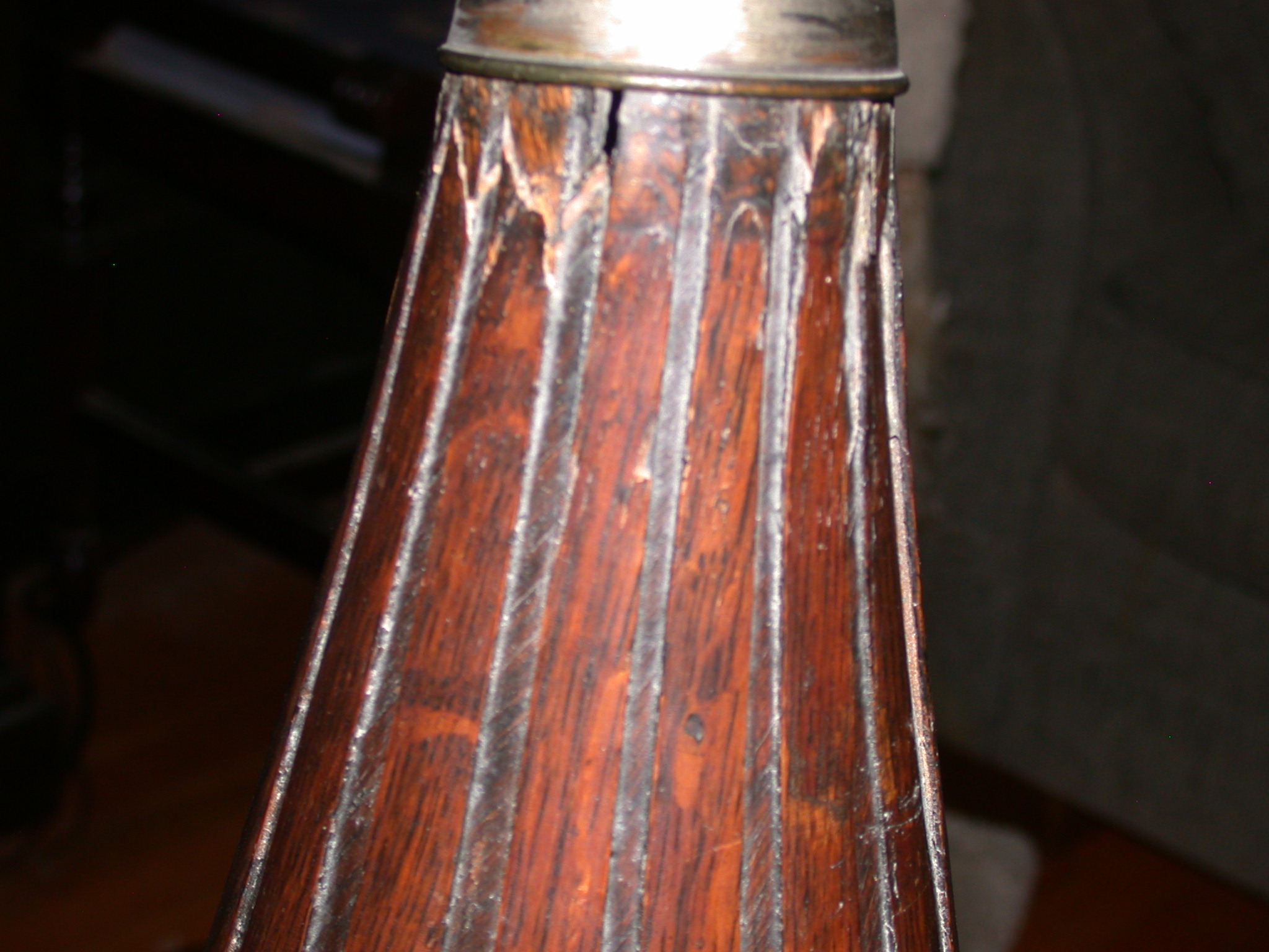

Here are some pictures showing their condition. The damage on one is almost invisible to the eye but shows as a small gap at the horn/coupling junction and a small hole in one segment.
The other is very obvious. I believe the wood is all there, but is fractured at the top.
The first 3 ought to be the one less damaged. The remainder ought to be the worse example.
Thanks Again, And Best Wishes !

Oh dear- 060 is not part of the less damaged horn.

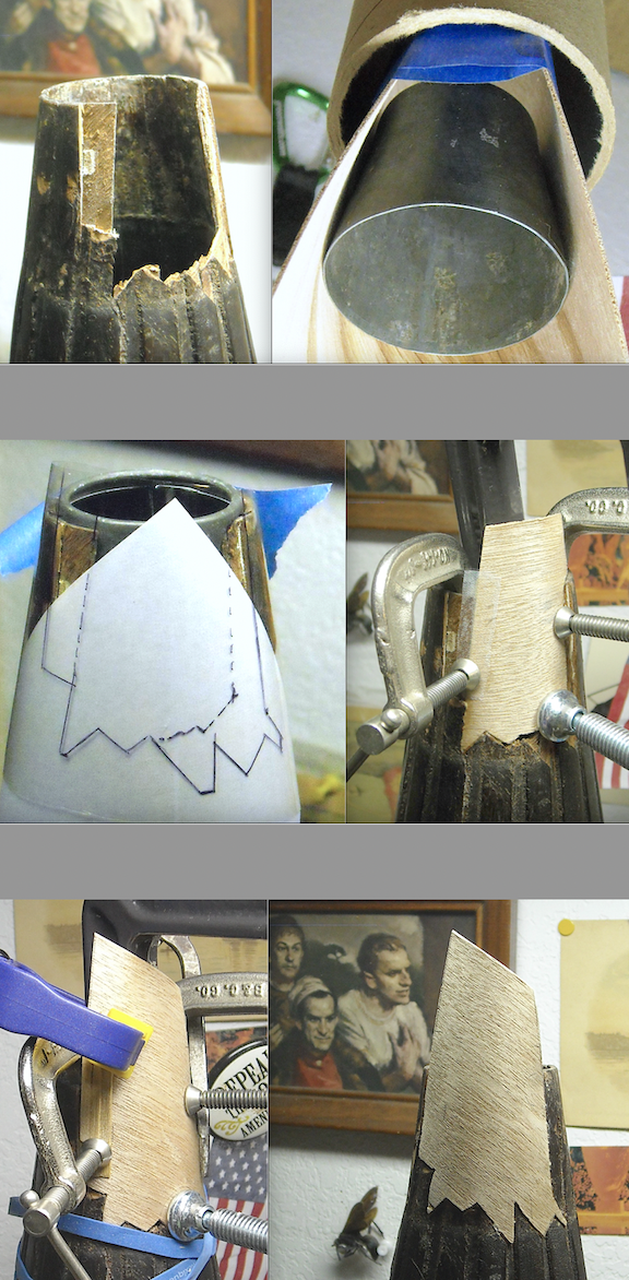

I fix a horn and I had never worked on one before, so it can be done. Lucky for me the damage was under the end cap and the cap was off the horn. In addition, some loose veneer needed gluing beyond that area. After replacing the two missing layers of wood, I glue the outer and inner caps to the horn. It's rock solid again.
James.

I'll share what I've done. It came out very nice, but you'll have to judge if it's the right method for you.
The sleeve on my horn was loose and bent, maybe not as bad as yours. I was able to push the sleeve into the proper position. With the sleeve held in its proper place, I turned the horn upright, (big end facing up). I also put a bit of putty at the seam between the inner and outer sleeves, to make a seal. With the horn in that position, I injected a thin, liquid epoxy into the sleeve. At the time, the epoxy product was known as Kwik-Poly, (no longer available). It was a nearly water-like in its consistency and was made to penetrate wood and to fill voids. With a syringe, I injected just enough to fill the sleeve to its edge. I let it dry overnight and had a solid, invisible repair.
There are several epoxy products currently available that should work equally as well. I have used West Systems products... https://www.westsystem.com/
I called them and explained exactly what I needed to do. They were very helpful and recommended and excellent product, (not for the horn in this case).
Others have recommended this product. It looks very promising. You basically want to fill the sleeve and bond it to the wood while also joining any broken fragments within.
https://www.abatron.com/product/liquidw ... -hardener/
Whatever method you use, be careful and deliberate as you proceed because whatever you do will be permanent.

I have two theories on how Victor assembled the horn sleeves. There is an inner and an outer sleeve. The two are joined by a rolled and crimped joint at the end of the sleeve. My first theory is that the inner & outer are crimped together before joining to the wood. The inner sleeves appear to be zinc, while the outers are brass. My thought is that the inner sleeve is initially not tapered when it's joined to the outer. This allows the sleeve assembly to be slipped over the end of the wood horn. Then, a tapered form tool is pressed into the inner sleeve, expanding it tightly against the wood, thereby clamping the sleeve in place. The relatively soft zinc should allow for this expansion. My second theory is that the inner and outer sleeves are crimped together after each are installed on the wood horn. I believe the first method would produce the tighter joint. As I stated, these are my theories, (call them guesses if you like).pallophotophone wrote: Mon Mar 18, 2024 3:28 pm

Either way, the sleeves are not easily removed without some level of destruction involved.
