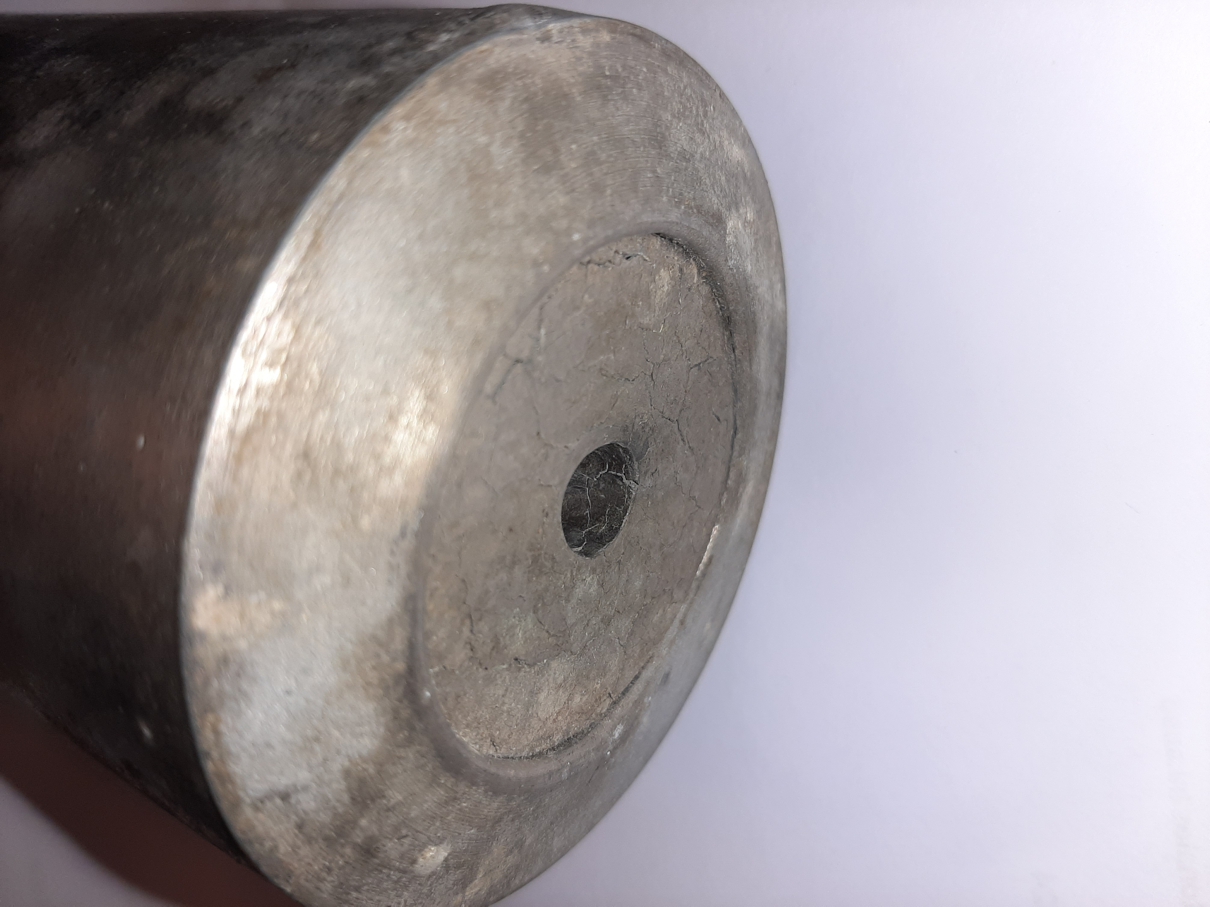

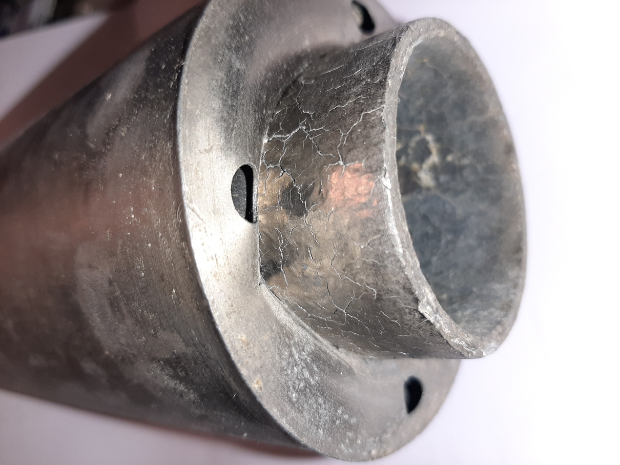

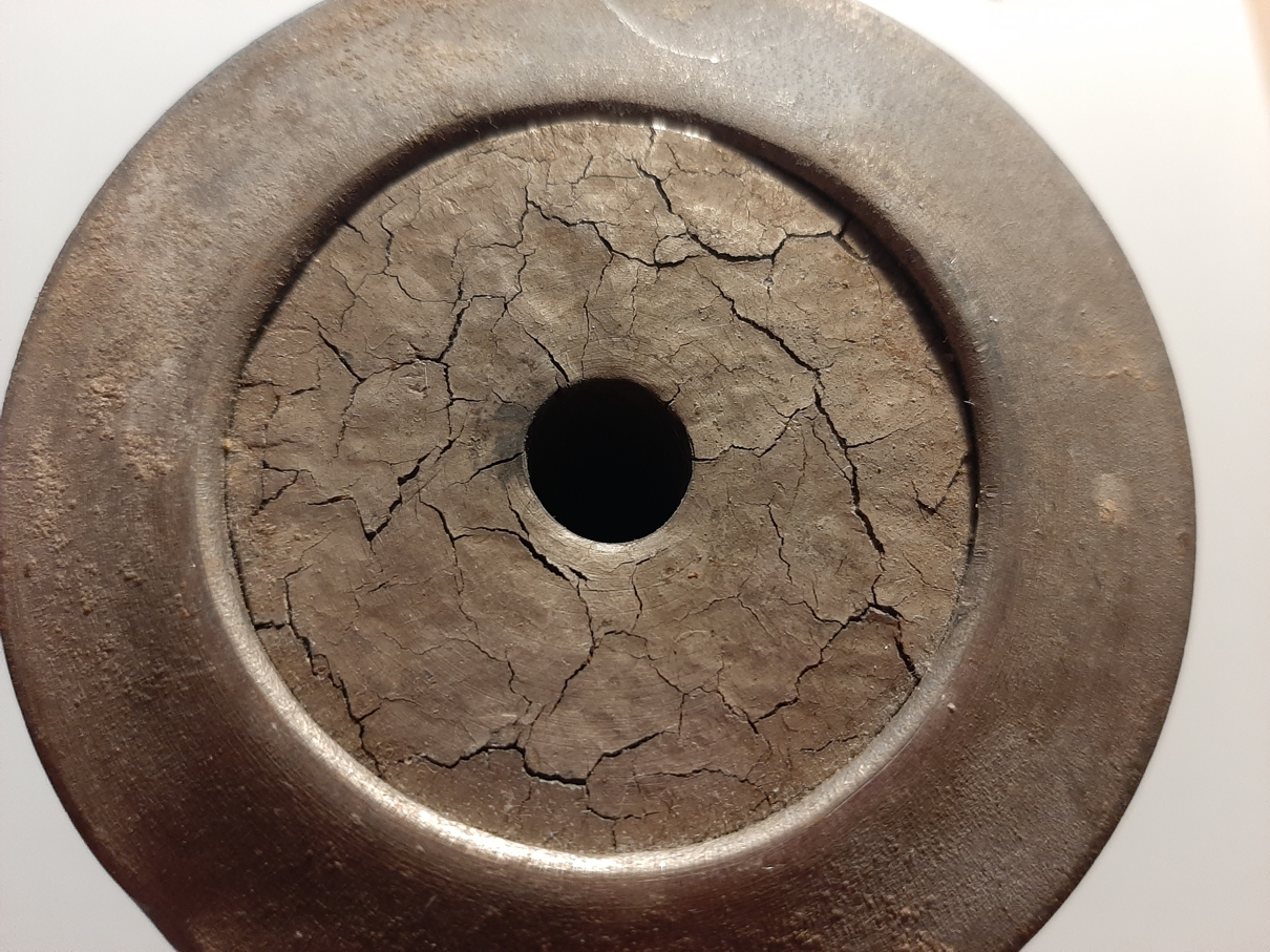

- Posts: 757
Re: Help Mandrel size query
A photo of your excelsior would be a great help. Some metals do change size. The most extreme are mandrels of pot-metal. Here an example of a Pathé mandrel. As one can see the degratation of the mandrel has expansion power as it has deformed the steel slip-on mandrel.
- Posts: 199
- Joined: Mon Mar 25, 2019 11:50 am
Metal Expansion
Thanks for the photos of the mandrel deterioration and evident expansion. The comparison with the steel is interesting and significant and plausibly confirming a fairly high percentage change in the mandrel size when made in these materials.
