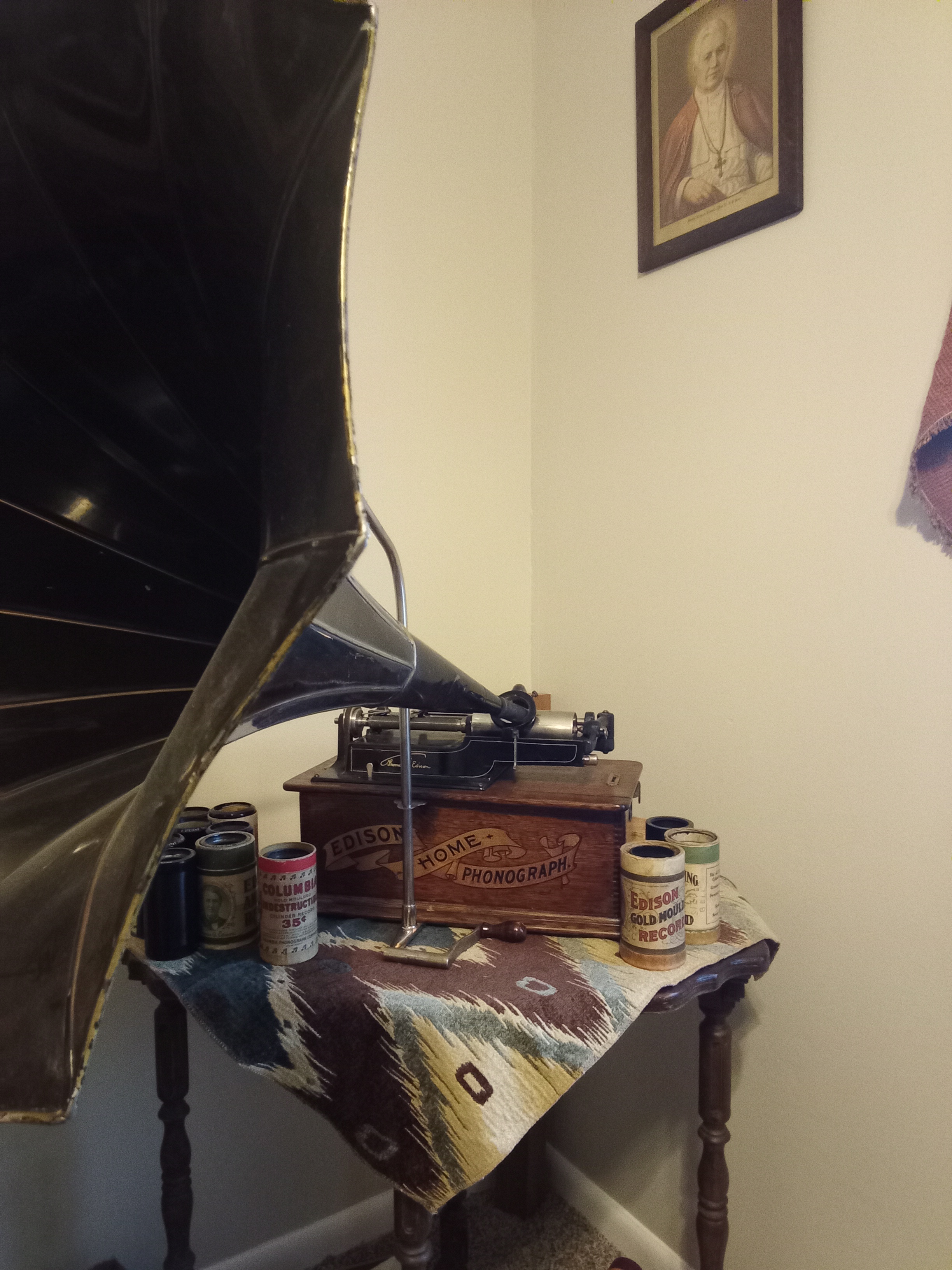

Home B for reference. Sitting on a radio table from the 1920s in the corner of my library/office/record mausoleum/disaster area as Pope Pius X looks on disapprovingly from his lithograph on the wall. I recommend antique prints as you can acquire a king, president, pope, movie star, mythological figure, or anyone really for about ten dollars. On the radio people who have "bought a congressman" have to pay lots more and and Emily Post would say it's not nice stapling them to the wall for decoration.
