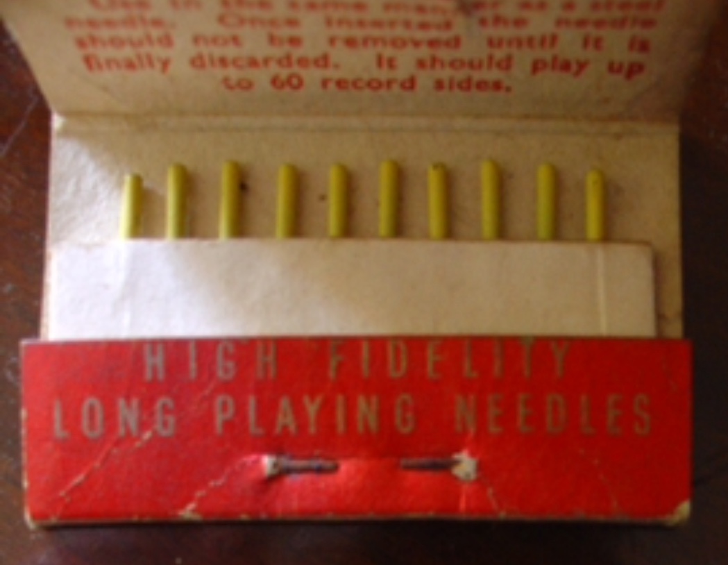

Posts: 5783
Re: What are these painted needles?
The yellow painted needles are HMV "Long Playing". I would not let them anywhere near my records.
hmv lp f.jpg (46.43 KiB) Viewed 765 times

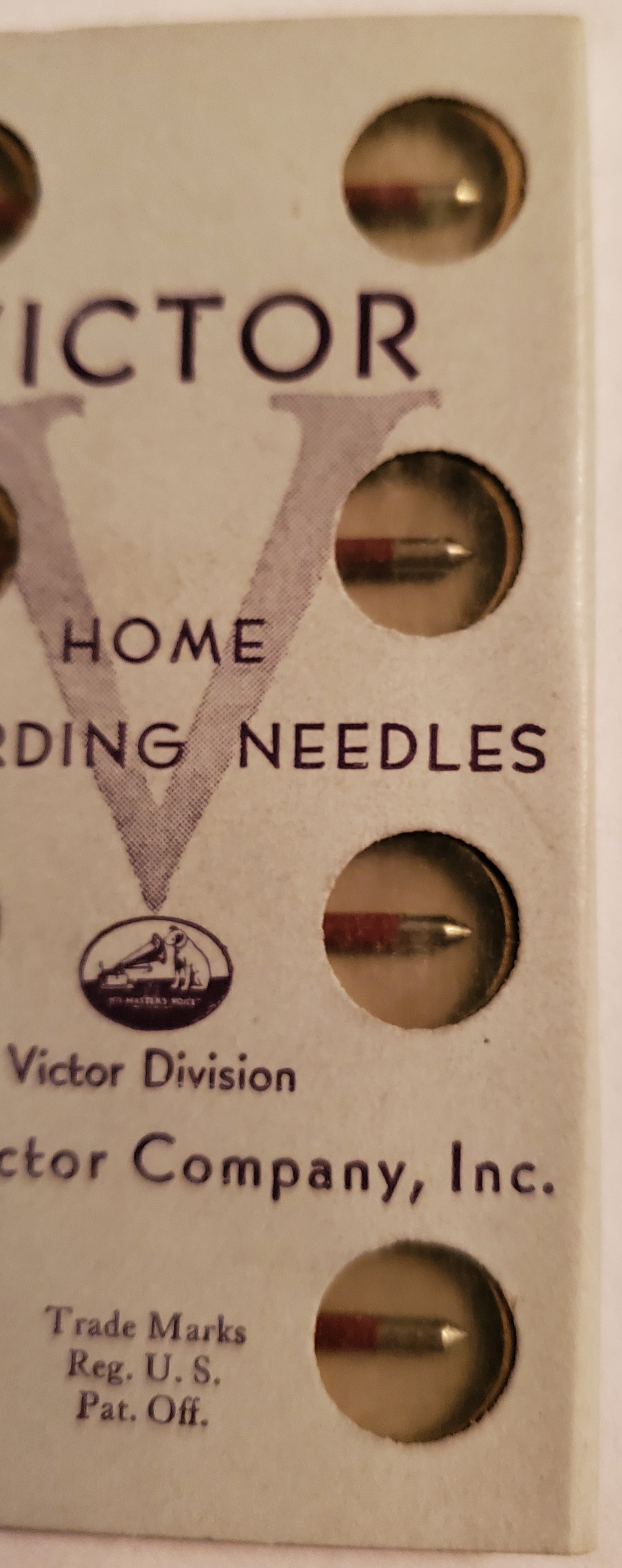

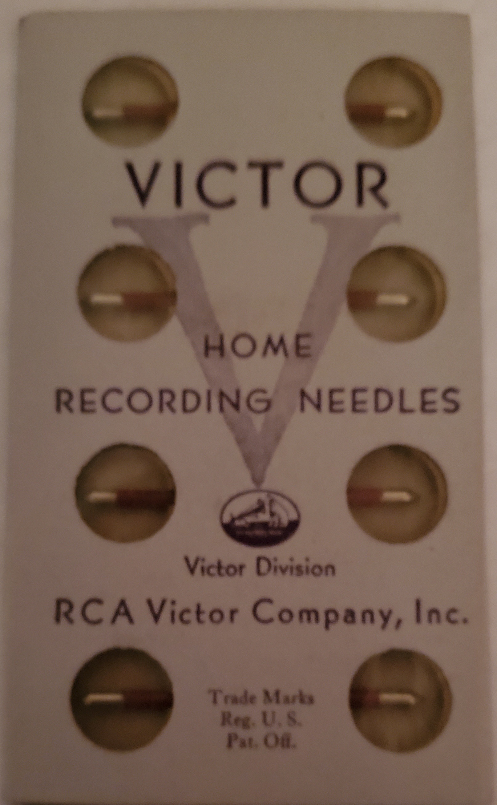

ChesterCheetah18
Posts: 457
Post by ChesterCheetah18 »
The tips are rather blunt. From my experience they look like Victor Home Recording needles, the red one being earlier and the yellow ones being the later "New Style". Here in the U.S. the Chromium Long Play (Program Transcription) needles were orange.
