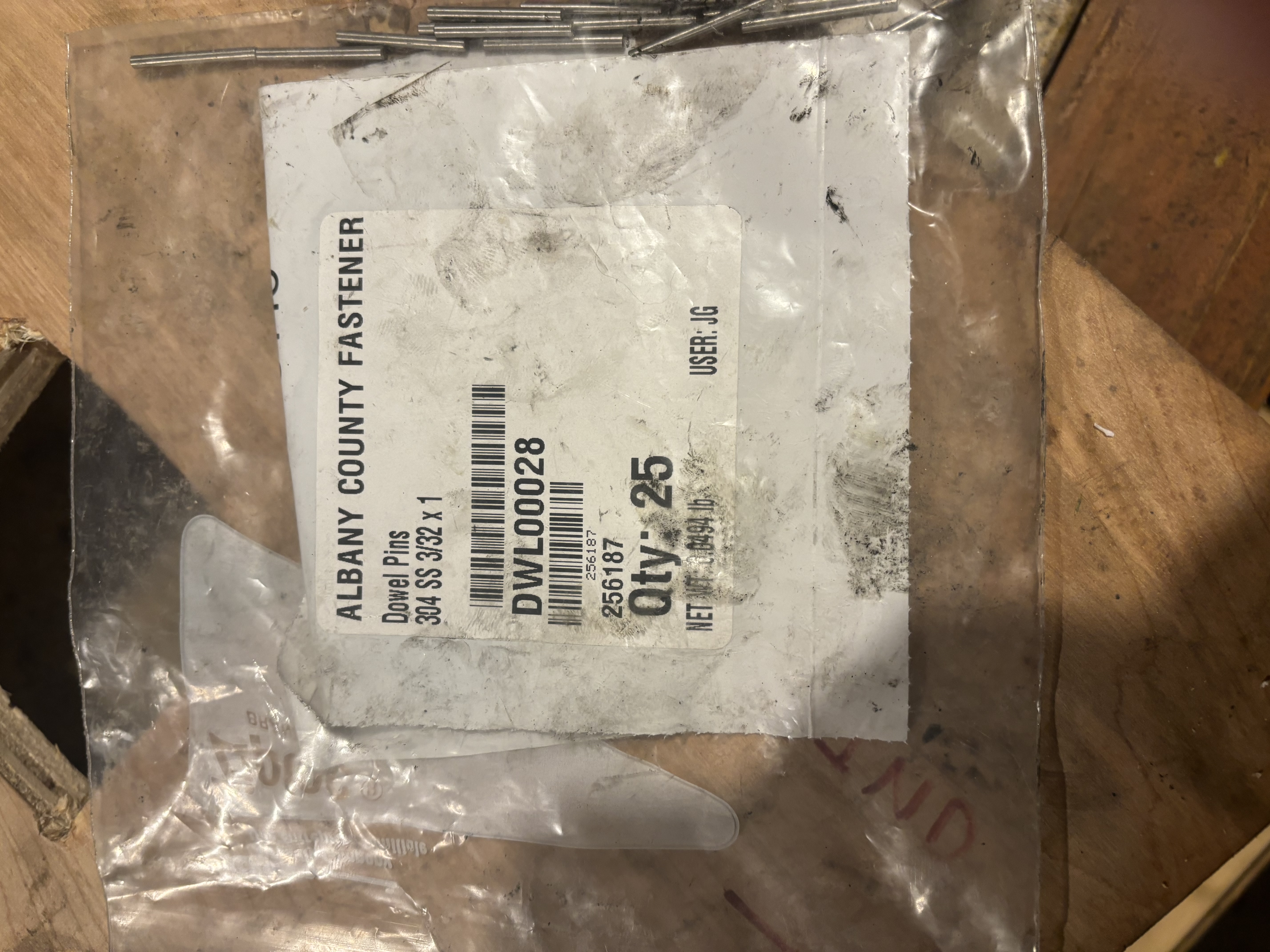

I’ve replaced two such pins before, and would also not recommend that you use piano. You need a 3/32 steel pin made of 304 steel. Would recommend Albany county fastener as a supplier from whom you can purchase online
- Posts: 125
- Joined: Tue Feb 27, 2024 8:05 pm
- Personal Text: If your Victrola predates the Model T, it’s a good thing!
- Location: Kentucky
Re: Drive pin or shear pin ?
3/32 x 1 inch to be exact. I may have shaved a tiny bit of the length off when I got them, but I don’t know that it’s absolutely necessary.

Actually.,, I have a few extra pins. Assuming you are in the US, if you send me your name and address via private message, I can drop a couple of pins in the mail to you…. No charge.
