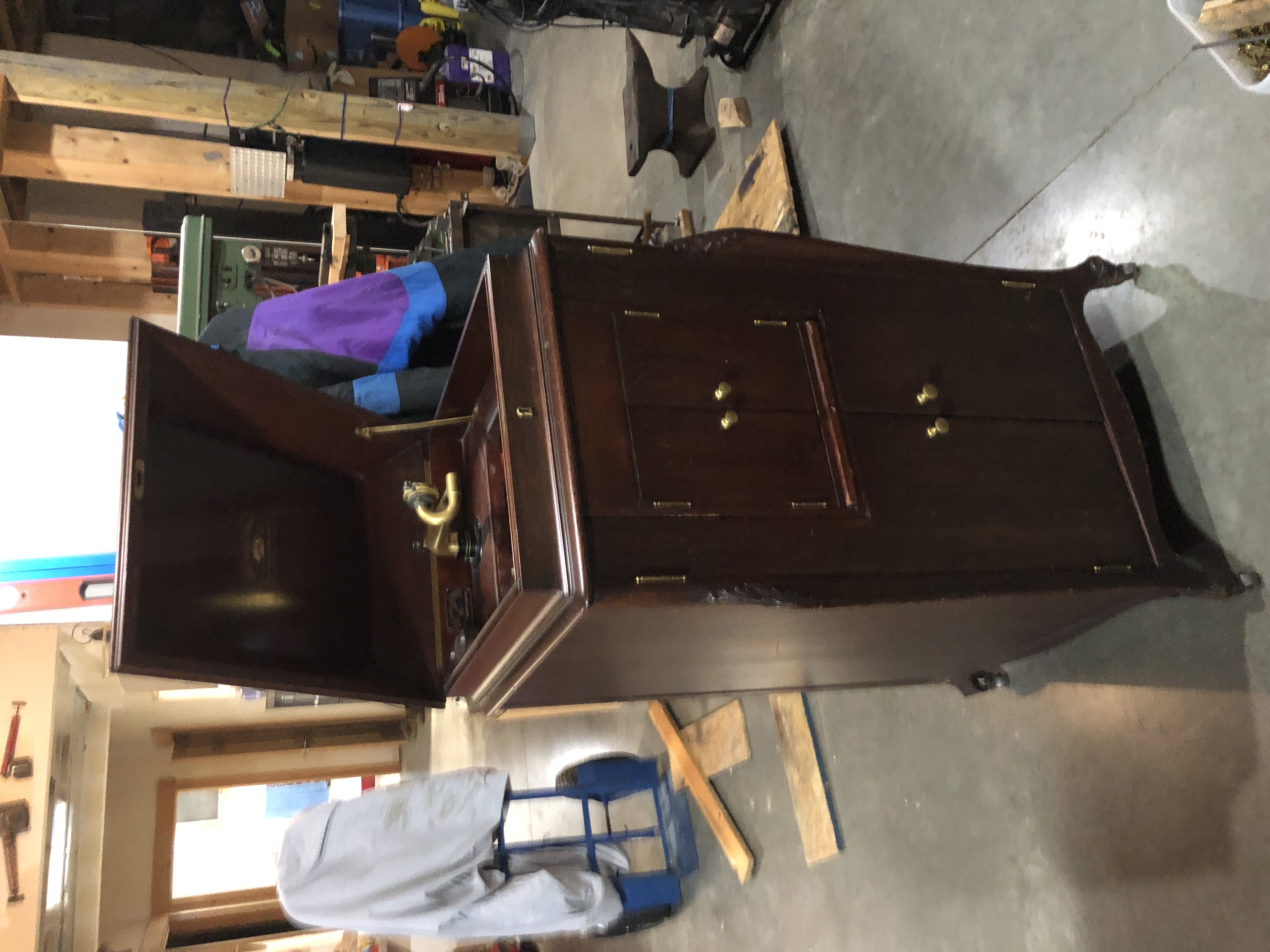

Sooo ... I got the motor apart and back together ... repacked all three springs. Seems to work great. Everything cleaned and oiled ... RPM's holding steady (checked with a strobe).
I am just going to put the parts on order to rebuild the reproducer.
I need needles ..... I didn't know I had a choice!
Loud, medium, soft and spear point.
What am I looking for ???
Is there much of a difference ????
Also, I need a manual for this unit. I found a few scans online but not for this exact unit. Any idea where I can find one?

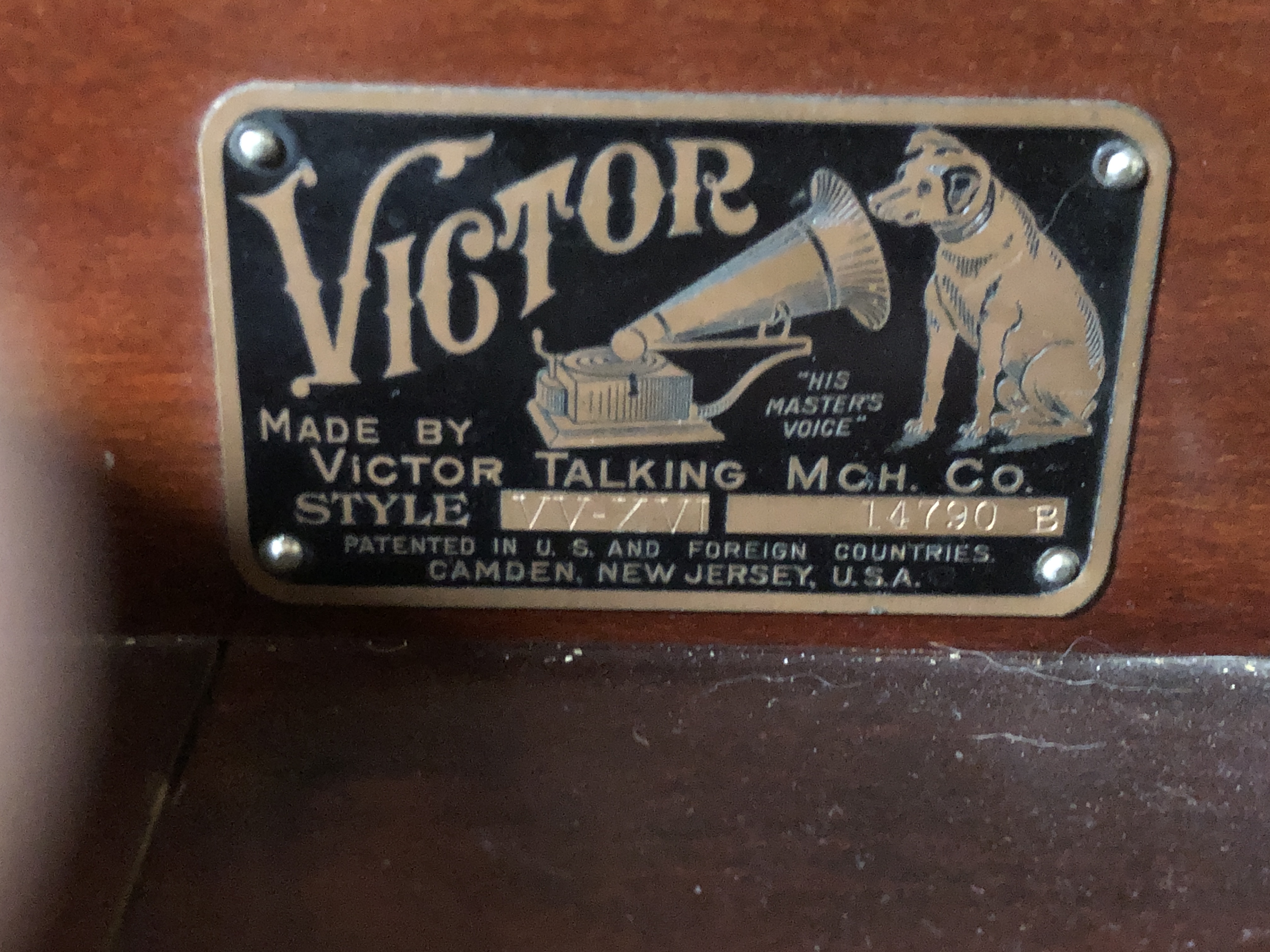

The unit is a Victor Victrola , VV-XVI, 1909, three spring motor, Exhibition Reproducer ... triangle hole for needle
