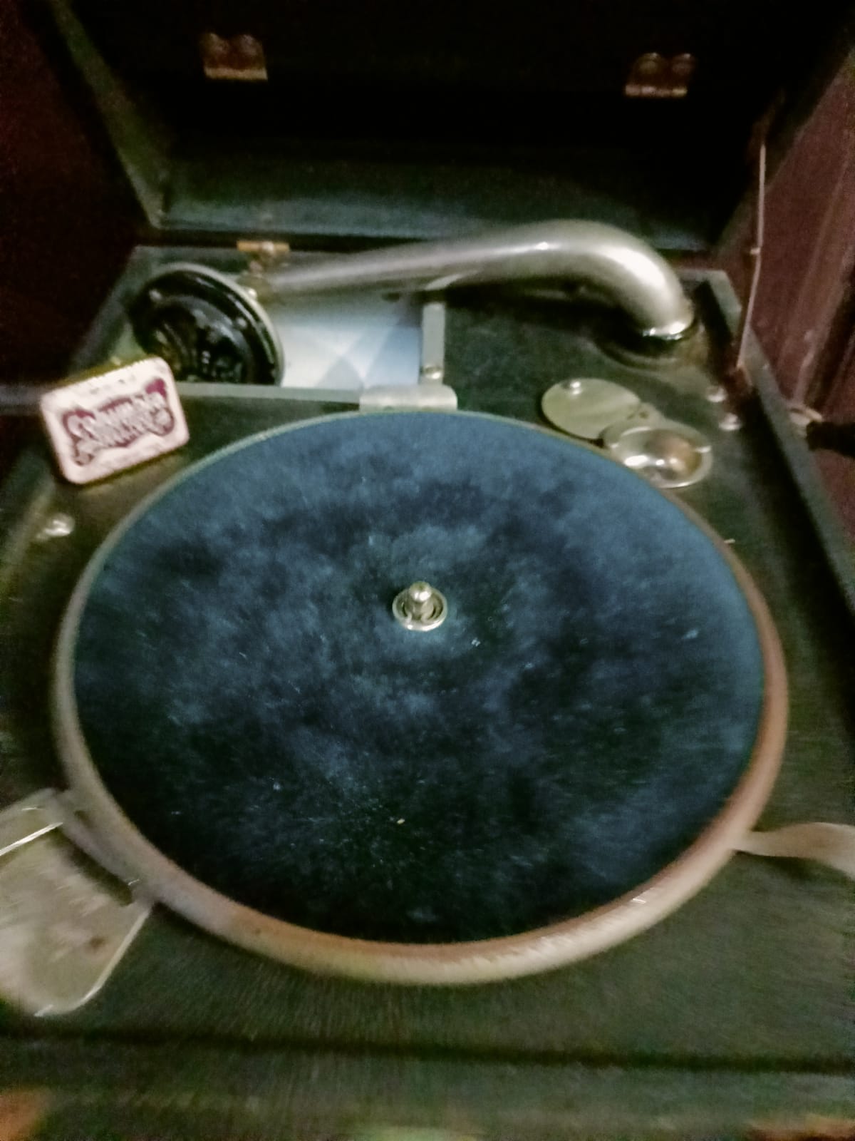

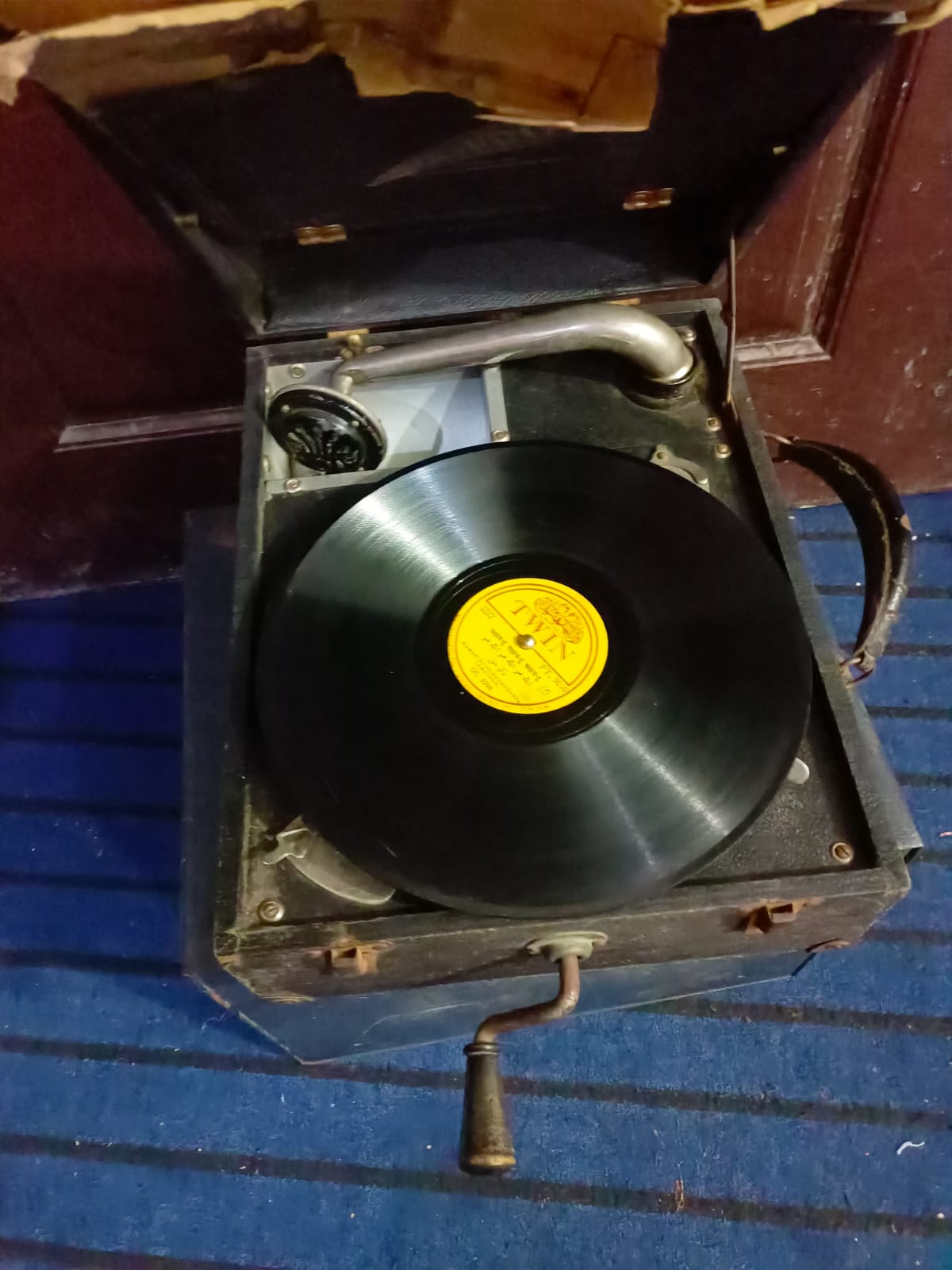

This afternoon I bought a Crescendo gramophone by Decca. Despite a couple of negative reviews about this model on the internet, the spring of the machine is still strong enough to completely play a record once fully wound up. The soundbox works well. The leather fabric despite some cracks on corners of the case is still intact. What do you think of it?

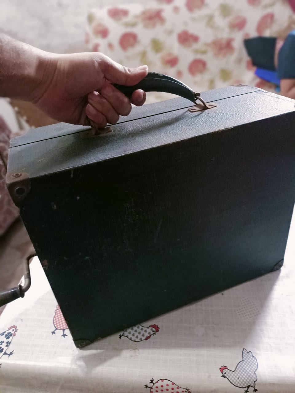

Hi Inigo ! Thanks for your very encouraging message. Please advise me on refurbishment of its leather paper/fabric skin. Should I get it repaired or replaced? Does the complete change of upholstery reduce the historic value of the machine? What is your suggestion?

Of course it's better to have an original repaired, or only cleaned, but showing its 'war wounds'... But the historical value of a cheap portable like this one, and also very common... today is small. I don't know what to think about the future... Of course the value of any machine will increase with age, if it is well preserved, because phonographs will tend to disappear. Who knows!

From the photos the machine looks in good shape, and I would not replace its fabric. Replacing the original finish always reduces the value of a gramophone. A good scrub with a damp cloth and light soap to remove old dust followed by applying shoe polish wax on the rexine-covered areas always helps to bring new life to these machines. And I am sure that after replacing the gasket of the soundbox the machine will sound nice, the Decca soundbox is a good one.Sherazhyder wrote: Mon Apr 15, 2024 3:47 pm Should I get it repaired or replaced? Does the complete change of upholstery reduce the historic value of the machine? What is your suggestion?

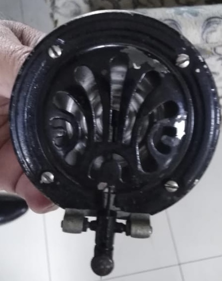

Hi Carlos! Thanks for your piece of advice, which I am going to zealously adhere to. I checked the soundbox it’s still airtight. The needle used to play the record as in the video was a worn out thing. I hope it will play well after oiling with a new needle.CarlosV wrote: Tue Apr 16, 2024 2:28 pmFrom the photos the machine looks in good shape, and I would not replace its fabric. Replacing the original finish always reduces the value of a gramophone. A good scrub with a damp cloth and light soap to remove old dust followed by applying shoe polish wax on the rexine-covered areas always helps to bring new life to these machines. And I am sure that after replacing the gasket of the soundbox the machine will sound nice, the Decca soundbox is a good one.Sherazhyder wrote: Mon Apr 15, 2024 3:47 pm Should I get it repaired or replaced? Does the complete change of upholstery reduce the historic value of the machine? What is your suggestion?

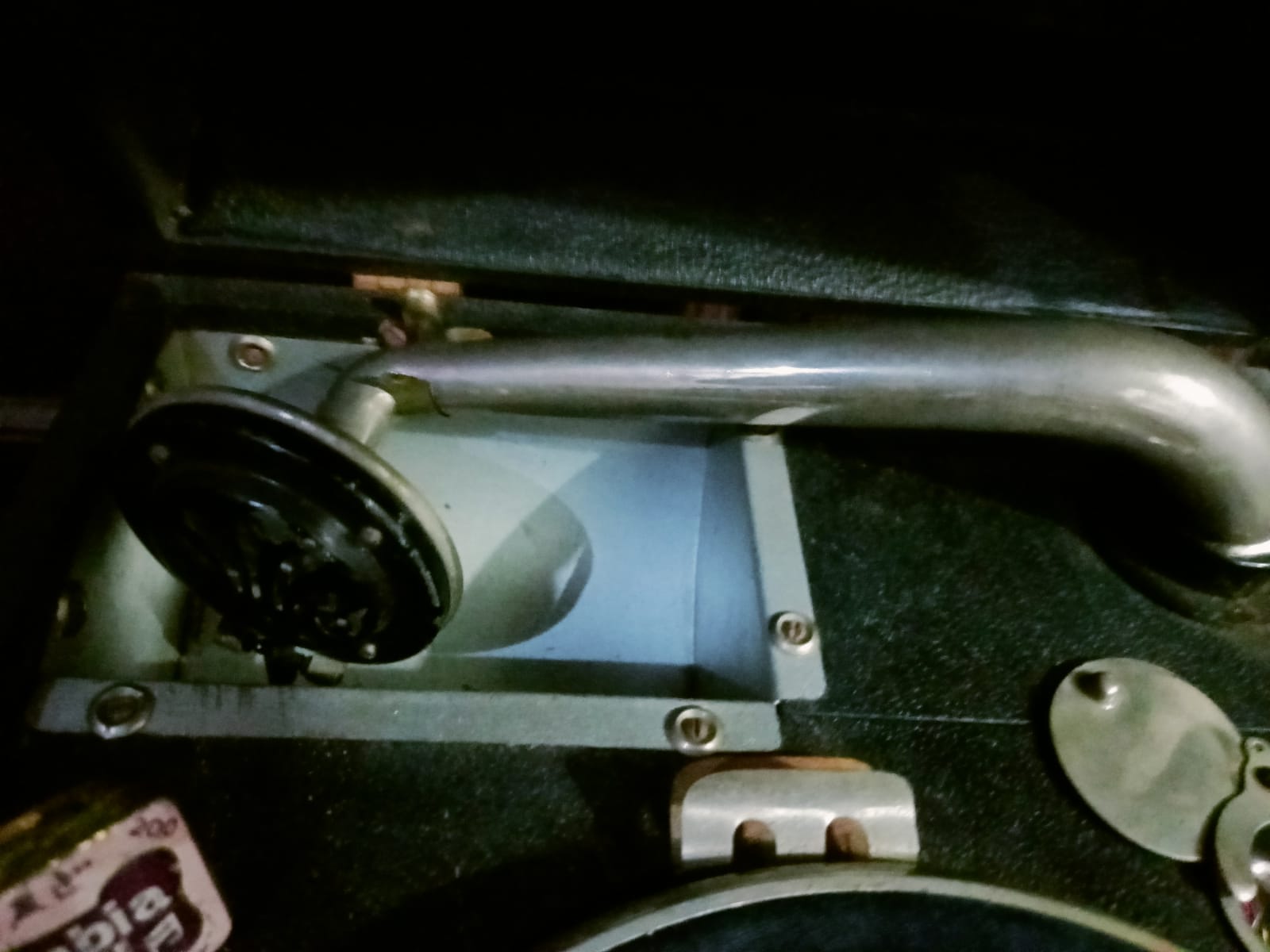

One thing is not understandable- the horn is the typical Decca design but painted in black. Ordinarily, the Decca soundbox in this design is in chromed metal. I guess the previous owner painted the chrome a long time back in the past.

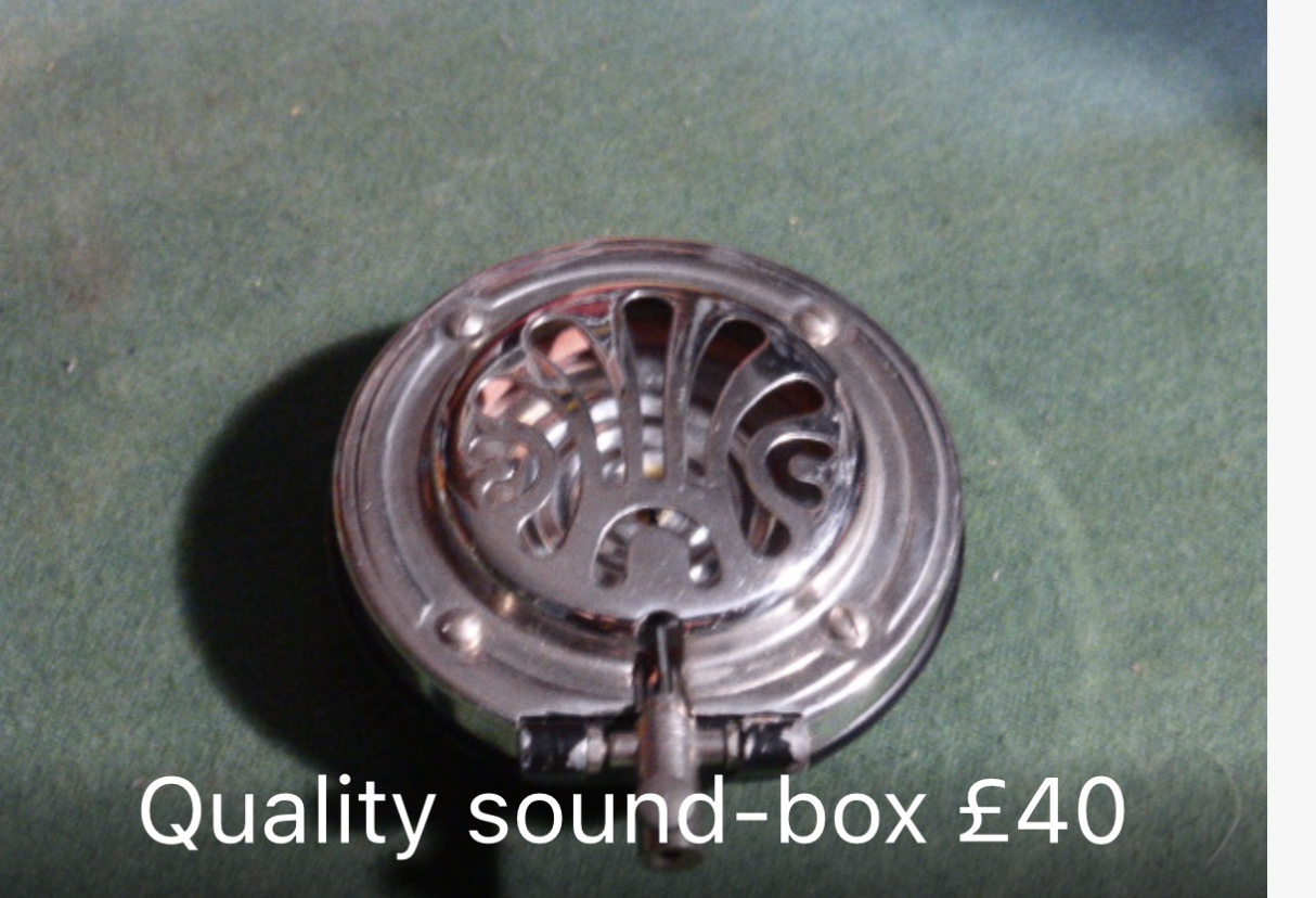

The black soundbox is on my machine and the other is the one I often see with Decca machines.

As the soundbox is also black, my guess is that the black painted horn is also original, possibly a version offered as alternative to the chrome one.
