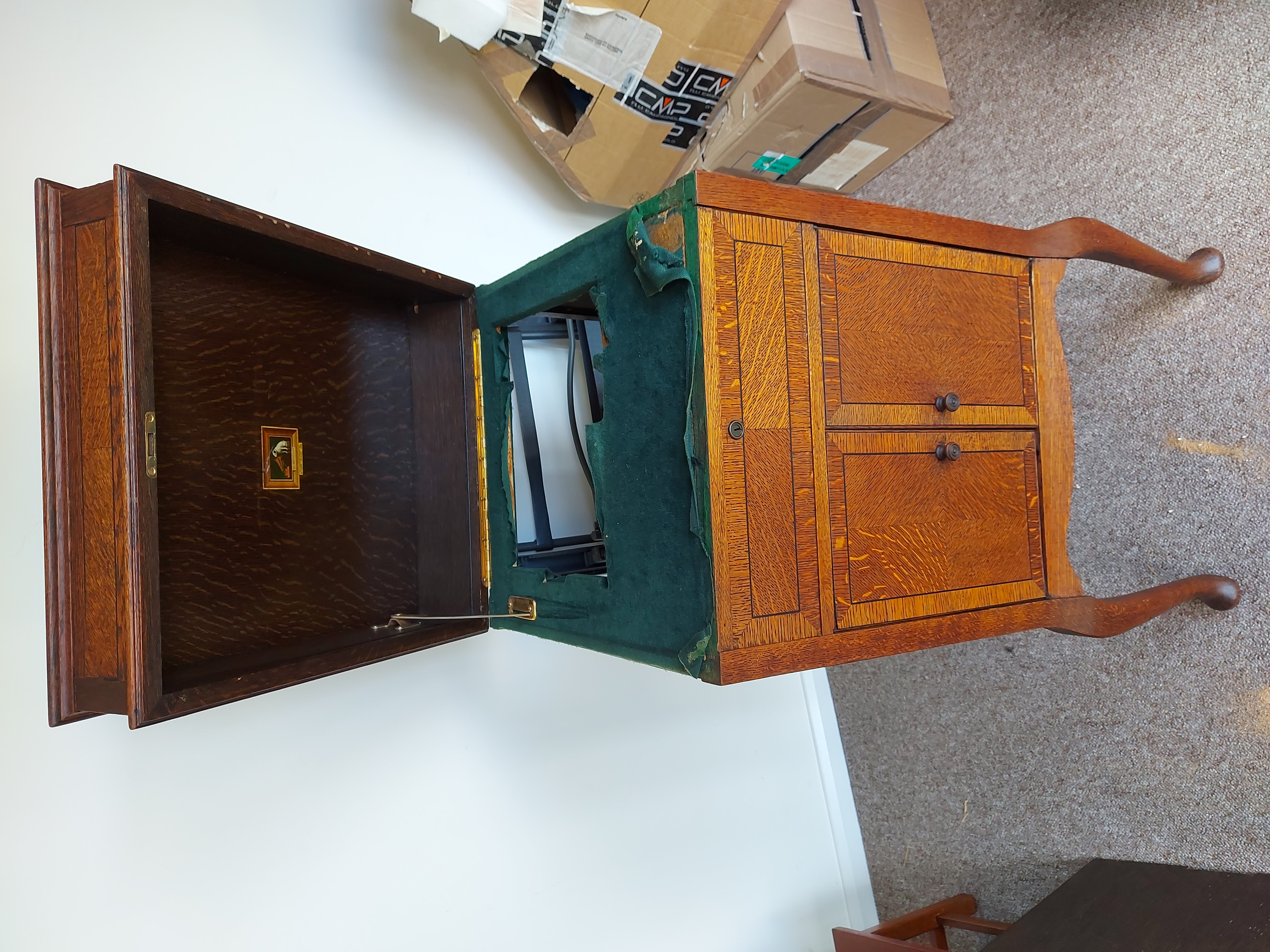

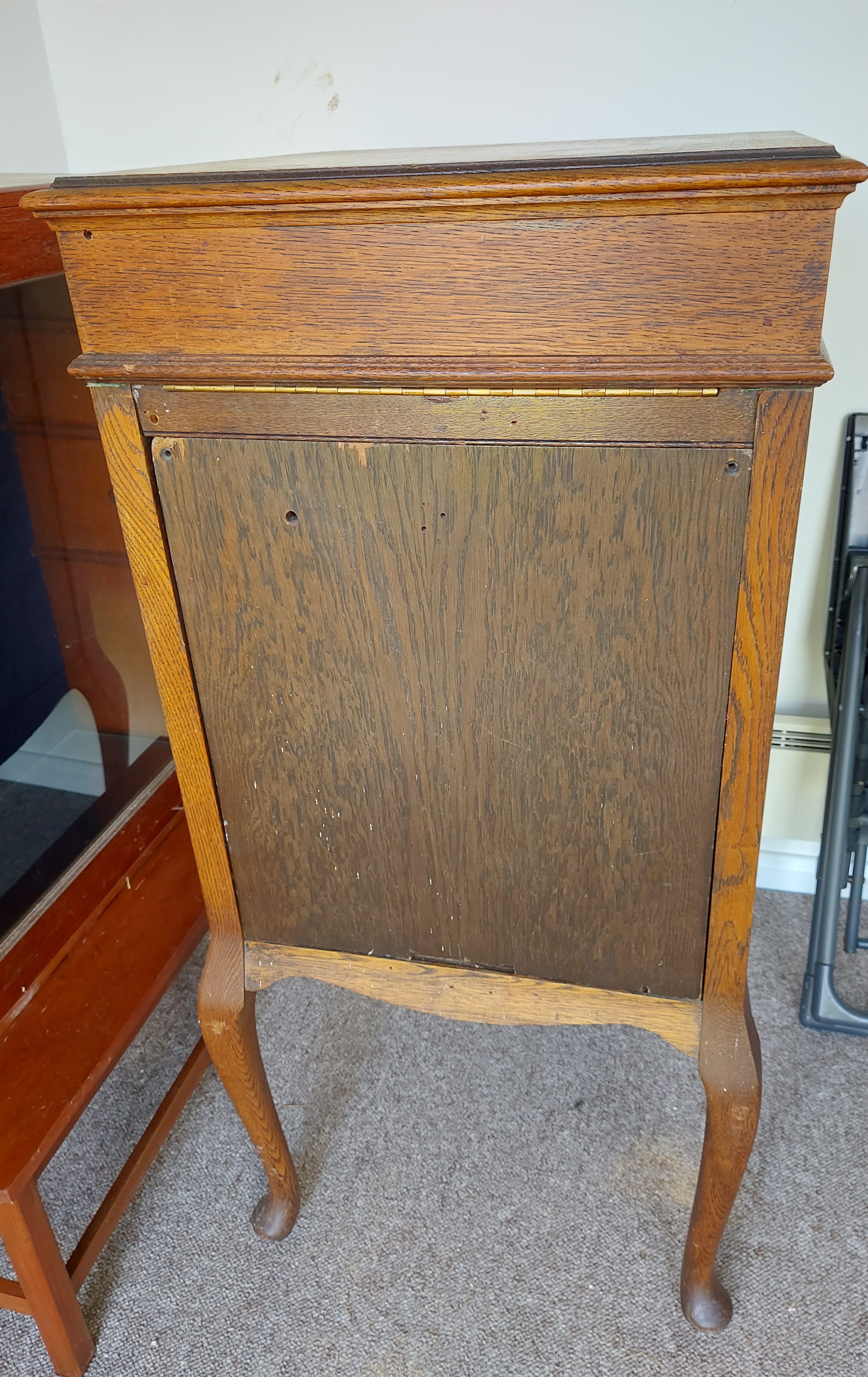

I today acquired the cabinet remains of a 511 which I plan to cut down to make a stand / record cupboard similar to the one Graham uses for his 10B Oversize. My planned project will hopefully fulfill the same task for my 10B Oversize Export model. A mint 511 is barely £200-300 these days so this would not be an economical restoration piece, even if it was possible to find the original horn.
I thought I'd document and share the process as I go along for anyone interested. Of course, any useful tips and pointers would also be gratefully received.

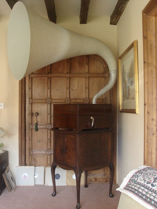

Well, perhaps even better than that, I have the photo, shown below, that Graham very kindly forwarded to me showing the same stand Ian used for the machine before I bought it. Sadly, it has now been lost to posterity so I'm having to start from scratch! The stand and spare Collaro M3A motor have gone but no one seems to know exactly where? it is therefore my intention to vary the approach to the stand very slightly. I will attempt to salvage the very good HMV lid and repurpose it as the cabinet top after modification. Hopefully I will not be left with just a pile of firewood! :D
EMG stand1a.jpg (33.2 KiB) Viewed 1706 times
As for time-scales, that depends on other things. I haven't got much time to even look at it presently!

The one on the photo looks every well adapted to the EMG. But even a complete cabinet like yours would look nice as the base.

Yes, Carlos, I completely agree but the only issue I have with leaving it as it is, would be the height! My ceilings are only standard UK height of 2.4m (8 feet in old money) so the horn does not clear the ceiling, sadly!

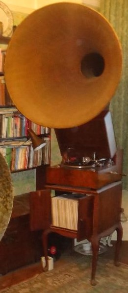

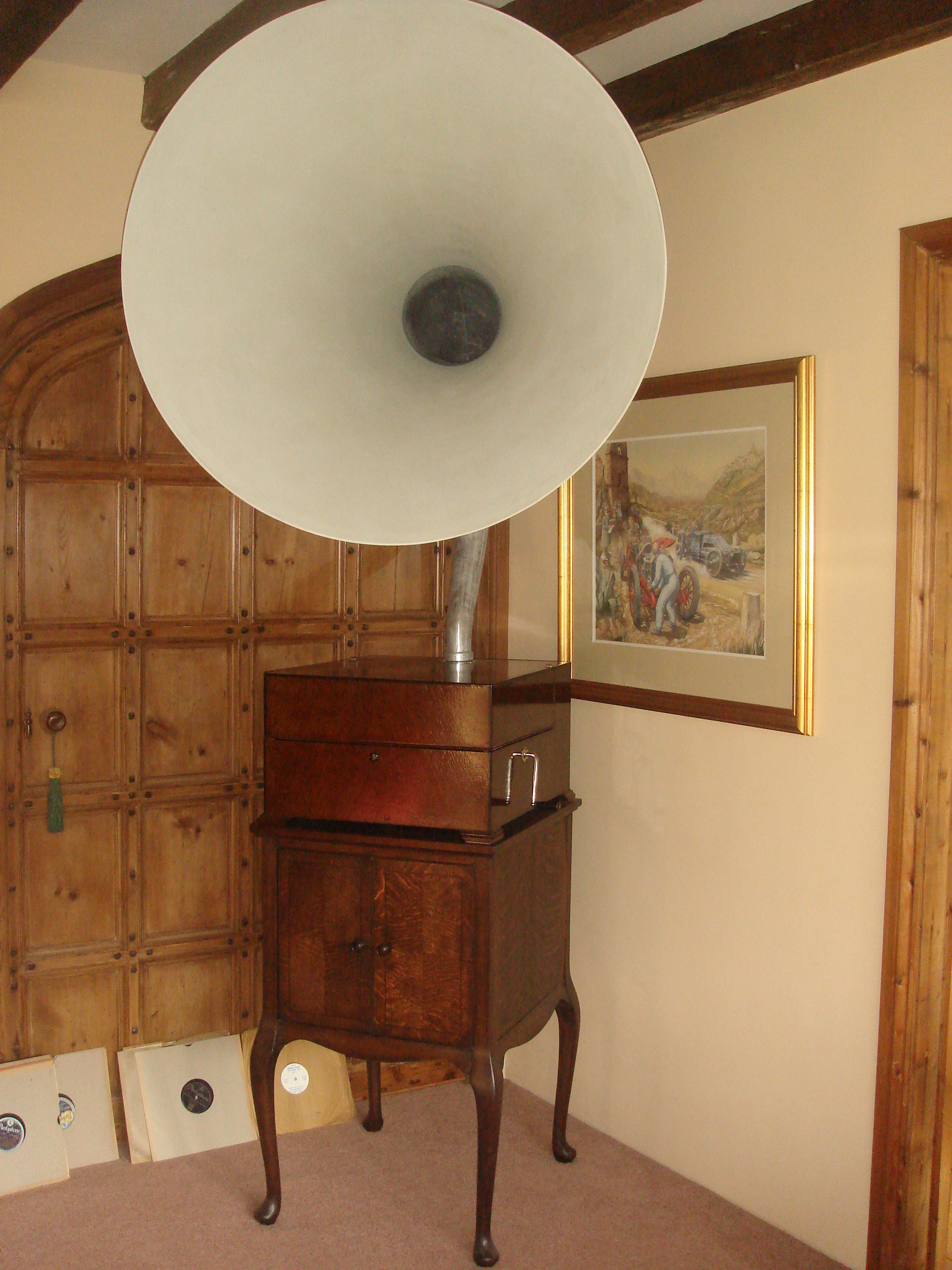

Here are a couple of shots of mine. As Steve says, any further increase in height would be impossible in the room because of the standard ceiling height. Additionally, allowing for my vertically challenged body, I should need a biscuit tin to reach the record should the turntable be any higher !

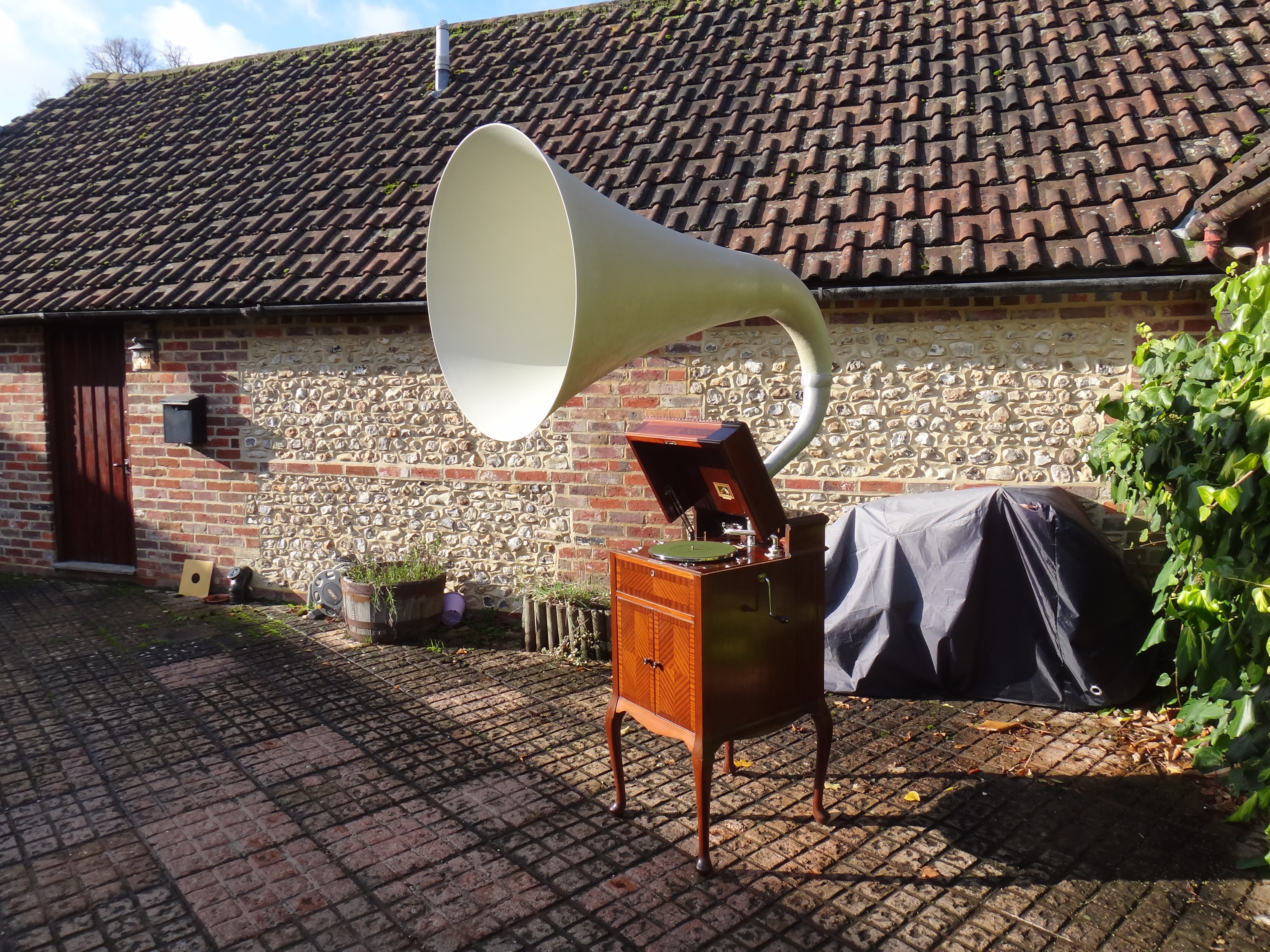

This is probably the appropriate thread to post this photo of the full HMV 511 (ex-Lumière) conversion. The turntable height works out at roughly the same as that achieved by the combination of the standard table model on top of the cut-down 511 unit. The item pictured is one of three---two with mahogany and one with oak veneers. It was necessary to cut and re-hinge the original lid to accomodate the full EMG sound system.

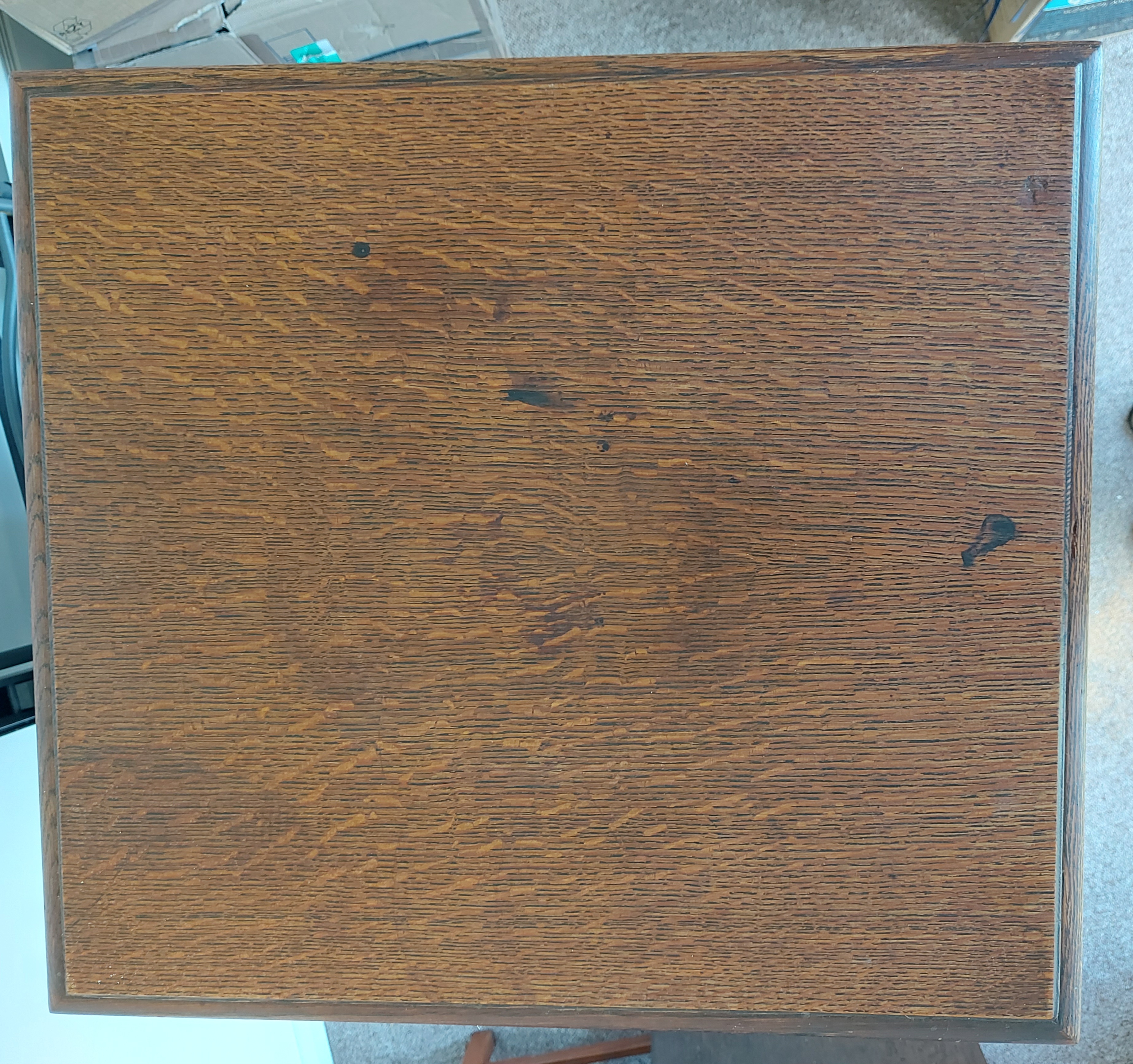

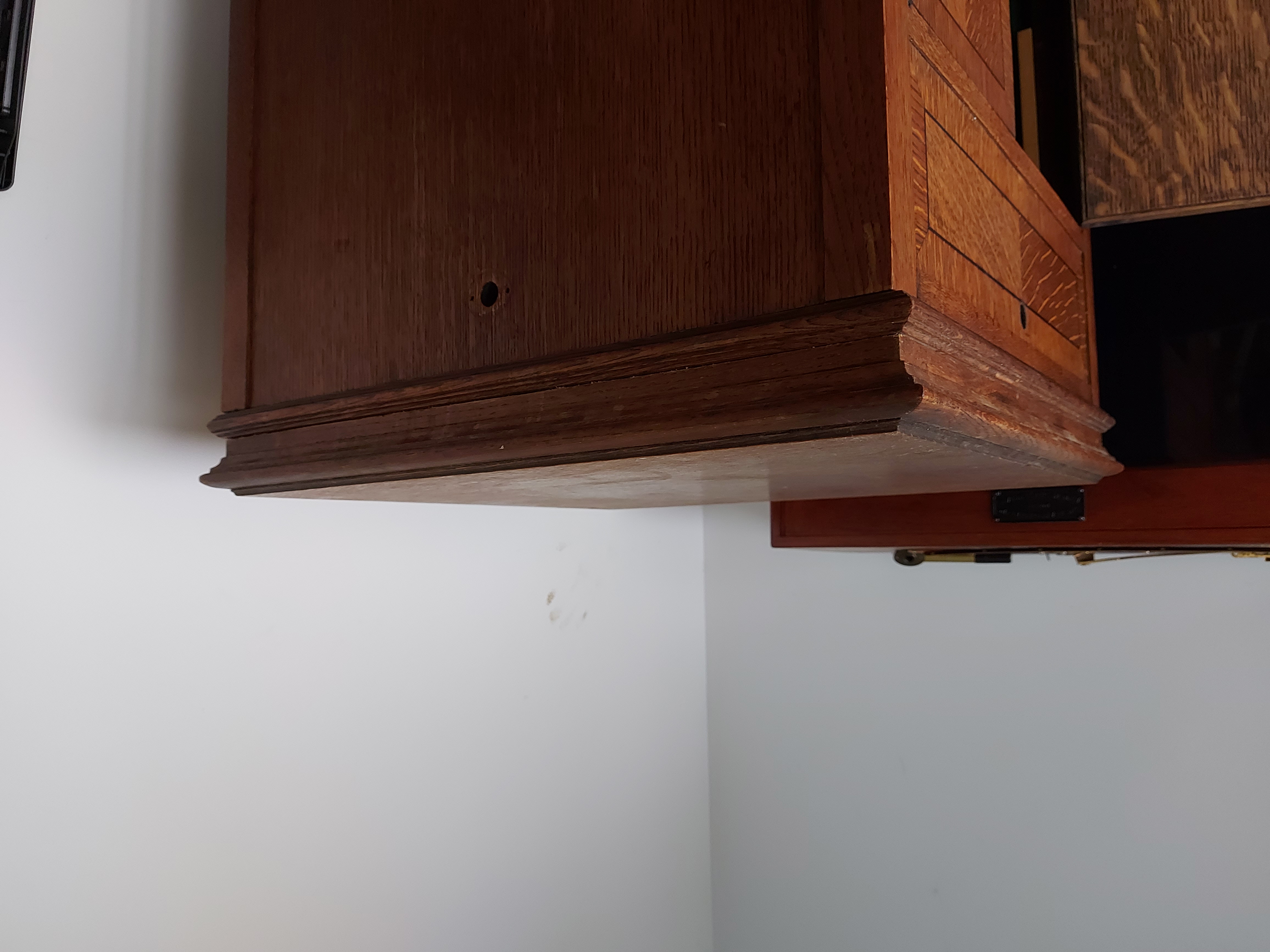

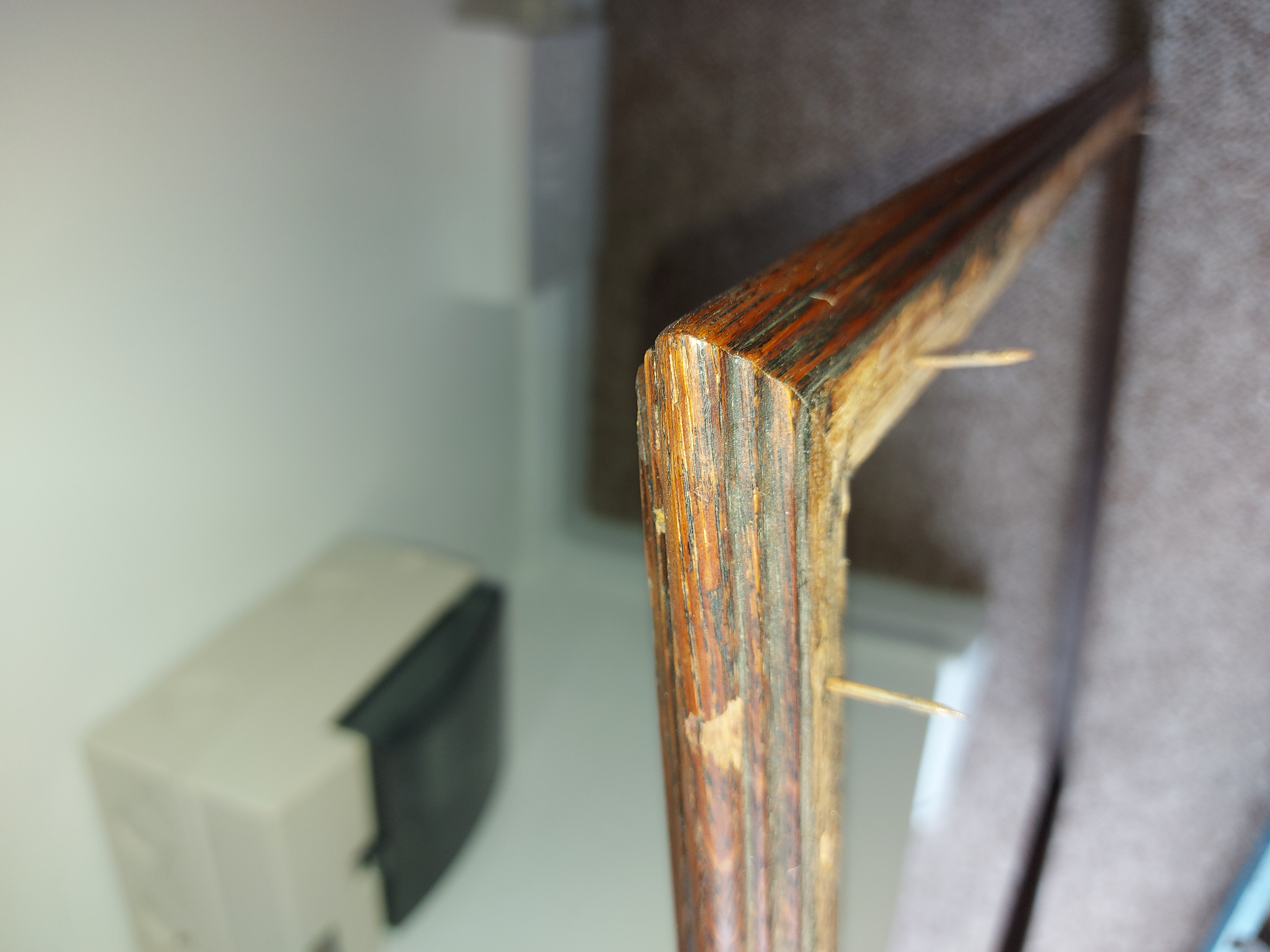

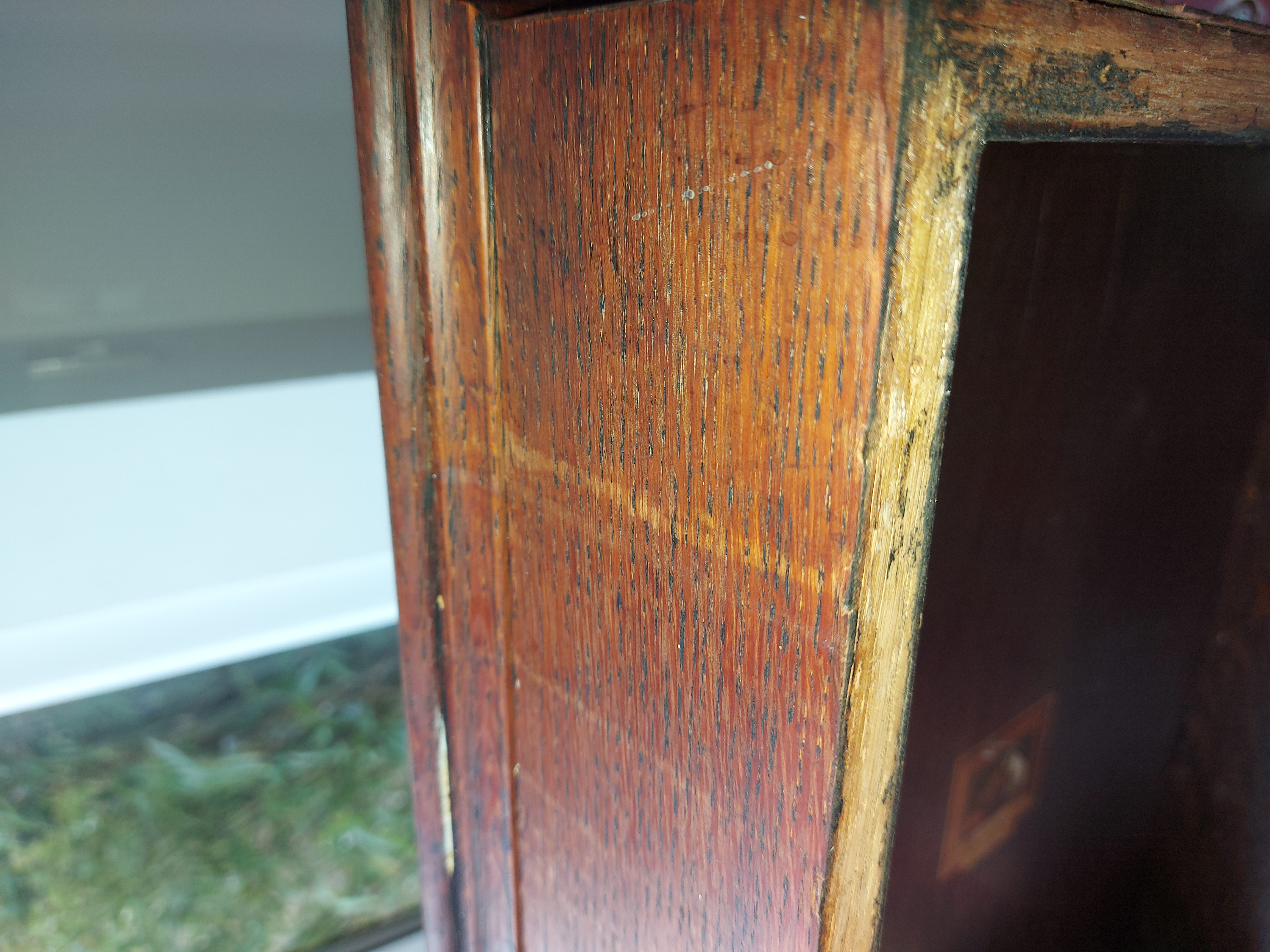

Lid reduction work started. First off was the added on beading which made a 510 lid into the 511 one. Then after cutting down the lid, the beading has been reinstated. It's only in the "the rough" currently but it's a start!
