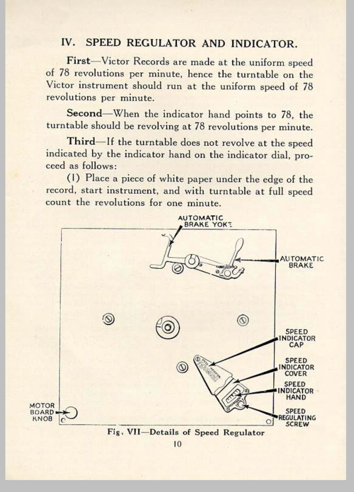

Paul,
You really have two questions.
1. Is the record playback speed correct?
2. Why doesn’t the needle indicator point to 78 if the turntable is rotating at 78/min
The first question can be answered by tuning the record to a known musical source or by comparing it with the work of trusted transcription engineers. At the time Victor recorded “Bake dat Chicken Pie” the recording standard was pretty well controlled at 78/min
The Historical Library at i78s.org pitches this record (take 1) at 78.3/min. A properly pitched and cleaner transcription can be found here:
https://i78s.org/preview/10c1085ecacf99 ... c587e6998a
The second question can be answered by reading the Victor Owners manual. RTFM is a wonderful thing! Below are instructions for adjusting the indicator. Victor suggested checking the calibration four or five times per year. The instructions are still valid today. There is no excuse for having a machine that is out of adjustment. Yes, a hundred year old Victrola can be calibrated so that the indicator needle gives a close approximation of the turntable speed.

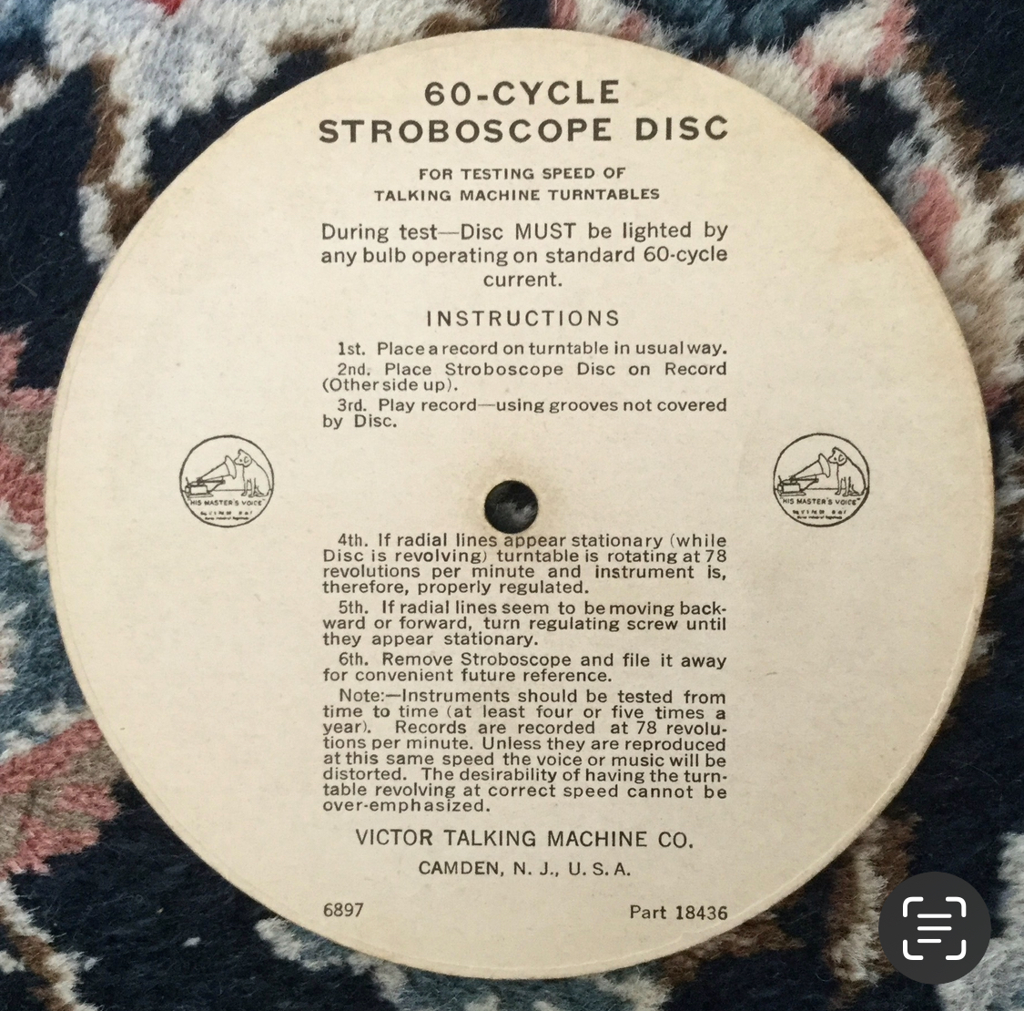

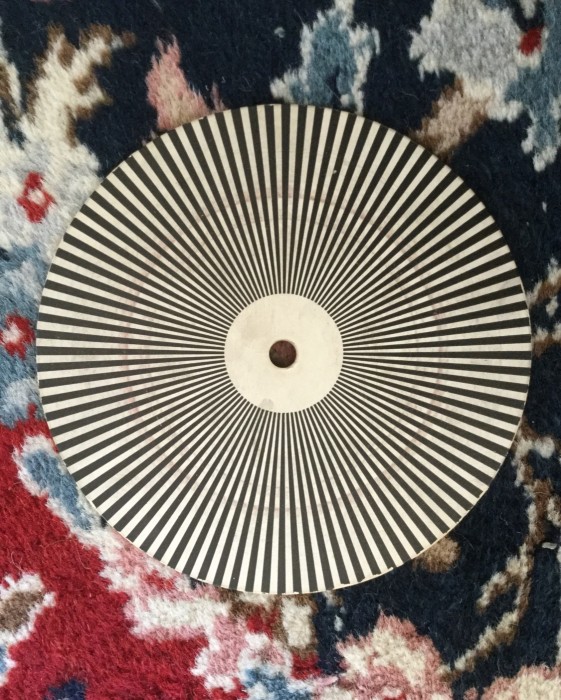

The manual describes using a slip of paper to count the revolutions, your iPhone application seems another valid way. Victor supplied a stroboscopic paper disc for speed checking for a time in the mid 20’s, it was discontinued when it was found to violate a patent. See the Victor Executive Meeting notes at the Hagley museum for this discussion.
I hope these servicing instructions will put you on the right track. Thanks to Peter at Nipperhead.com for the manual page scans.
Mark
