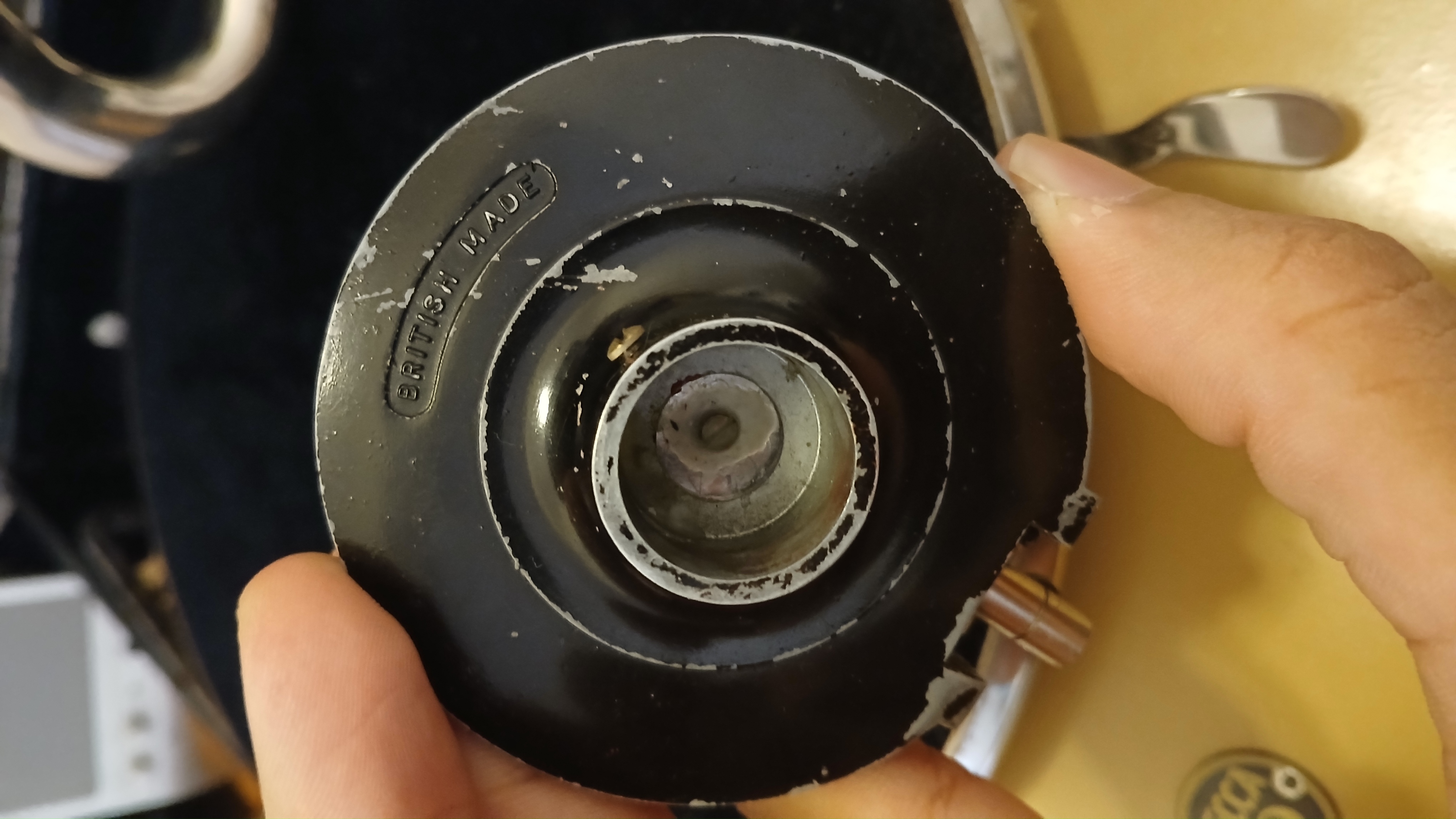

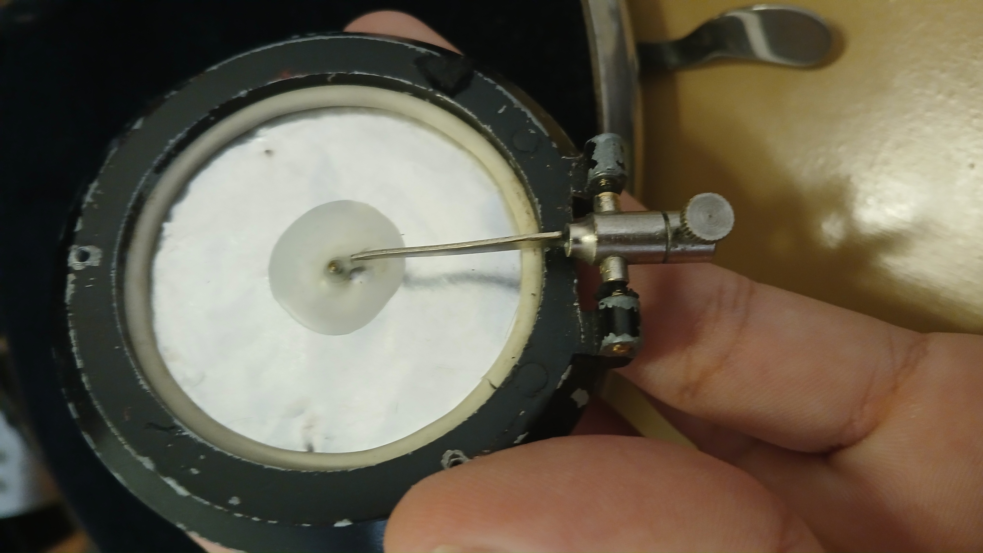

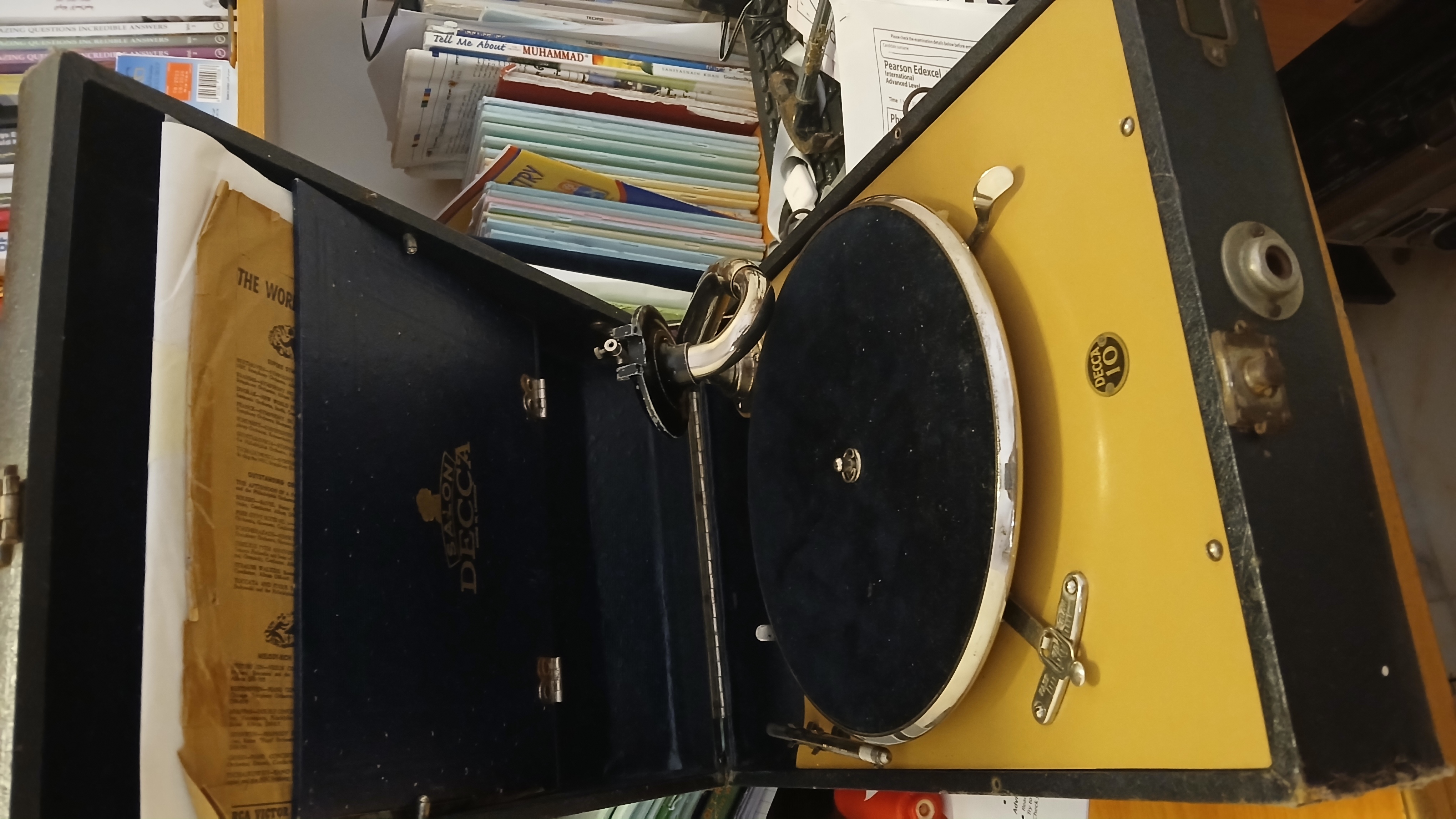

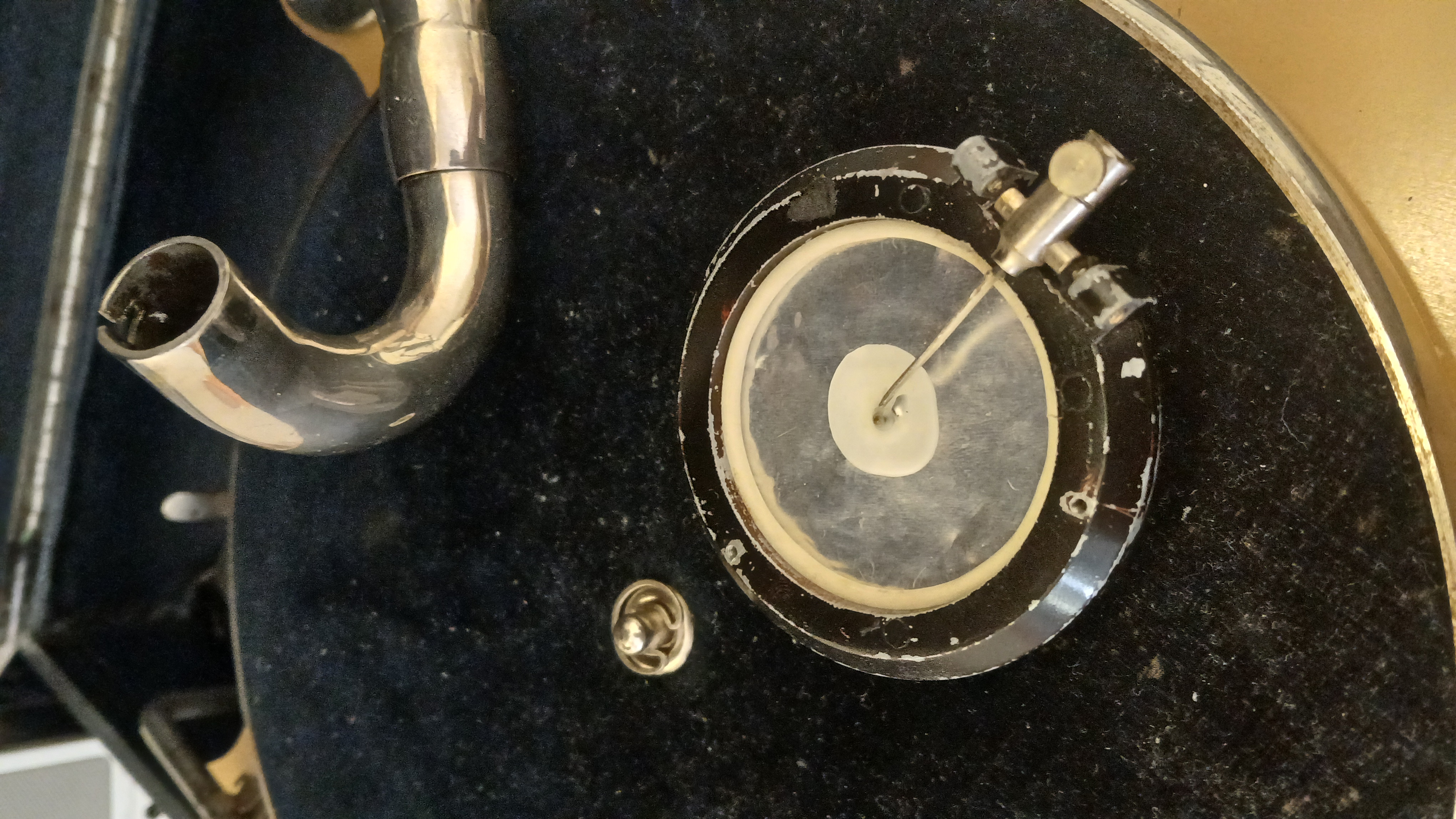

Hello everyone. Im new to this hobby, and this is officially my first post on this wonderful forum. I purchased a banged up Decca 10 portable two years ago, my very first gramophone, and have worked on bringing it back to working order. The gramophone plays well, but the soundbox is still damaged and produces a noticable distortion. (The diaphragm was dented so I had to fashion one out of an aluminium food container, and the needle screws are worn to the point that adjusting them is impossible.) I was yearning to buy a replacement soundbox for it but my knowledge on soundboxes are quite limited. Does anyone have any suggestions on what soundbox would fit on my portable? Thanks.

I have one of these machines, but unfortunately not to hand. I believe the soundbox has the common small bore Victor/HMV bayonet fitting, so many soundboxes should fit, like the HMV No.4, and many other ones from similar portables.

Aluminium food packaging can be made to work, but it needs to be corrugated, like here:
