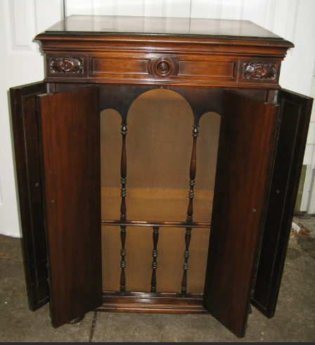

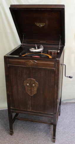

Re: [Victrola VV 4-3 CREDENZA] Hand Crank Question
This is a Credenza...
This is a 4-3 Consolette...
Which one looks like yours?
FeartheTardo
Posts: 5
Joined: Sun May 26, 2024 3:14 pm
Post by FeartheTardo »
The one at the bottom is the correct one!
Posts: 6587
Then the crank you bought should be fine.
