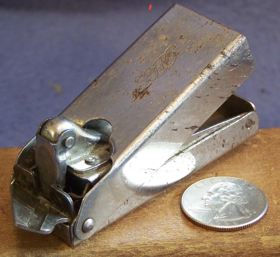

I find good the L&H models that seem a small handy stapler. I have two of these. They pop up in eBay from time to time. I also use the HMV cutters.
Just check this, for instance, but they can be found much cheaper, in the range 25-50 bucks...

I have been using my L&H cutter for years and I purchase needles here. https://www.ebay.com/itm/256427290435?m ... media=COPY
Well worth the expense when used on my very loud Victrola 8-12.

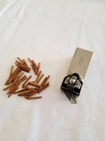

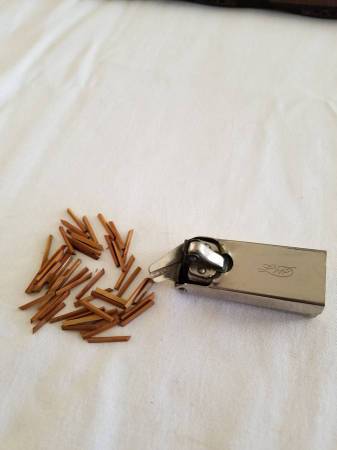

OK .... found a cutter cheap!
L & H .... with a handful of needles ... $20 with $10 shipping (seller would only accept cash ... so a bit of a wait). Found it on Craigslist on the other side of the country.
Should be on it's way.

That's a good buy for $30. :clover: :coffee:
