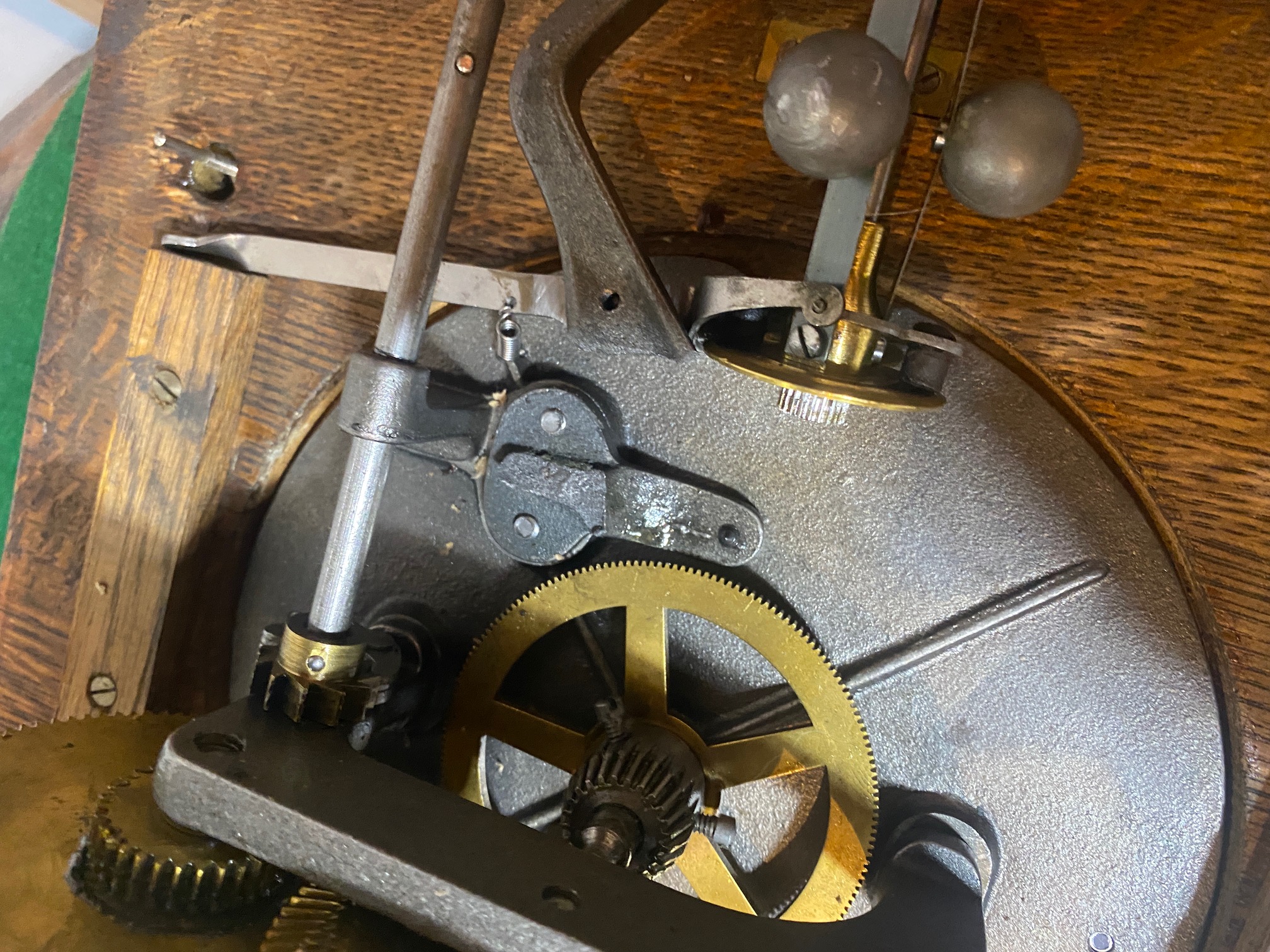

I am wondering if I should attempt to repair this broken governor casting or search for a replacement? I think I could super glue it together and then drill and tap for a couple of machine screws to hold it together. Any thoughts on this?

Over in the UK parts for these are really hard to find. Not sure elsewhere, but what have you got to lose? It’s useless as it is so a repair can’t hurt.
They’re a pain to adjust to sound quiet, notoriously noisy motor with the bevel gear arrangement. Unless you have any tips on how to make them run quietly?!

I agree with you that I have nothing to lose. I wish I had a magic tip for making them run quietly, but I don't. I just keep making minor adjustments until I get frustrated and quit...

The repair seems doable, but I don't think the super glue is going to give you the strength you need to drill & tap. I'm thinking to drill the holes in the base piece first and then epoxy the arm in place. You then only need to use your pre-drilled holes as guides, which would not require the same glue strength that drilling from scratch would require. You might even think of just getting the 1st hole drilled & tapped. You could then insert one screw which would really help to hold things together without depending on the glue any longer. The trick will be how to hold/fixture the arm in place while you do all of this.

Sounds about right. I read the factory would use paper shims to level things out. I tried it on the governor mount, it helped a very minor amount.Dave D wrote: Mon Jun 10, 2024 4:03 pm I agree with you that I have nothing to lose. I wish I had a magic tip for making them run quietly, but I don't. I just keep making minor adjustments until I get frustrated and quit...

I opted to just replace the part instead of repairing it.
