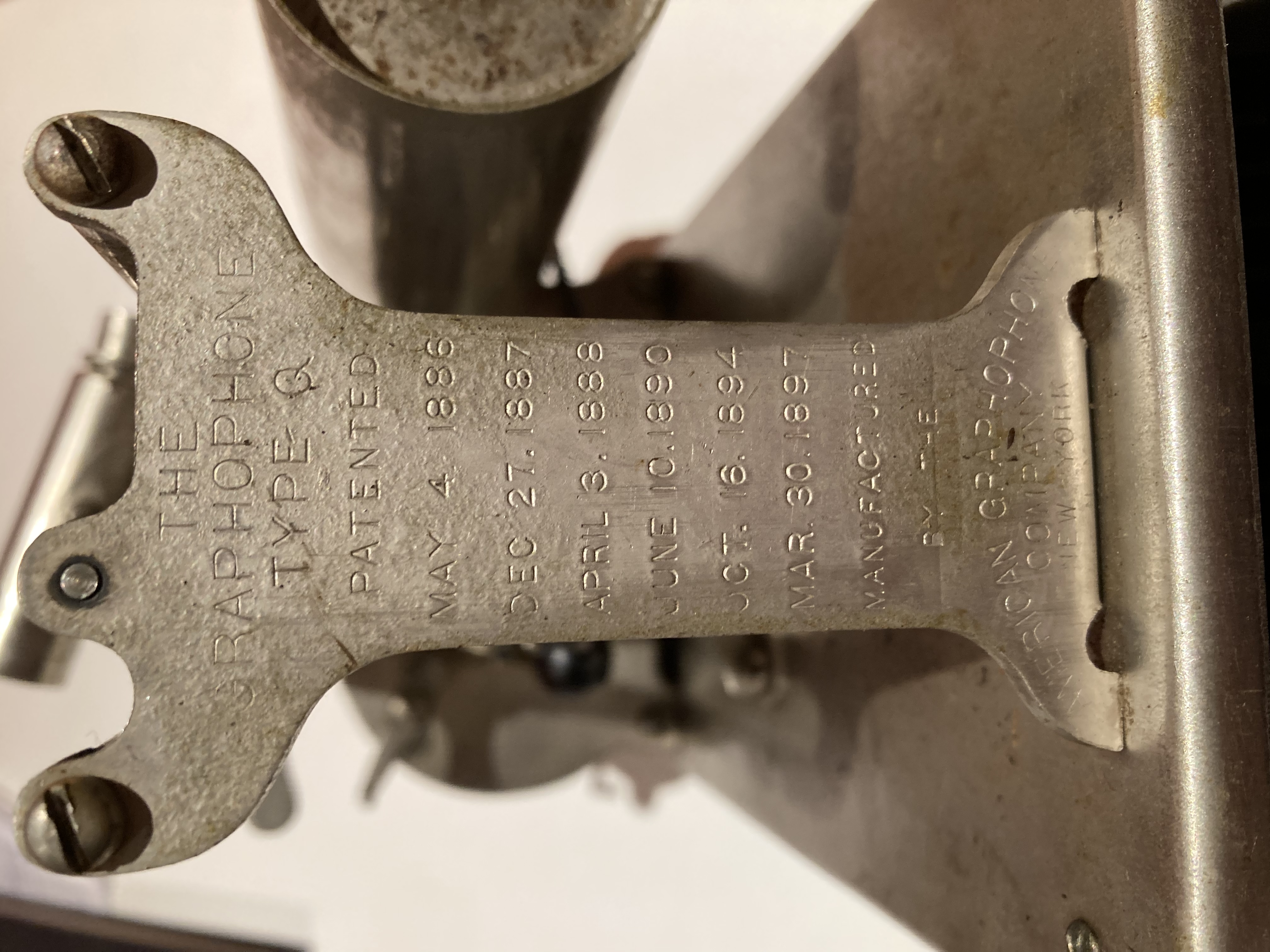

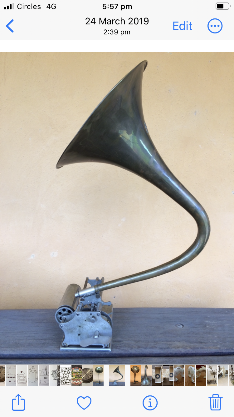

Hi everyone,
Would one of you have an idea about the value of my Type Q machine made by the American Graphophone Company in New York, and the accessories?
The machine’s six digits serial number starts with a 3, I’ therefore guessing that the year of its manufacture was 1897-98. Can you confirm?

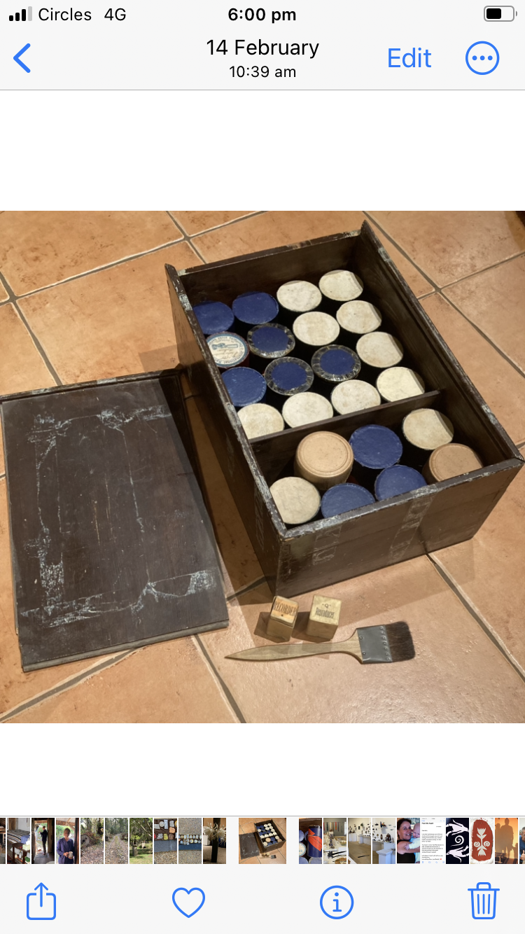

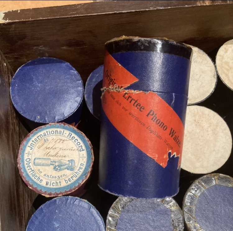

And what about the 23 wax cylinders of which some are privat records, some commercial music and some still naked.
I need the information for insurance purposes.

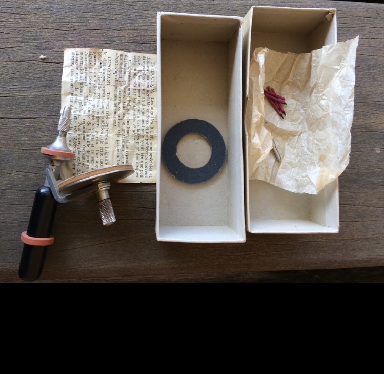

The same question goes for the (seperate from the Graphophone) record needle sharpener.
Any help would be greatly appreciated.

Re: Type Q Graphophone
The Type Q didn’t appear until early 1899.
dyxshop
Posts: 78
Joined: Tue Jun 09, 2020 10:43 pm
Post by dyxshop »
Nice 👍
AmberolaAndy
Posts: 2746
Post by AmberolaAndy »
Yeah early 1899 to probably about early 1901?
Post by Fonotone »
AmberolaAndy wrote: Mon Jun 17, 2024 10:23 pm Yeah early 1899 to probably about early 1901?
Actually, they were in production for almost 10 years.
-- Grant
http://www.technogallerie.com
AmberolaAndy
Posts: 2746
Fonotone wrote: Tue Jun 18, 2024 7:28 pm
-- Grant
I’m talking the ones with the serial number starting with 3.
Post by Dodo »
Many thanks for all your replies, which help me with the dating of the machine.
Now the question remains about its approximate current value. Would anyone have an idea, even if it’s a rough one only?

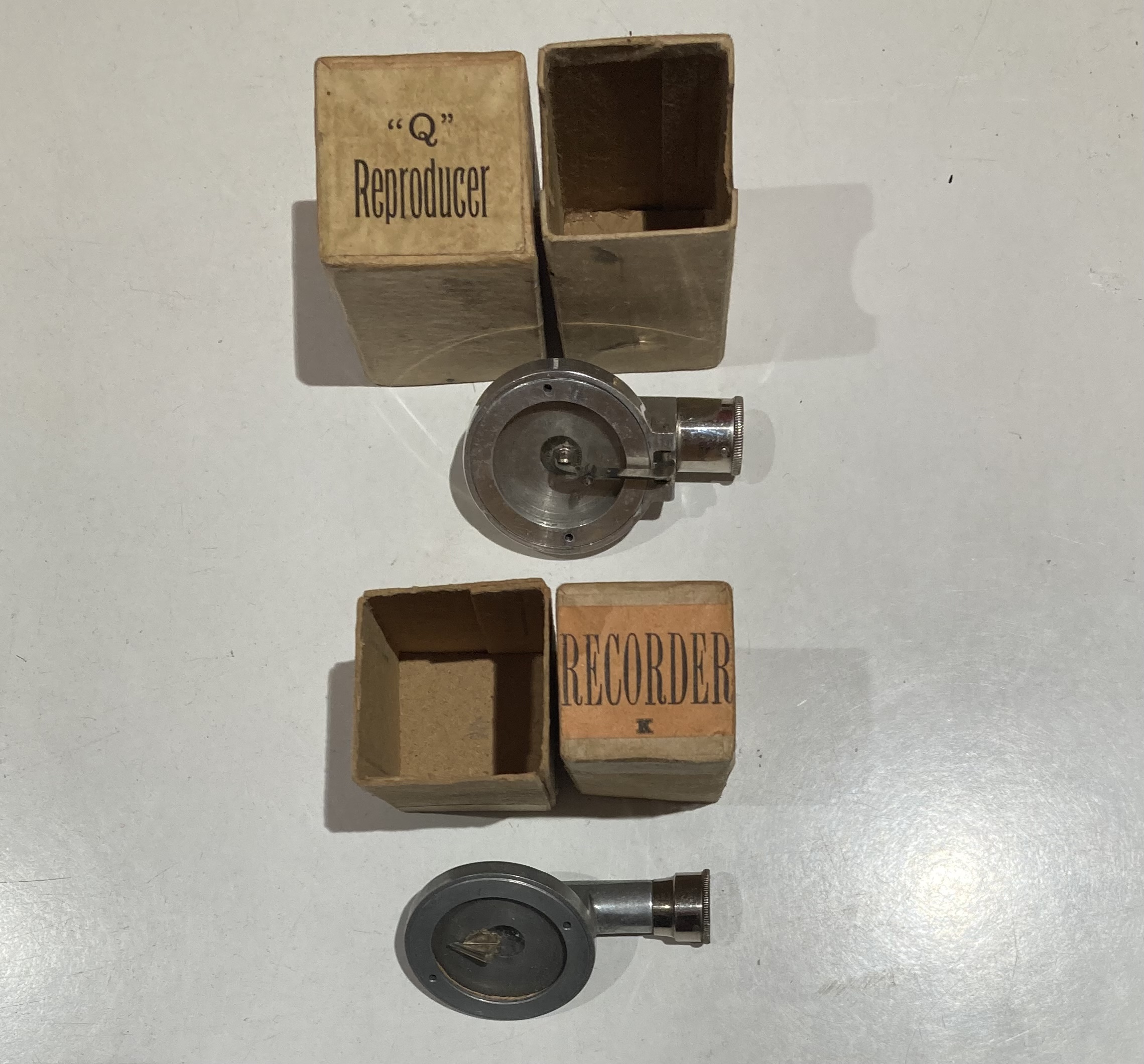

Post by Lucius1958 »
I'm not absolutely certain about the reproducer: perhaps some photos from a different angle?
(The reproducer for the first style Q had a distinctive angled throat; this looks more like an early #2...?)
