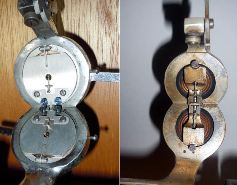

That's a very rare variation of the Polyphone.... However I'm surprised to see that version mounted on a Suitcase Home rather than a Model A. That is the later National Phonograph Co. model, of which I've only seen a few over the years. The casting is dirty and hard to see in the picture, but I'm sure it is marked on the top, around the reproducers, with the National Phonograph Company engraving.
The "common" (relatively speaking) Polyphone attachment used two modified Automatic reproducers, with the normal adjusting wings on the side. The weights were hinged at the bottom, as usual, but there were two limit screws rather than one in the center, and where the normal limit screw would be mounted there were plates with 'fingers' to keep the reproducers aligned. The reproducers were firmly held in the casting with two large head screws but were easily removable.
On the National Phono attachment as in this auction the reproducers are built right into the casting itself. They are not removable. The diaphragm and gaskets are mounted in the casting, and the top plate screws into that casting. The weights are heavier and are hinged at the top. They are totally unlike the usual Polyphone reproducers.
Given the condition and the rarity I don't think that is wildly out of line. There was a very clean, perhaps lightly restored one at Union a few years back at $14K. It subsequently sold, I don't know at what final price.
But, as I mentioned at the beginning, I've only seen that National Phono design on Model A Homes, Standards, and on one H&S cabinet Concert. I wouldn't have expected to see it on a Suitcase.

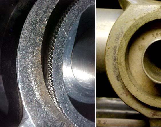

EDIT TO ADD: Here's a picture comparing the early 'regular' style to the National Phono design. A world of difference:

- TinfoilPhono
- Posts: 2055
Re: Edison Polyphone on Ebay 10K
The markings on these are so hard to see even under good lighting that it's far from obvious. After tweaking the eBay picture a bit I'd wager there is some marking along the inner rim, as you can faintly see in the photo of another National Polyphone on the left. You'd really need to take a close look to tell, and it may be very hard to see under all the dirt.
It's not a certainty, but....

This rare, National Polyphone arm did in fact show up on Suitcase models. Here is a picture of another one.
I am aware of 5 of the National version of the Polyphone attachments on Homes. Two on late suitcase machines, two on green oak machines, and one on a red banner machine.
