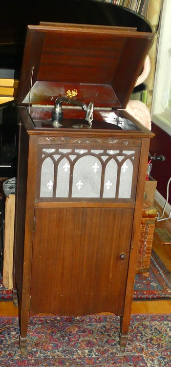

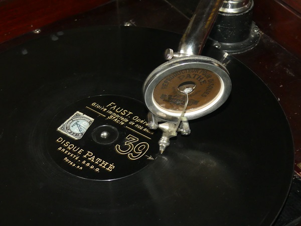

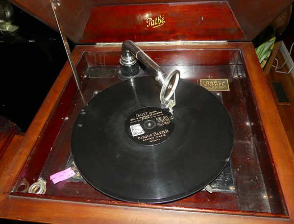

[Edit] I'm adding a couple of photos showing mine, which was my very first spring phonograph, with a 14" Pathé record. (Yes, some prior owner amputated some elements from the center of the grille.) The machine is a No. 100, which I think is basically the same thing as a Model X. Note the angle at which the reproducer's stylus linkage is set; it will respond to both vertical and lateral cut. You can also rotate the reproducer for more direct alignment. Moreover, the cabinet is proportioned to store 14" records.
One further thought: if you're talking about 14" Victors or Fonotipias or the like, those are uncommon/rare disks, and I'd think more than twice about inflicting steel needles on one. Pathé 14" discs aren't exactly commonplace, either, but they can be more safely played on an acoustic machine as long as you have the sapphire ball stylus.
