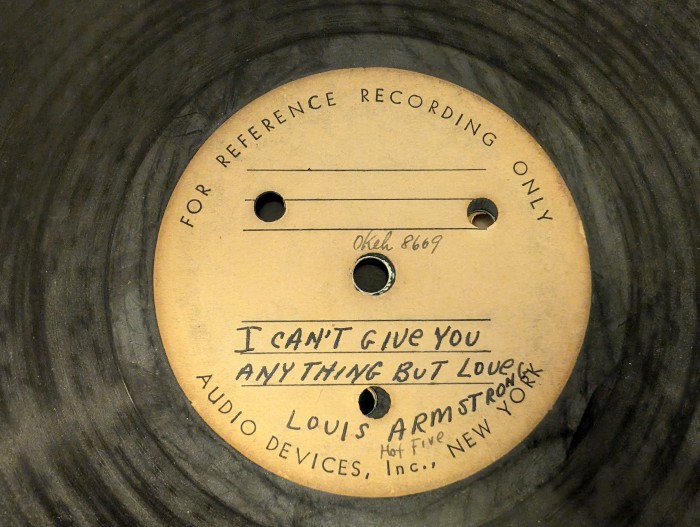

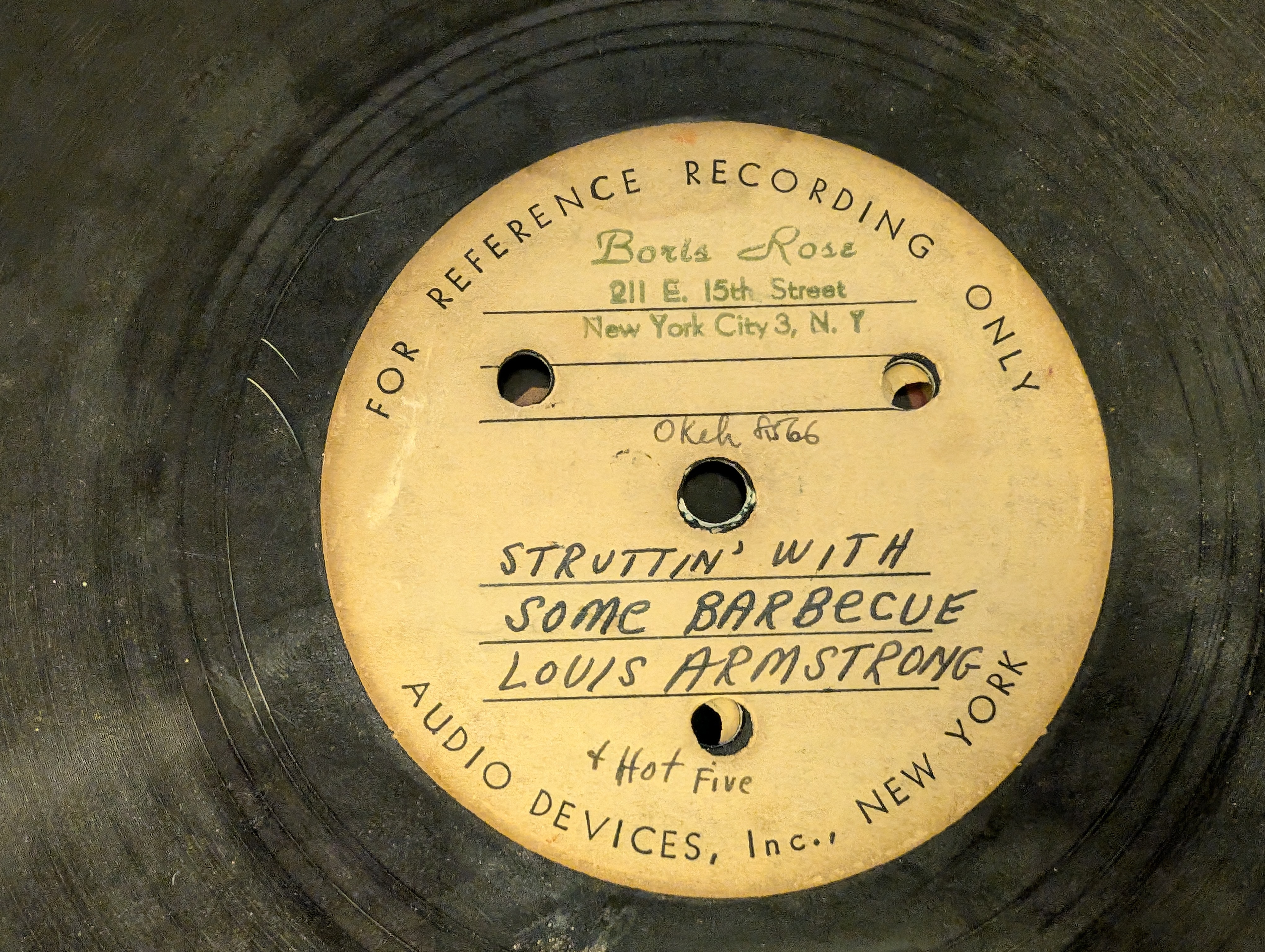

I found 9 of these 10-inch discs (acetate, maybe?) while sorting through a box of otherwise "normal" 78's. Most have that "Boris Rose" address stamp on one side; some don't. (The handwriting is the same on all of them.) Louis Armstrong is the most represented name, though there are also Coleman Hawkins and Count Basie, and some sides with no artist listed. (All have titles, though.) Most look playable, though one appears to have portions of the recording surface flaking off. What are these? When would they have been made? How do I play them? (I haven't tried.) Were they homemade one-offs, or mass-produced? Do people collect these? Happy to pose pictures of some of the others if anyone cares to see them.

They also have Okeh cat #'s written on them. It'd be interesting to compare them with the commercial release. Sounds like he recorded a lot of music off the radio and live in clubs, maybe he also copied shellac discs for some reason?

These look like home recording disks or radio transcription disks.
My guess is that at the time these were made, the original Armstrong records were becoming rare, and these are dubs of the original records. Some collector probably made them for a friend.

Lacquer disc. The weird grime on it is a result of palmitic acid being built up over time. I think you should see if you can get it transferred especially considering they've already started delaminating. Ps; Don't play them on a gramophone. The weight that would be exerted onto the record via the needle would destroy the fragile lacquer.
