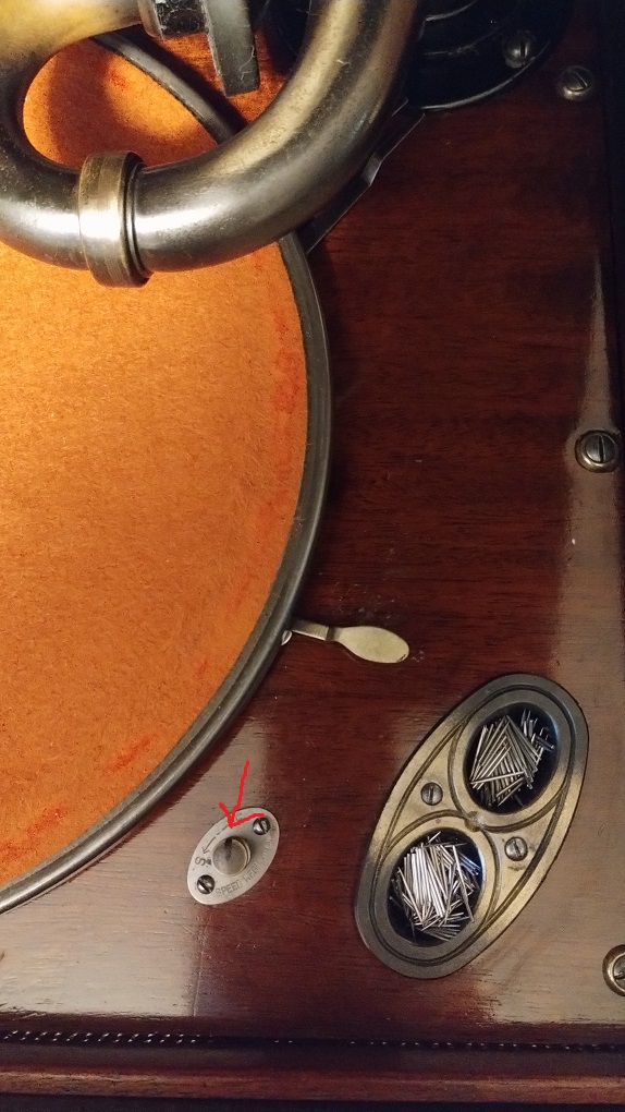

Step 1: Calibrate your phono motor so it runs at exactly 78 rpm. Then, using a black permanent marker*, mark a perfectly vertical line spanning from the center of the knob to its circumference (see the photo with red arrow).
Step 2: Using a digital tachometer device, mark how much you need to turn the speed control knob to increase or decrease the speed by 1 RPM. This will vary for each phonograph, of course, but as a reference, it takes about one full turn of the knob on my Victrola to increase/decrease the speed by ±6 RPM.

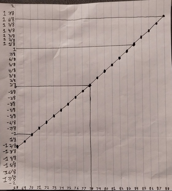

Step 3 (optional): Make a graph chart showing what exact speed/RPM corresponds to the position of the speed control dial from its 78 RPM "home base" speed. (This can be any numeric range you need.) Since my slowest-playing record is a Fonotipia cut at 68 RPM, I used that as my slowest speed and since my fastest-playing record is a "Cinch" label foreign pressing cut at 88 RPM, I used a 21-point RPM range on the X axis and a range of ±2 knob turns on the Y axis.
Step 4: Play the non-standard record and increase/decrease the speed until it is correct. Note how many turns of the speed control knob it took to obtain this result.
Step 5: On the record sleeve or in a separate notepad, note via the graph which position of the knob the correct adjusted playing speed is for that particular record and return the knob to its original 78 RPM "home base" speed. Rinse and repeat Steps 4 and 5 for any other records you own which were cut at non-standard speeds.

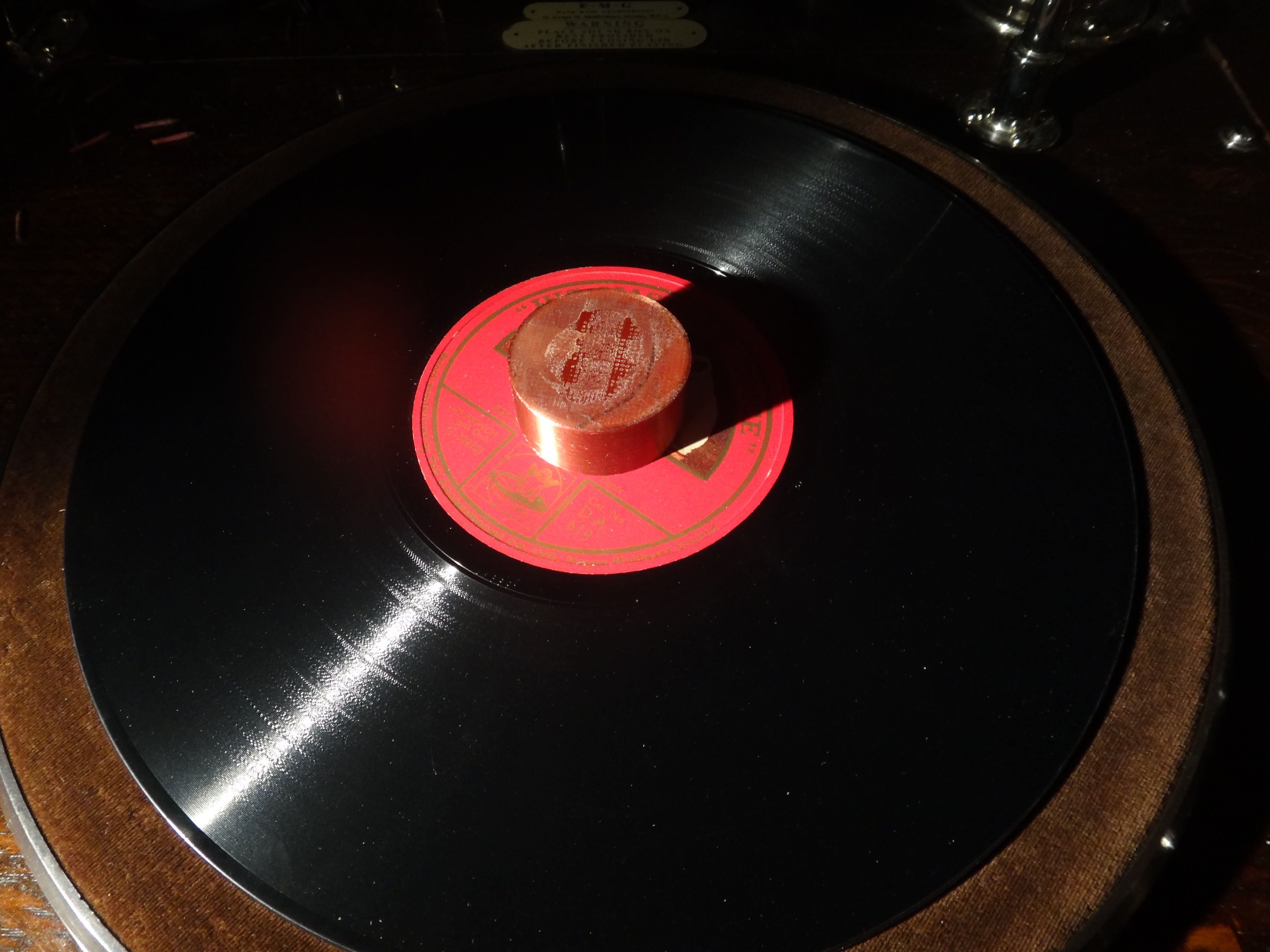

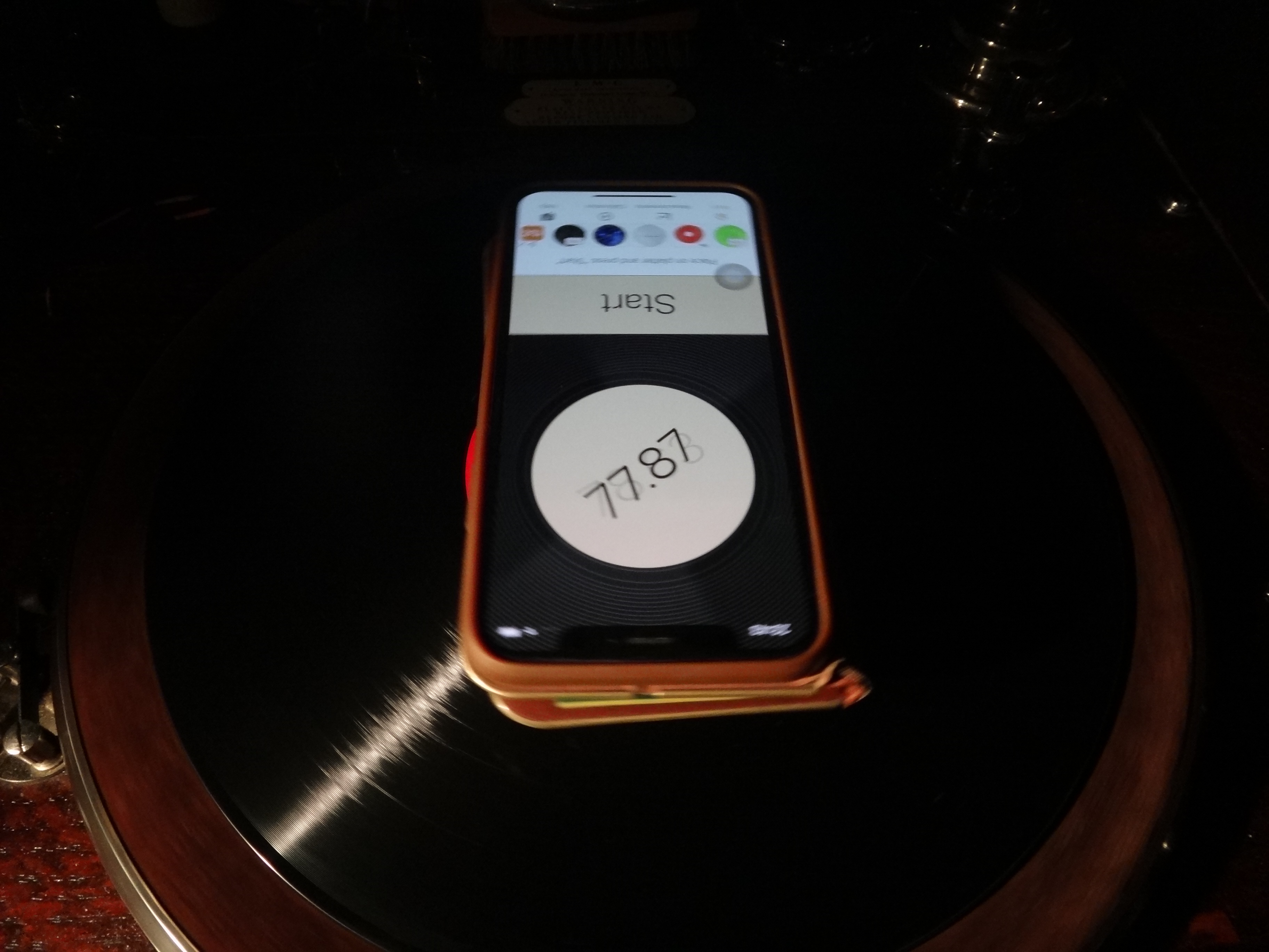

I use an Apple iPhone App called RPM WOW which works well. It is necessary first to place a small diameter cylinder around the spindle to allow the phone a flat stable surface. This system can still allow for drag.

Jason, the problem with your proposed method is that it assumes that the regulation system in a gramophone is stable. This is not the case for many, mostly due to age-related degradation of the parts, in particular the governor pads, or to poor design of the regulation mechanism. Therefore, after everything is calibrated, the reference speed will drift over time, and a recalibration will be required. The phone app mentioned above is the most practical method, I have been utilizing it for years in various different machines with no issues.
