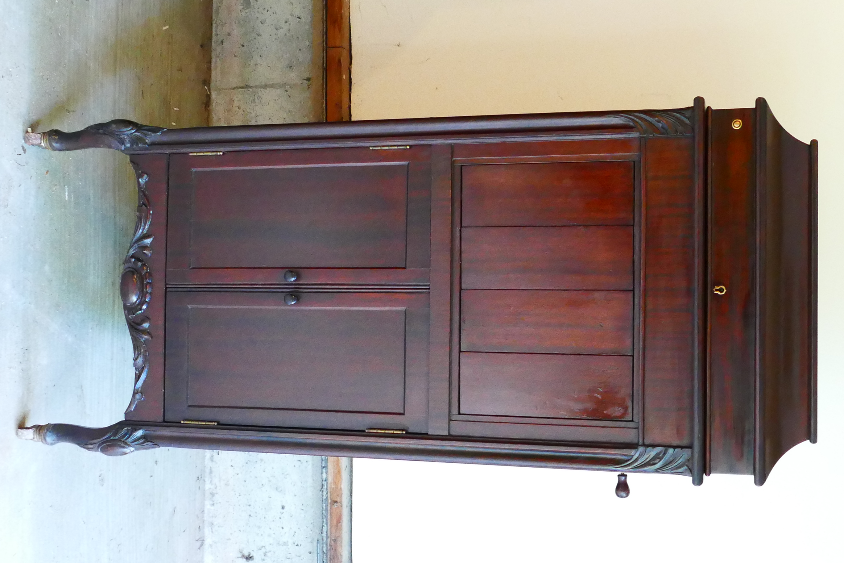

Hi, everybody. I have a Columbia Grafonola with the louvers that are opened and closed by turning a metal knob on the side, as opposed to the kind with two wooden knobs on the louvers themselves. As long as I have owned it, the louvers stick when they are closed all the way, to the point where turning the side knob doesn't open them, and I have to poke them with a finger to get them open. If the louvers are not closed all the way -- even if they look like they are from a distance -- the side knob works fine. (They will close all the way using the side knob, but then I can't get them open again without poking them.)
Has anyone else had this issue? If so, what, short of sanding down and restaining the narrow edges of the louvers, can I do to fix the problem?

Re: Columbia Grafonola -- louvers sticking?
