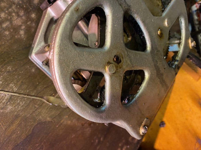

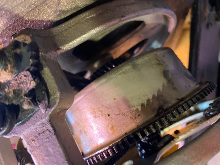

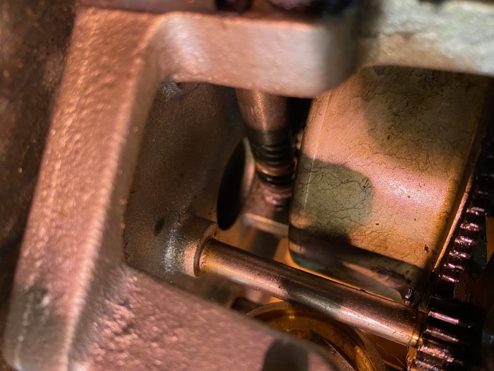

Does anyone here have experience with this type of motor used on a Brunswick portable? It runs fine and just needs a good cleaning, but I am worried that spring barrel may be pot metal. I see spider web marks that might just be in the old oil, but it might be cracking of the spring barrel. It makes no sense to me that such a nicely made motor would be pot metal, but you never know what you might find.
Anybody know for sure what I am dealing with before I tear it down for overhaul?
Dave D
Posts: 6586
Re: Brunswick Portable Motor Question
It's a steel stamping Dave. Try rubbing the crack-like marks with some lacquer thinner and I think they'll disappear.
