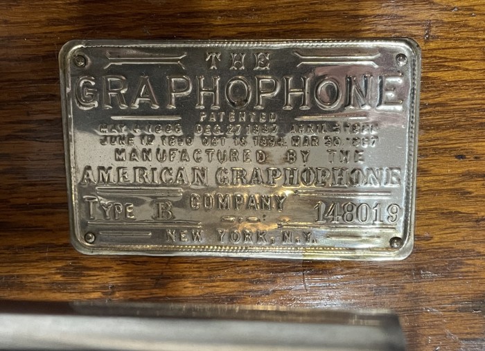

How do I know if mine is nickel plated? Its serial is 80809.

I think yours is before they were doing that. I think they were doing this type of stuff starting in 1898 and your machine (the 809th made) is before that.postwick wrote: Sun Jul 14, 2024 10:01 pm How do I know if mine is nickel plated? Its serial is 80809.

The term "nickel-plated," when used regarding Eagles, is often a misnomer. Because Eagles were made of stamped steel, and unprotected steel will immediately begin to rust in certain environments, all Eagles were nickel plated. This is sometimes called a "dipped nickel" or "flashed nickel" finish whose only purpose was to protect against rust.postwick wrote: Sun Jul 14, 2024 10:01 pm How do I know if mine is nickel plated? Its serial is 80809.
The 1898-99 BXP was POLISHED in addition to its nickel plating. This polishing was far more than a bit of Flitz on a rag. The metal itself was polished smoothly before the nickel plating was applied. Likewise, the Type AB, BG, and many other Graphophones whose bed plates shown like mirrors were POLISHED.
Eagle #80809 was nickel plated but not POLISHED.
