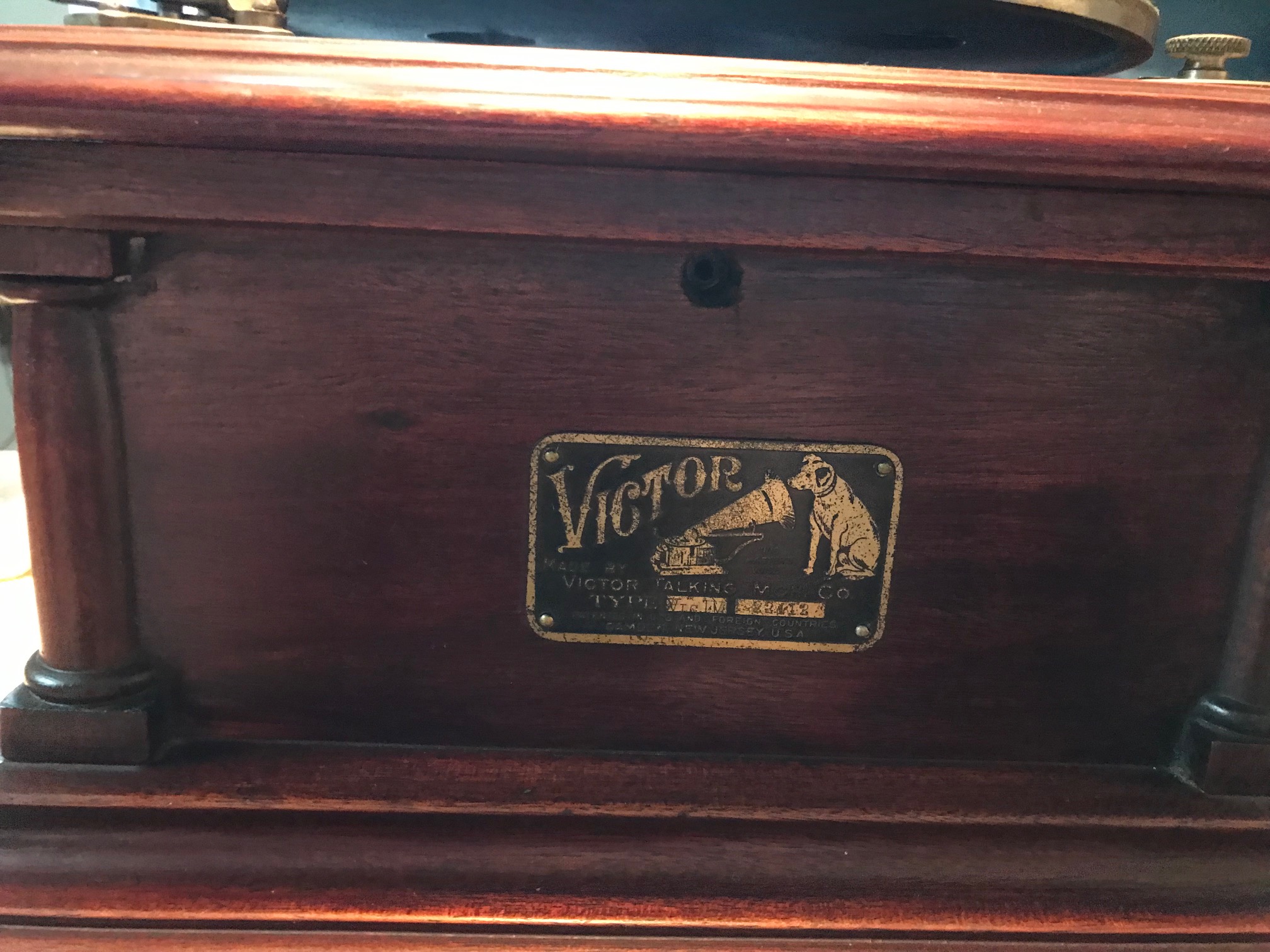

I took Vic IV off the tag, which has "Type Vic IV" on it. But I understand the confusion and in the future refer to it as Victor IV.

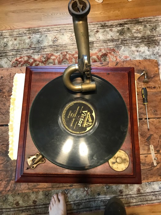

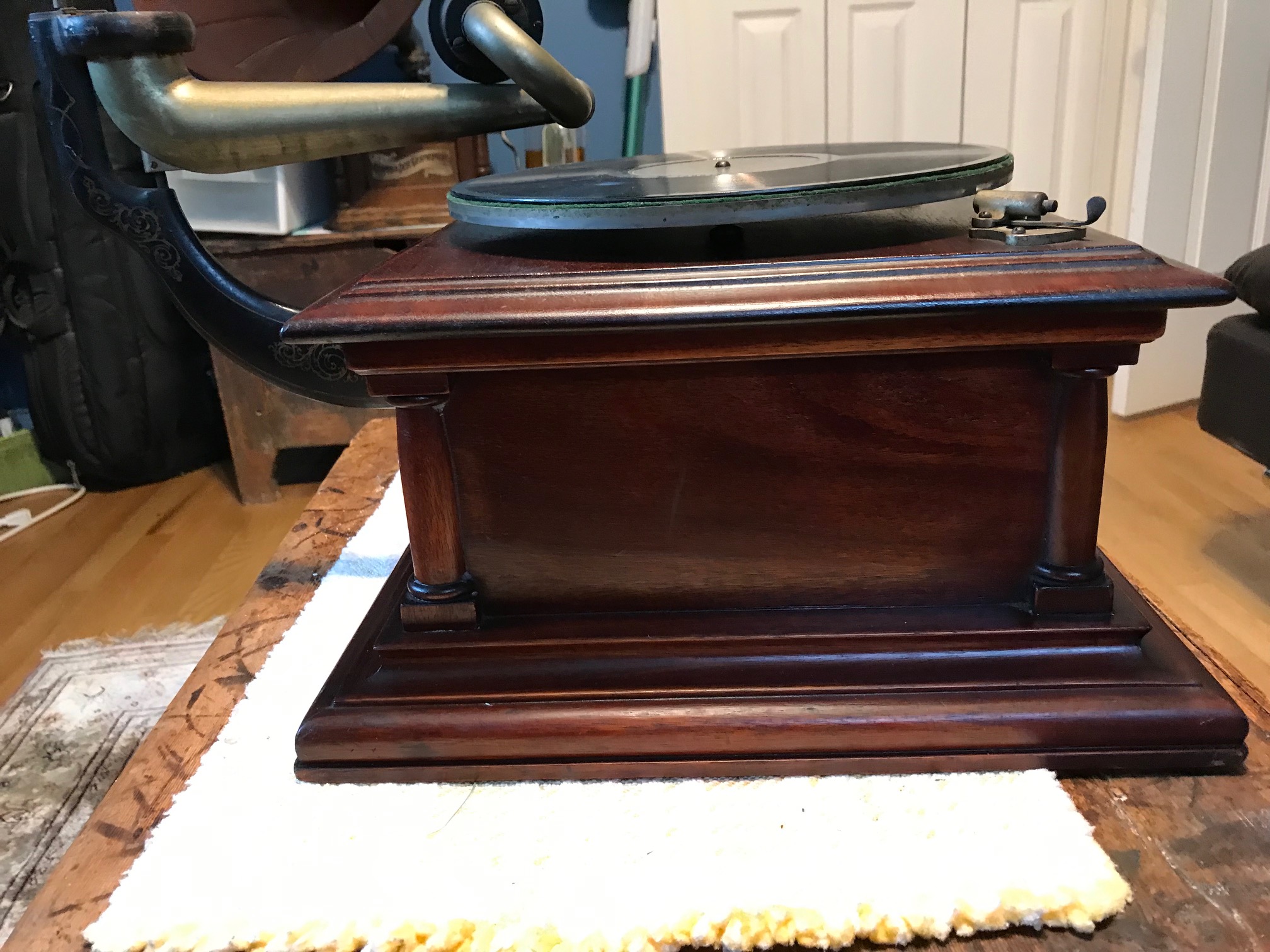

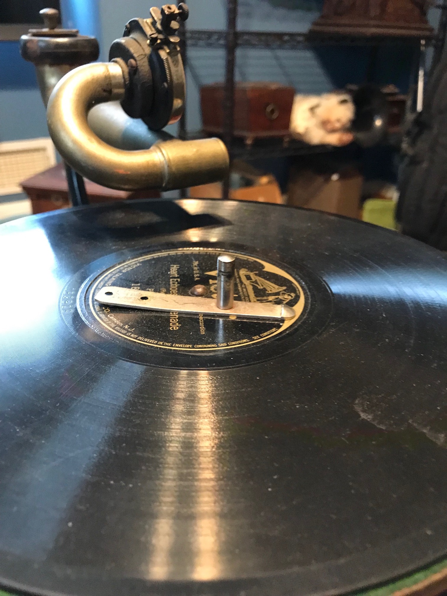

And some pictures . . . What you see is what I got. The reproducer is desperately in need of repair, but it works. It takes a round needle. I took my horn and elbow off an original Victor Monarch Special and it fit perfectly well. So a Victor III horn elbow would also work. Runs very smoothly. It has an early motor, not the type with a round bedplate one finds on Monarchs and Type E's, but an early one nonetheless. I date the machine to ca. 1910. The serial number is 22412, the same as on the paper label on the bottom, which is intact. Motor takes a slotted crank.
The reason the platter does not lie flat is because I didn't seat it properly. It's fine.
As you can see the front button and latch is missing. I've posted a request for that part elsewhere on the Forum. I took one off my Victor Monarch and took a photo of that. It fits to a Tee.
John
