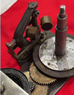

Does anyone have a parts list, particularily of the motor, that they could post please?
I think that I am missing that fits under the spring to keep it away from the fibre gear as it unwinds.

Can you post a picture showing the area of concern?

NO, Jerry meant a photo of YOUR motor and concern...

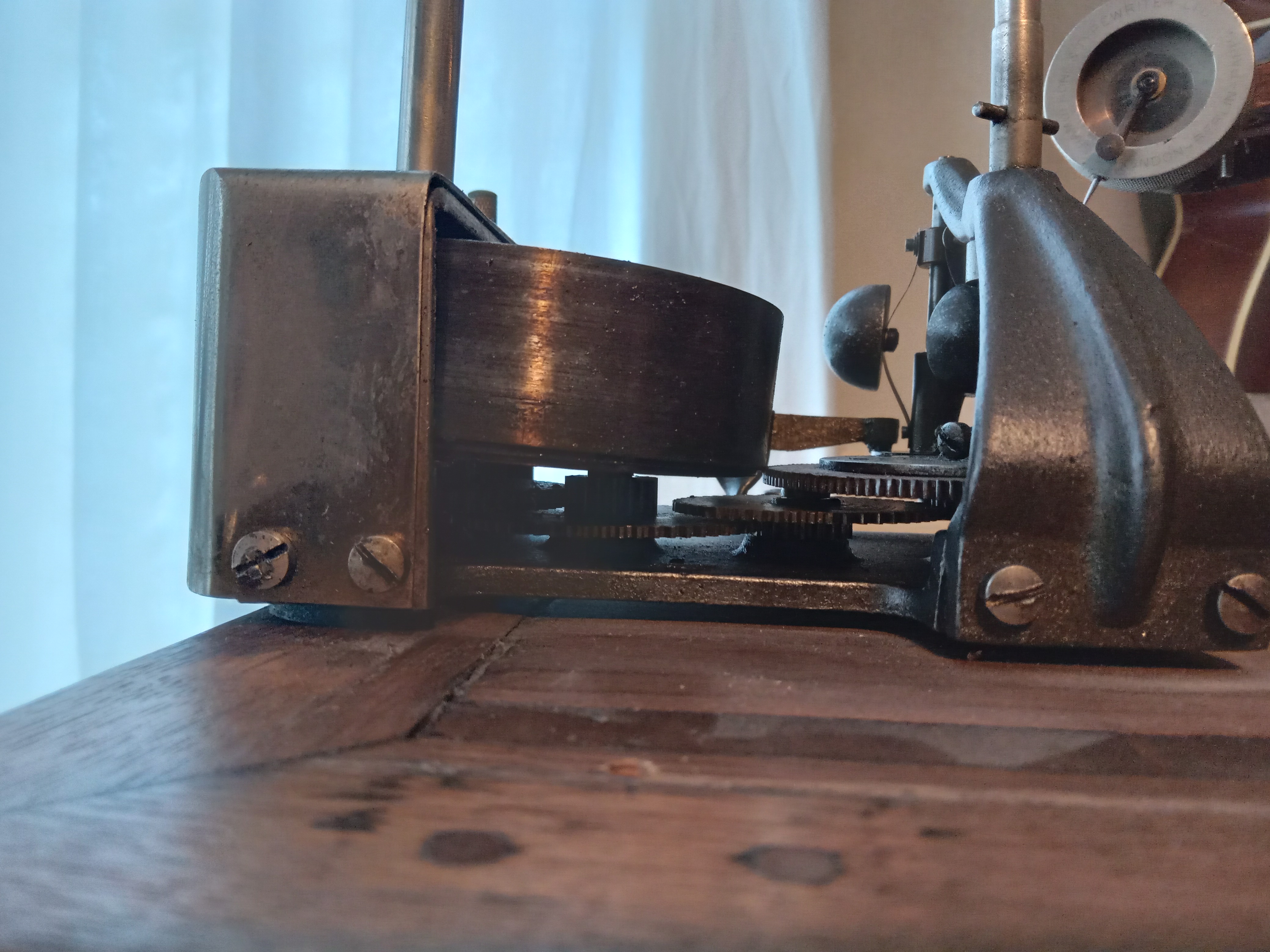

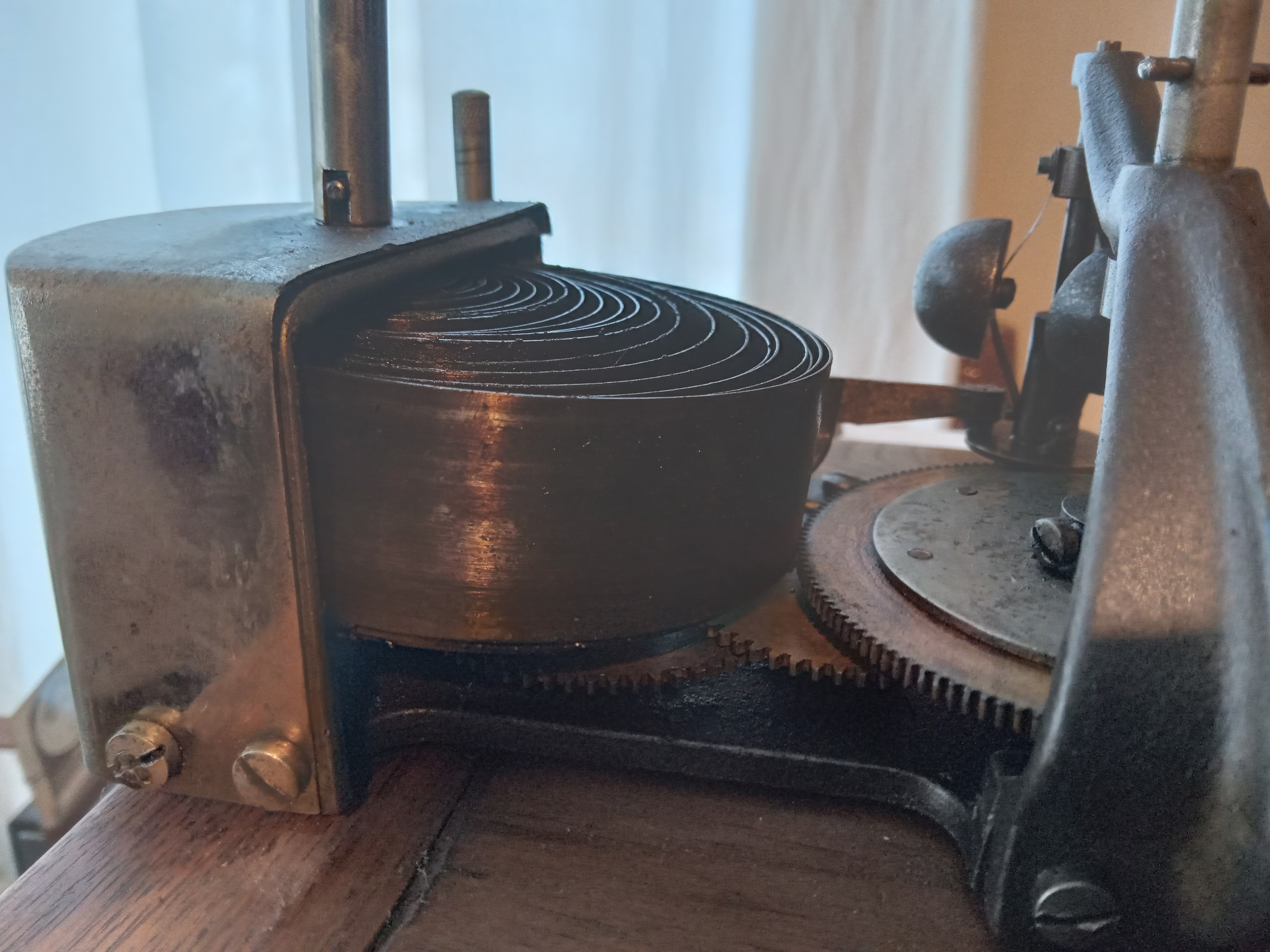

Here are a couple of pictures to demomstrate my problem.
As you can see, as tthe spring unwinds it drops toward the delicate and expensive fibre gear.

Your motor looks similar to a Trademark Berliner motor. There is no "cover" to protect the fibre gear, BUT the spring doesn't come into contact with the gear...

Examining the photos I would suggest that 1) the spring is misplaced, and the vertical axis of the first gear seems trapped between the coils; shouldn't the sitting coils be at the side of that shaft? 2) is the spring the correct size?

I do not know what the dimensions of the original spring are. Perhaps mine is an incorrect replacement although it does have quite an age.
It only gets near the gear when in the last stages of unwinding.
