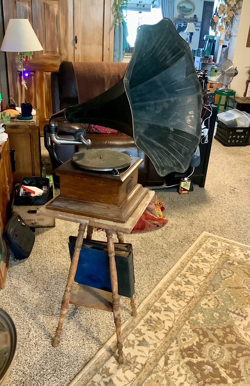

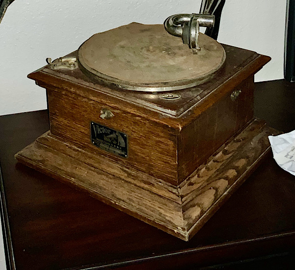

Here is the player as it is now, sitting on an old table that belonged to my Grandma. The table will be completely disassembled and refinished as will the player.
The reproducer, an Exhibition model, has what appears to be a mounting flange on it. It is of course different from mine.

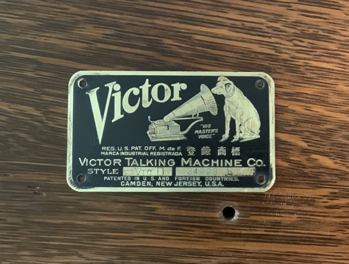

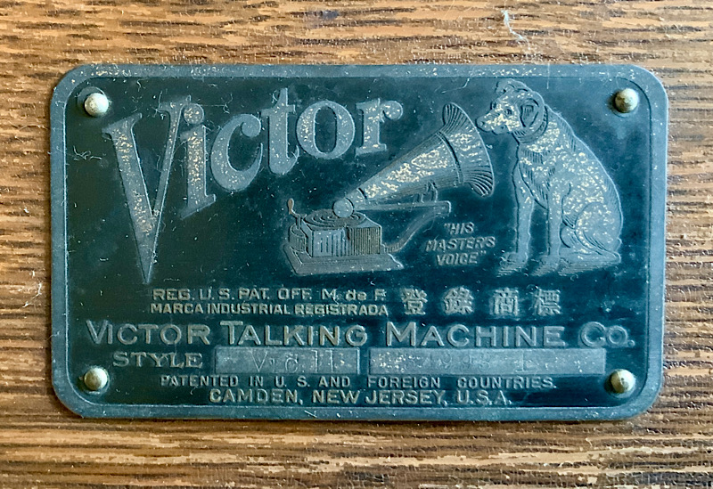

Is the data plate brass? It is very difficult to read and I would like to clean it up some.
You can see that the serial number is just about impossible to read. And, in both pics, the flaking of the finish is pretty bad. I’m hoping the Howard’s stuff is similar to the old Formby’s furniture refinisher and turns out well.

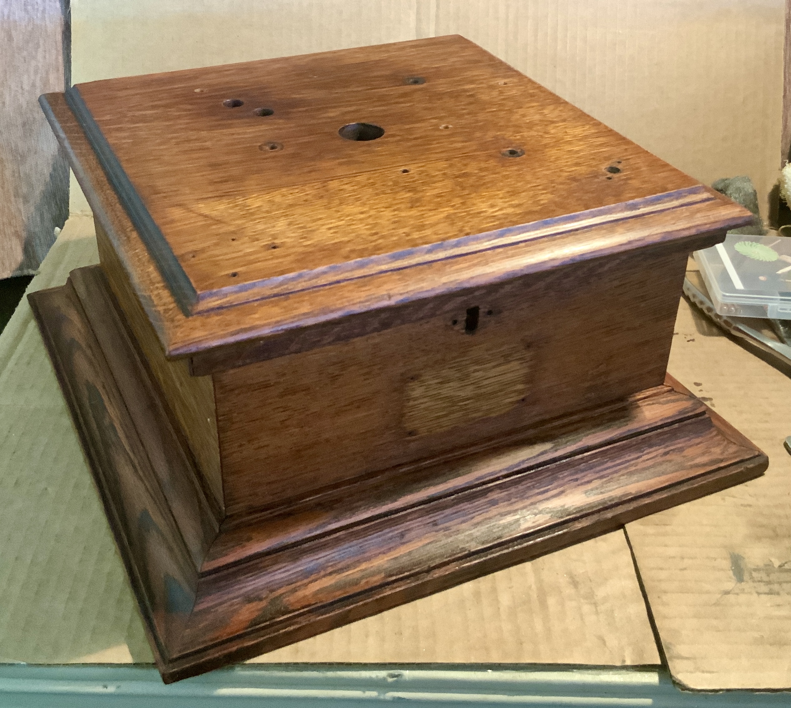

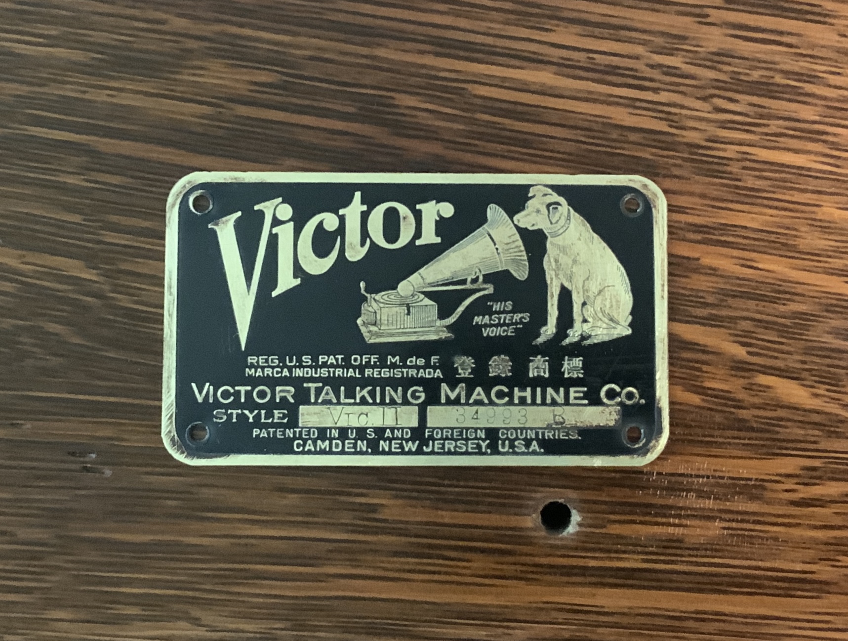

I am making progress. Slowly…
The cabinet is ready for a coat of paste wax and then I can reinstall the motor and all the hardware. I did get a beautiful rebuilt reproducer. And, I intend to rebuild the original one, the parts are here. The table it will sit on is rebuilt now. It had to be completely disassembled and is being refinished. It was in quite sad shape. The table is glued up and waiting for finish.
Also, I managed to clean the data plate without completely ruining it. I’m happy with the result and amazed by the detail in it.
The old finish (shellac?) was so crazed and damaged I ended up hand scraping most of the cabinet. Then the Howards refinisher made it look nice. A rubdown with Feed-N-Wax produced what you see now. Paste wax goes on tomorrow.
