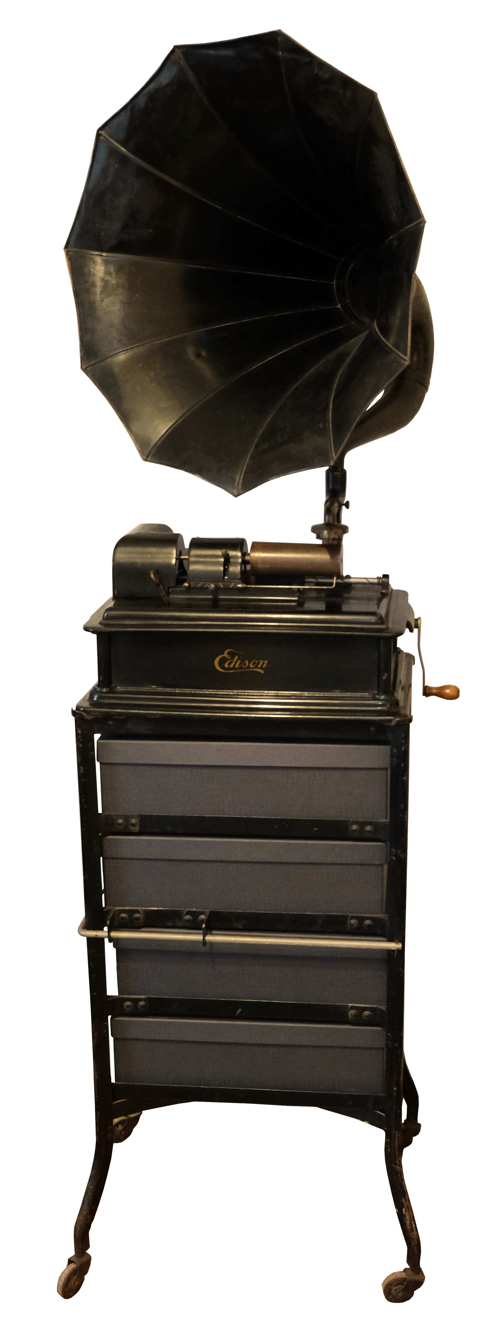

The Edison School never had a lid. However, it always sat on a stand because when sitting on a table, the crank extends below the base. It cannot be cranked sitting on a table. The stand held cardboard boxes that would hold cylinders. It also had a pullout tray to hold one of the cardboard boxes.
The horn has been seen in both 10 and 11 panels versions. The ones that I saw had the holes from the hanger factory plugged, and a standard Cygnet decal that went over the plugged holes on the outside. I've heard of other variations (possibly without holes).

Ken, it's called the Edison "School", never the Schoolhouse. George Frow's book, the Edison Cylinder Companion, confirms what Shawn said about the stand, with pullout metal bracket for holding a box of cylinders, and also that it had either 11 or 10 panel horns. Specifically the book says that they started out with the 11 panel, and when the 10 panel was released, Edison started supplying it with the School. By the way, I have a School with a repro stand. Mine has an 11 panel horn, but Rene Rondeau told me that its former owner (Dave Heitz) at one time had a 10 panel horn on it. Rene made a list of all known Schools, so he recognized mine by its serial number.
