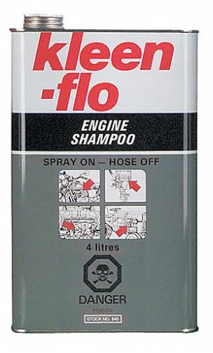

JeffR1
- Posts: 572
Re: Best way to clean motors?
I like this product, it's basically a water soluble type solvent, (paint thinner/varisol).
- Attachments
- Kleen Flo.JPG (30.72 KiB) Viewed 7446 times
