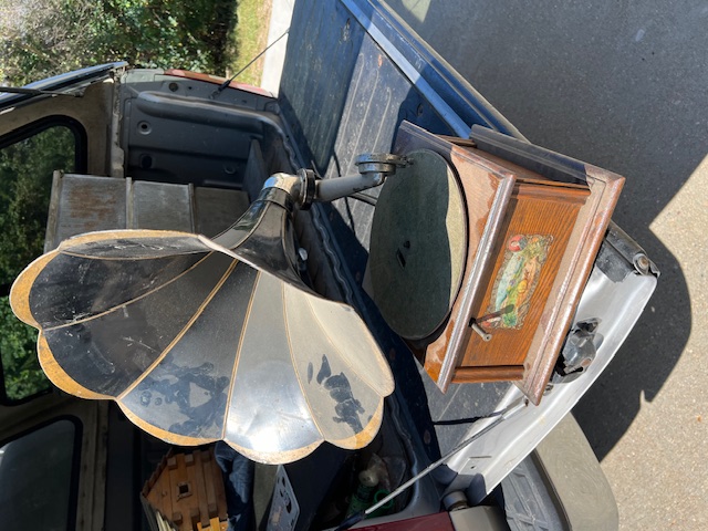

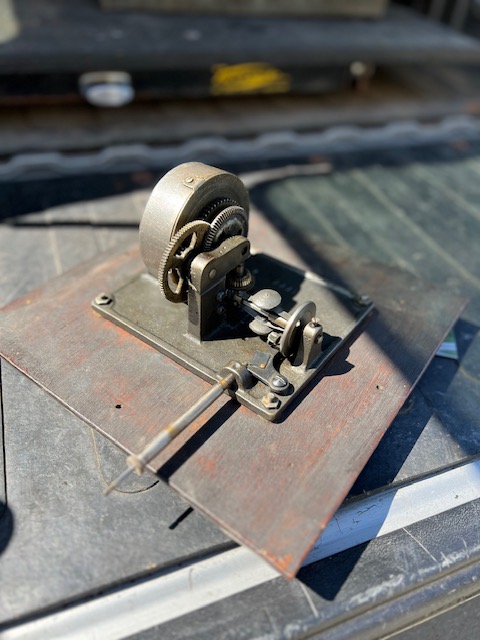

I am trying to bring a Yankee Prince phonograph back to life. It need the brass gear that drives the governor. Does anyone have a motor like this available?
Thanks, Ken Brekke

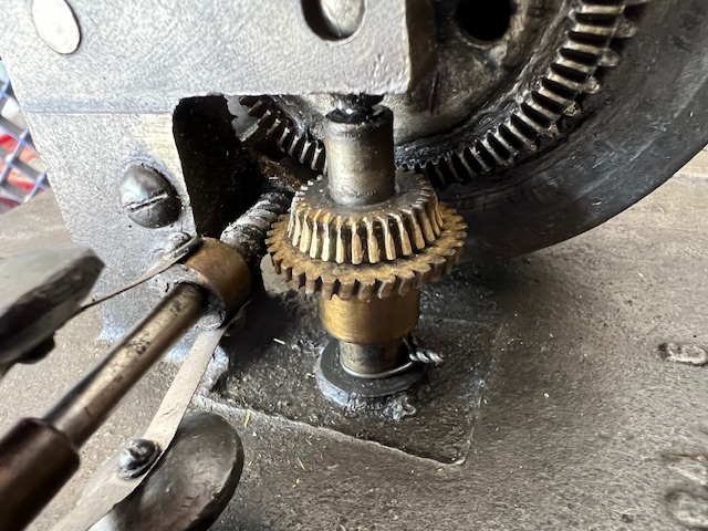

The brass bevel gear? Or, the worm wheel that meshes with the governor shaft? They would be the same as in any Columbia motor of that type.

Thanks for the reply. I will have to look again tomorrow. I believe it is the beveled gear.

It looks like the fiber gear is alright. Just the beveled brass gear is shot.

The Phonograph Shop stocks a reproduction beveled brass gear for Columbia / Columbia client motors.
