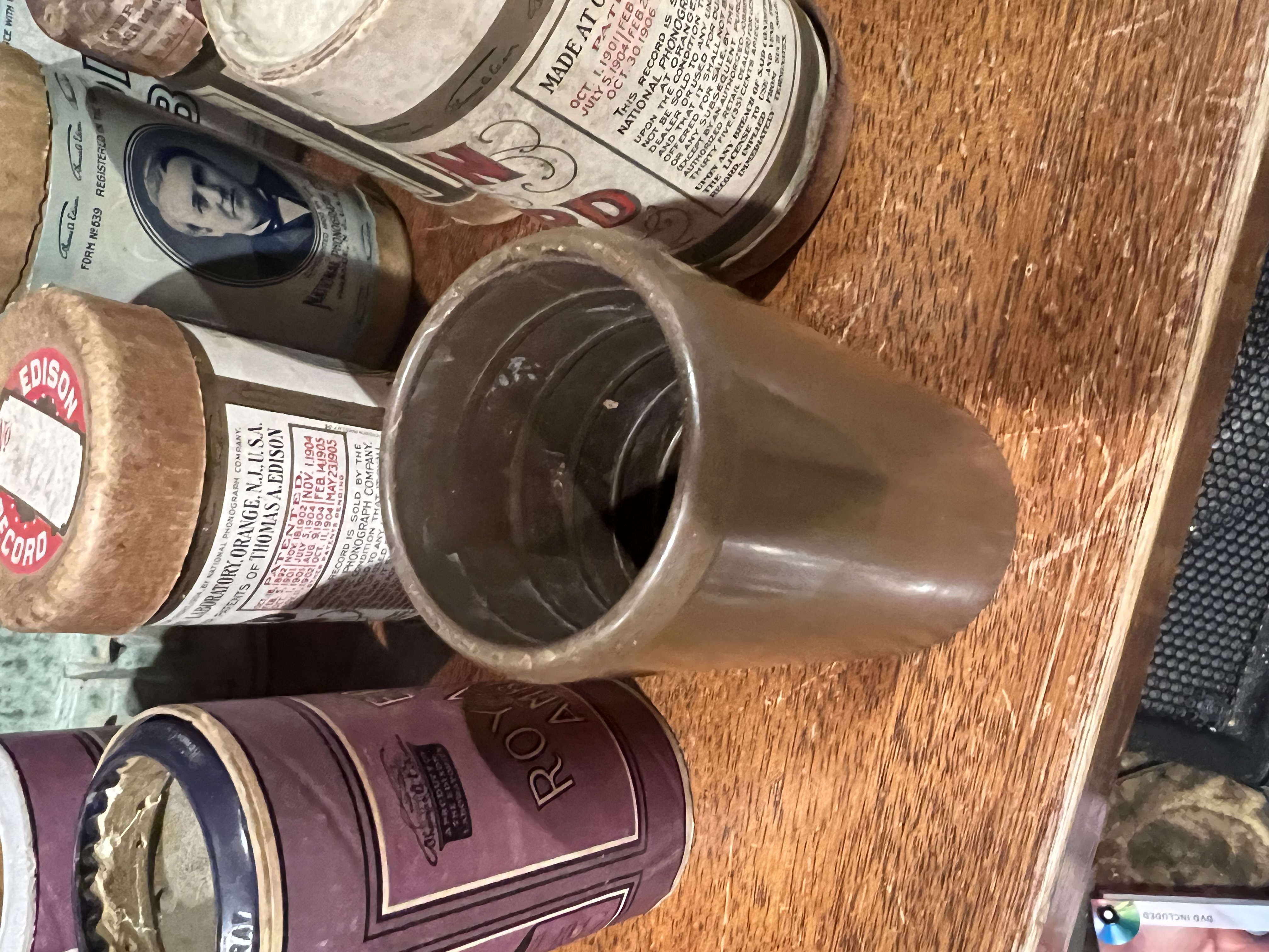

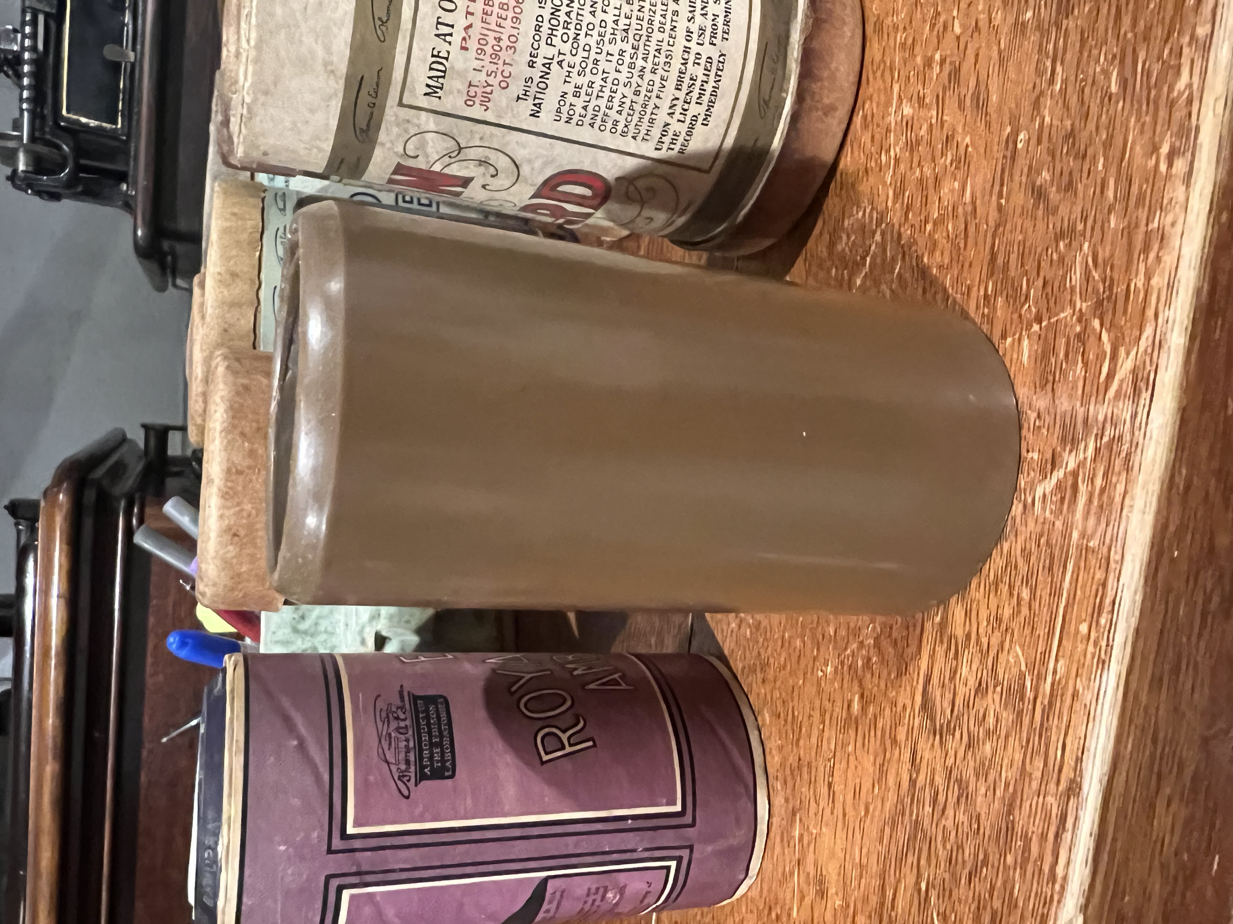

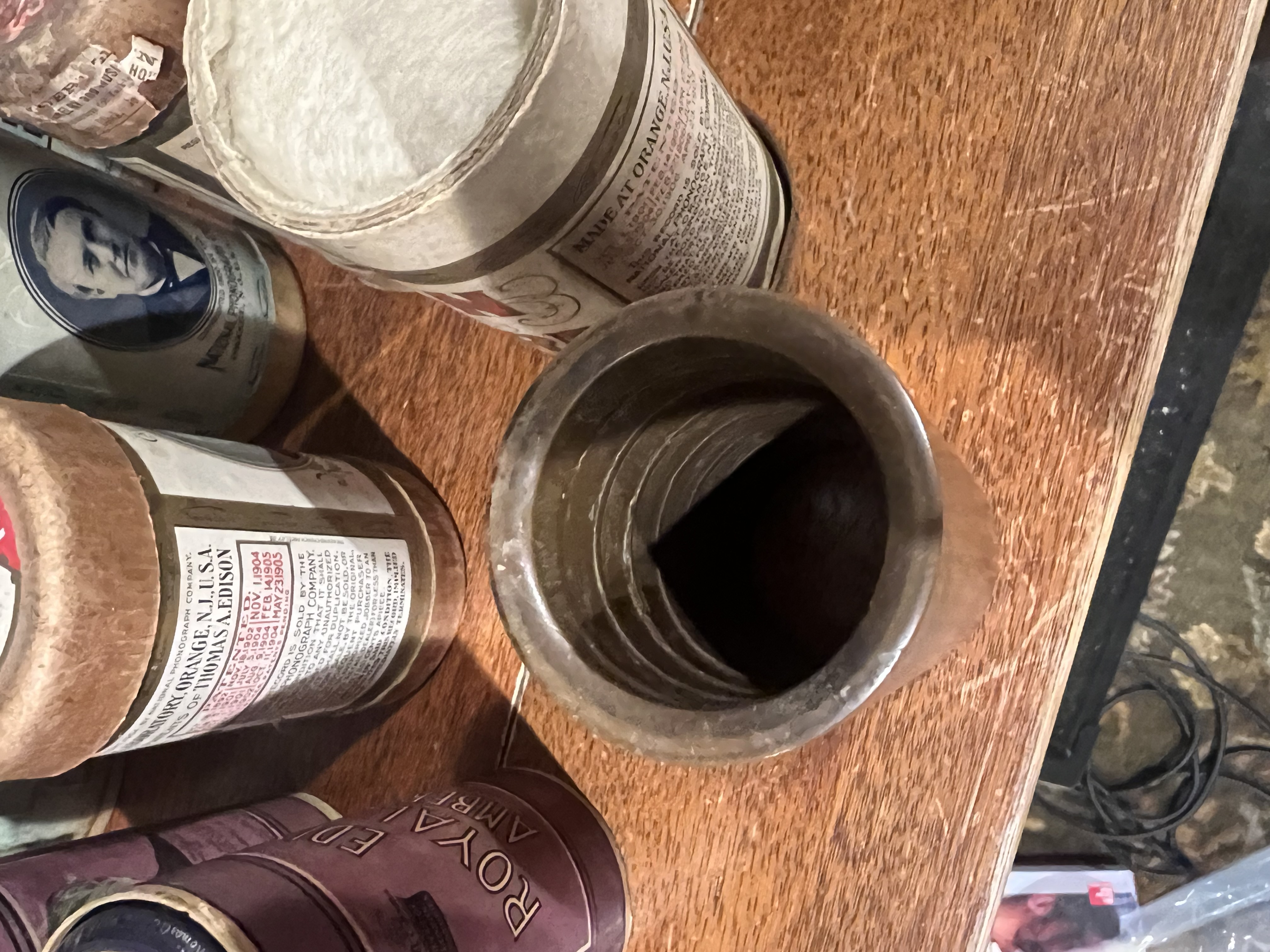

I don’t think it’s a home recording but I could be wrong. The song is “Tramp Tramp Tramp” which I believe is from the civil war. Attached are some photos. It’s a very quiet recording. I only paid 20$ for it. All the informstion is provided is very valuable and appreciated!

Is there any announcement on it? If so, what does it say (if you can make it out)?KCW wrote: Thu Sep 12, 2024 2:01 pm I don’t think it’s a home recording but I could be wrong. The song is “Tramp Tramp Tramp” which I believe is from the civil war. Attached are some photos. It’s a very quiet recording. I only paid 20$ for it. All the informstion is provided is very valuable and appreciated!IMG_4812.jpegIMG_4811.jpegIMG_4810.jpeg
Recording companies in the 1890s often announced the brand (Columbia, Edison, etc.) to protect their product. No announcement, or one without a brand, might be either a home recording, or perhaps a pirate, pantographed copy, with the announcement omitted to forestall legal action...
